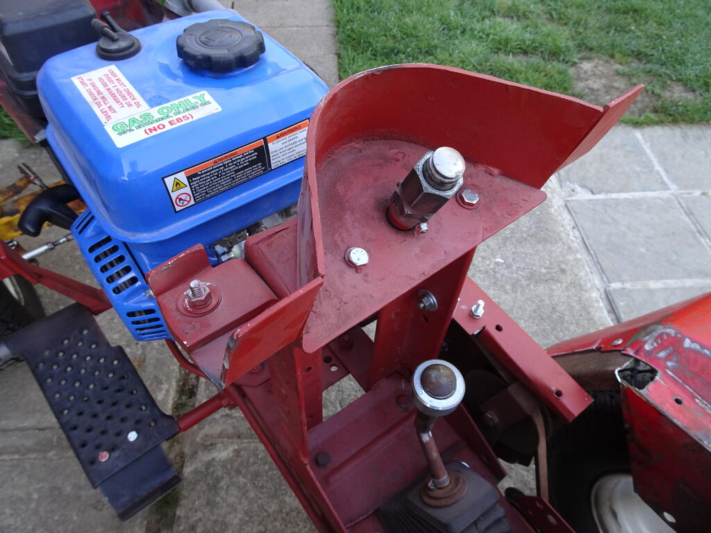

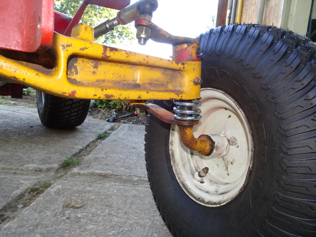

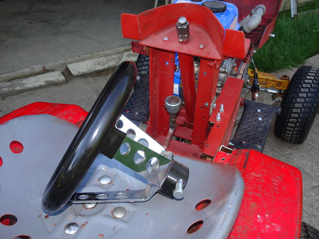

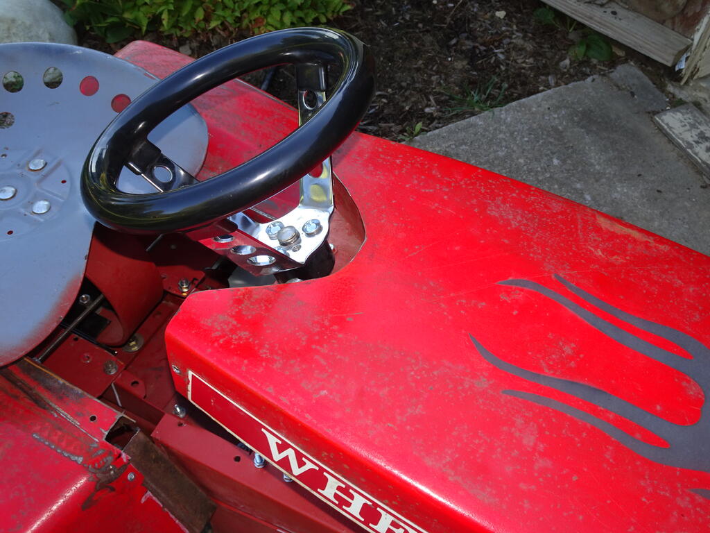

giddyap 1,574 #1 Posted August 20, 2020 Again I used a Ross Steering unit from a Cub on my second WH custom. Built for wheel stands, gripping the wheel could be a matter of life or death. The tower and steering components had to be capable of holding a man as if he were hanging over a cliff. Since I don't weld I bolted on a section of frame for the tower that had the transmission plate. I had to cut down the steering column so I could use a deep quick release steering wheel. A mule pulley housing mated the column to the tower as strong as if I had welded it all together. To soften the landings I cut to size porch swing springs to replace the sections of axle I cut off. A 4" pulley on the engine and 3" on the trans makes a perfect all around 2nd gear. Third bogs down and first is too slow for me. 8 6 2 4 Share this post Link to post Share on other sites

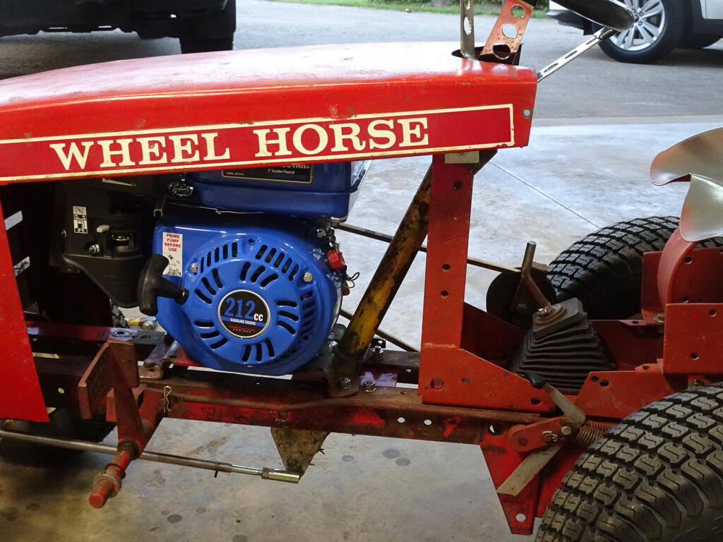

Redneckdavis 308 #3 Posted August 20, 2020 (edited) Well that's cool. Can you post some pics of the homegrown suspension? And what engine is that? Edited August 20, 2020 by Redneckdavis 1 1 Share this post Link to post Share on other sites
953 nut 70,064 #4 Posted August 20, 2020 51 minutes ago, giddyap said: To soften the landings I cut to size porch swing springs to replace the sections of axle I cut off I would love to see some detail of this. 2 Share this post Link to post Share on other sites

giddyap 1,574 #12 Posted August 20, 2020 3 hours ago, Redneckdavis said: Well that's cool. Can you post some pics of the homegrown suspension? And what engine is that? Pictures later, I can agree with Harbor Freight that a black Predator on their water pump would discourage sales. Used for any other application a Blue Predator often raises the question "what engine is that?" 1 Share this post Link to post Share on other sites

giddyap 1,574 #16 Posted August 21, 2020 16 hours ago, 953 nut said: I would love to see some detail of this. Nothing fancy, I just cut the springs somewhat close to the size I needed. The porch swing springs (2 per package for $10) are wider and thicker than need be thus restrict travel distance for a hard cushion. The compession spring size I wanted I could only find in piano wire and could not hold the weight. The right ones would create a soft landing 4 1 Share this post Link to post Share on other sites

giddyap 1,574 #18 Posted August 21, 2020 16 hours ago, bottjernat1 said: Do you have some photos of your modifications so folks can see? This is the mule pulley guard which I referred to as the pulley house 2 1 1 Share this post Link to post Share on other sites
giddyap 1,574 #19 Posted August 21, 2020 The tower is the section of frame with the transmission plate. Also the Cub steering column 1 1 1 Share this post Link to post Share on other sites

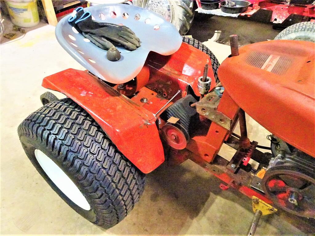

giddyap 1,574 #20 Posted August 21, 2020 (edited) I cut and folded the fender seat pan, later removed the middle for a wider look. The rusted piece on the tower is a partial transmission plate to mount the pulley guard on. The original 6" trans pulley is on the engine. I used a 4" pulley. Cubs use the yellow triangle plate to hang foot rest rods. I use them everwhere and cub foot rests Edited August 21, 2020 by giddyap additional info 1 1 1 Share this post Link to post Share on other sites
