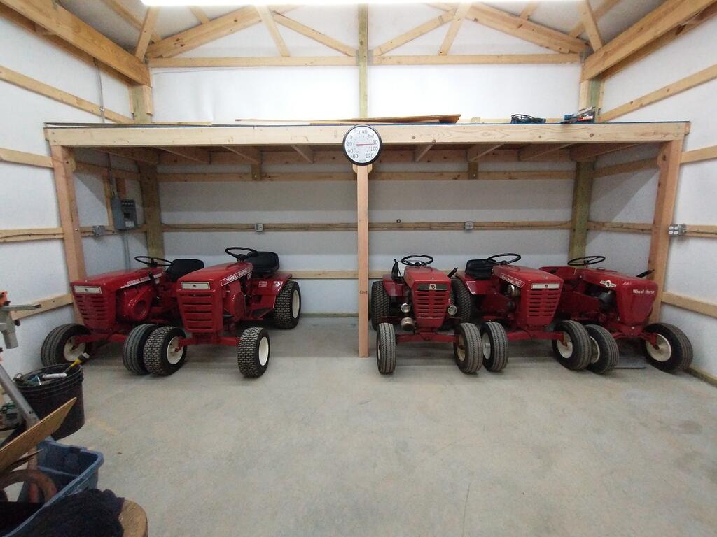

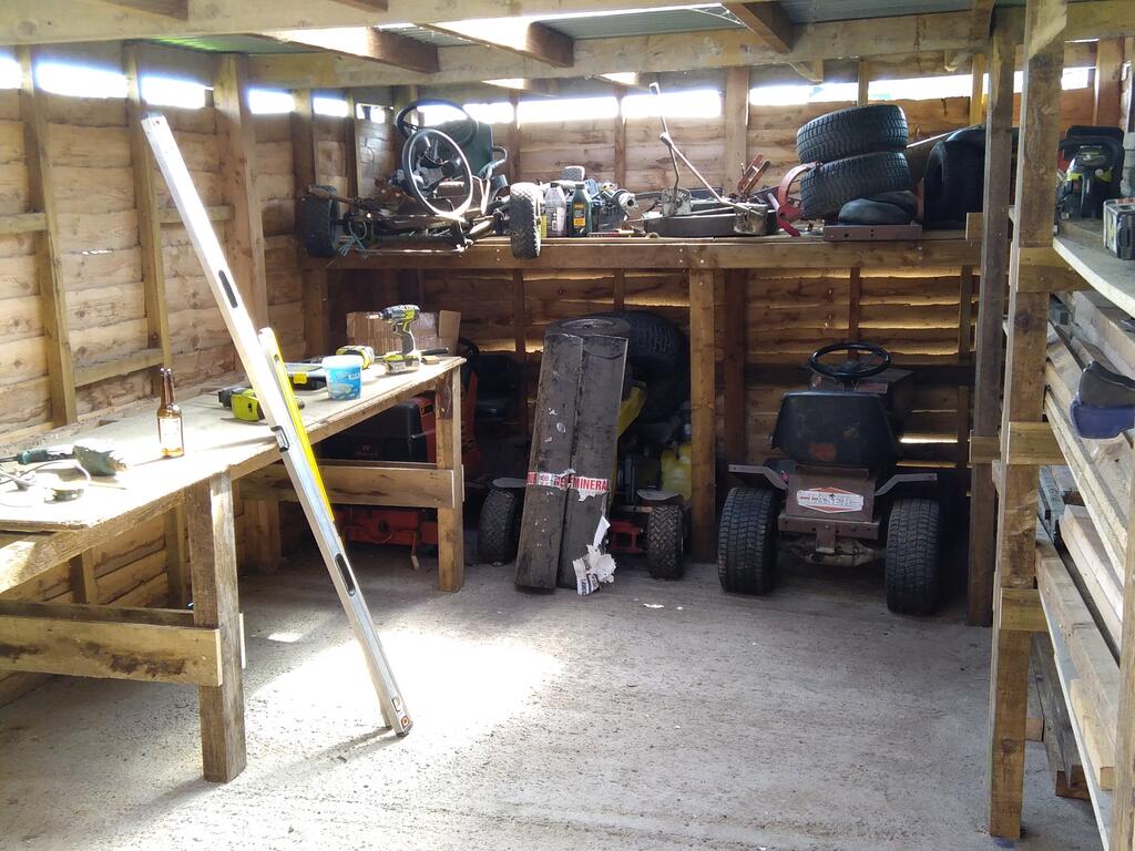

Dan.gerous 2,696 #4 Posted August 19, 2020 This is an old picture of my shed, the shelves above the mowers are a lower version of what you are talking about I think. That is about five foot high which is ok for getting under with the machinery and the dead space above is now full of parts. I also have the mower decks stacked under the bench two high. This shed was just a quick fix, it will be demolished in the not too distant future, but the shelves certainly helped get some space back. It's now full of wheelhorses, the other mowers have all been sold. 2 4 Share this post Link to post Share on other sites

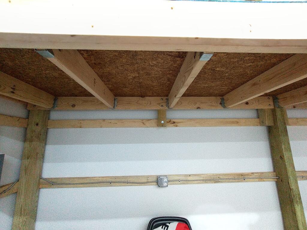

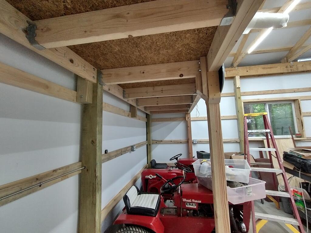

rmaynard 17,496 #9 Posted August 19, 2020 (edited) This is what I did with my 18 x 20 pole shed. Loft is 4 ft deep, 6' 3" head clearance, and constructed with 2" x 6" 2 ft on center. I have 39" storage on side walls about 7' in the center. Edited August 19, 2020 by rmaynard 4 1 Share this post Link to post Share on other sites

rmaynard 17,496 #11 Posted August 20, 2020 I'm not sure what you are asking, but mine has a double 2 x 6 header in the front, supported by a 4 x 4 in the center and on the ends. It is built like a deck with a 2 x 6 ledger board across the back, and 2 x 6 joists on 24" centers to support the floor which is 7/16" OSB. 1 Share this post Link to post Share on other sites
