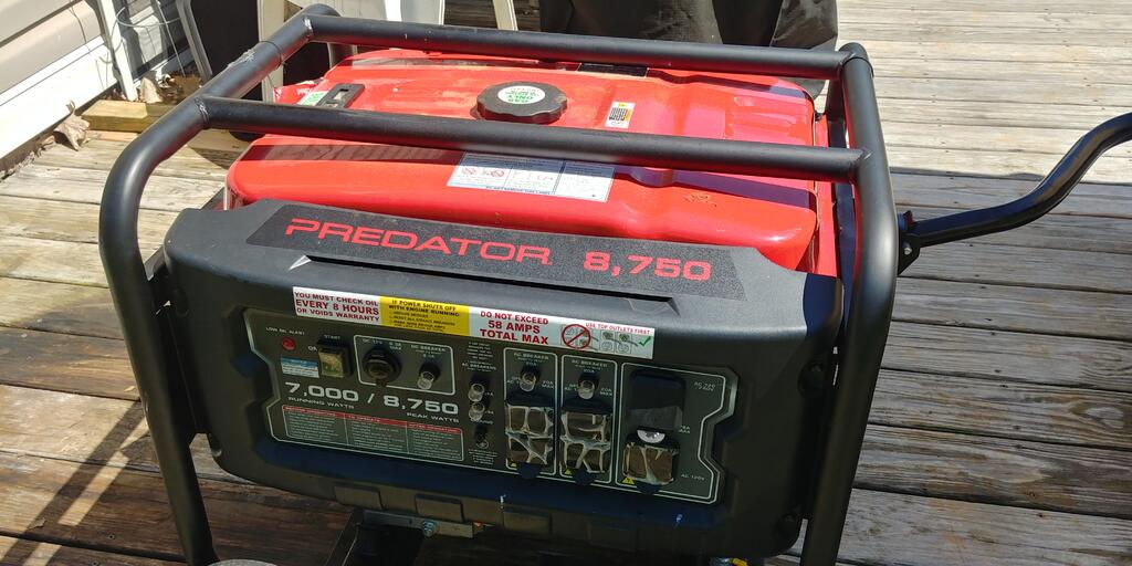

WVHillbilly520H 10,379 #31 Posted August 23, 2020 You all got me thinking I should at least fire mine up... First pull of the rope and away she goes been sitting since winter 20200823_122642.mp4 1 Share this post Link to post Share on other sites
