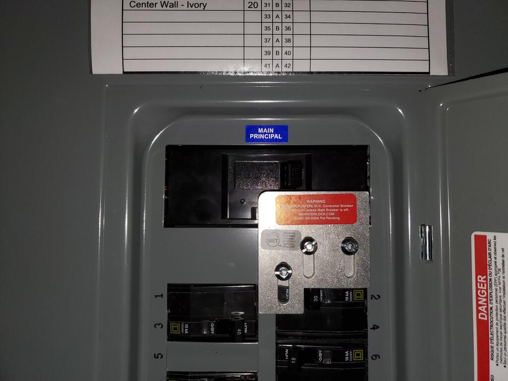

D_Mac 9,338 #3 Posted August 19, 2020 I had same issue, In fact I have 2 generators. They only get used for power outages, that means they sit for yrs without getting pulled out from the rear of the garage to get started. They each have a brand new carb and run like a champ when last started. I even bought the transfer switch to hook up to the house that has never been installed. I know I am going to regret it someday. 4 1 Share this post Link to post Share on other sites

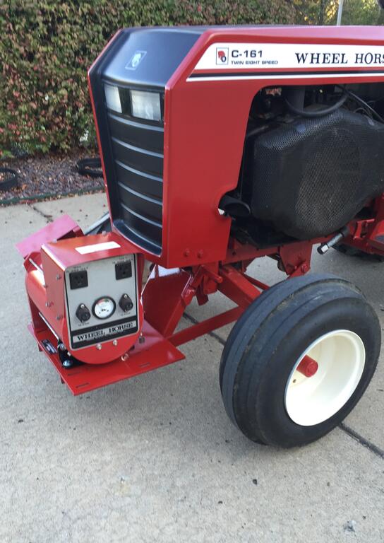

cschannuth 3,821 #11 Posted August 19, 2020 I always wanted a generator but always worried that I wouldn’t exercise it enough to have it run when I actually needed. When I found a good used generator for my wheel horse I jumped at it because it fits on almost all of my tractors, is very easy to install because I keep it on a cheap four wheel dolly that positions it perfectly underneath my tractors, and I always have at least one tractor that will start so I always have a generator when I need it. It’s not very big but I have my house wired so that I can use it to power enough critical circuits to keep food from spoiling, heat, and a few lights in the house. 13 1 1 Share this post Link to post Share on other sites

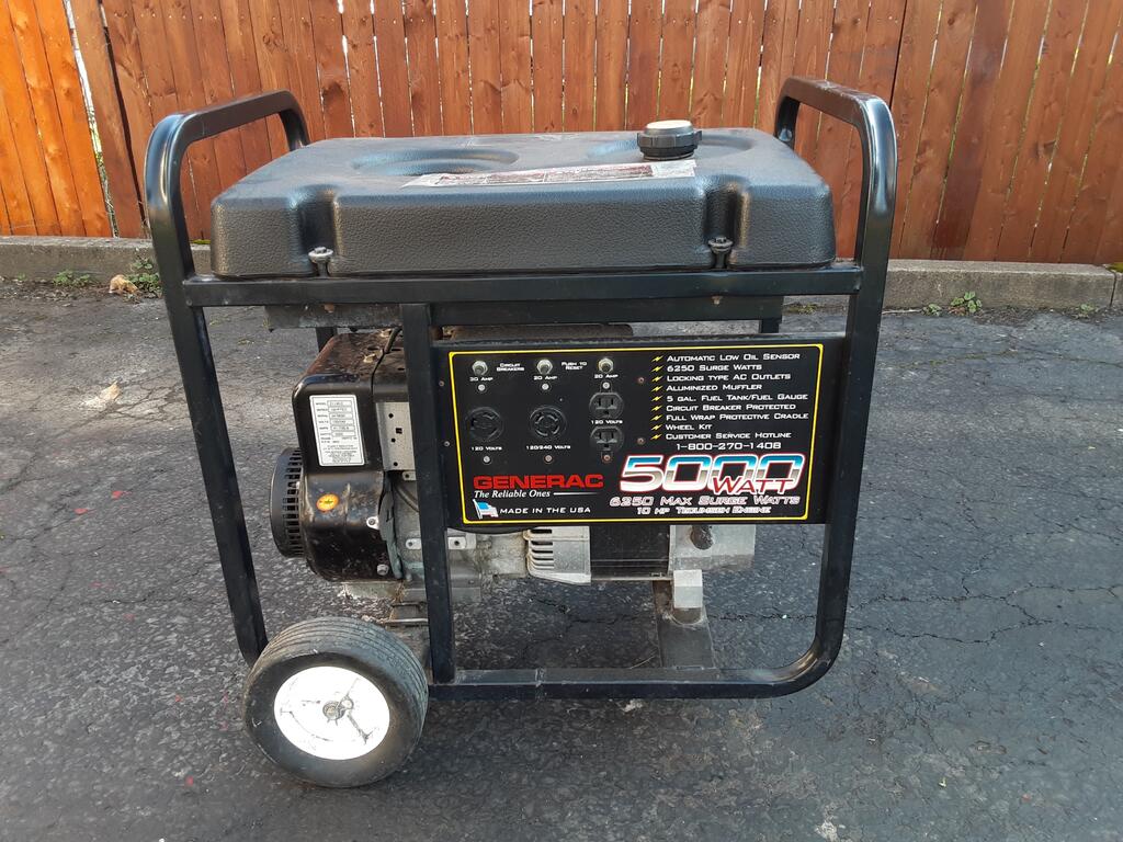

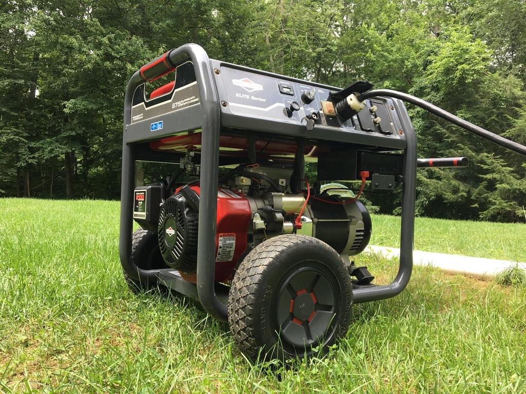

pfrederi 21,007 #15 Posted August 19, 2020 I have a portable Generac 5000 watt lust like picture above. Came from my now passed in-laws in Florida 20 years ago. Gets used 1 or 2 times every couple years. Rigged a drain hose on the fuel tank so after a run drain the tank run it till the carb bowl is empty.. Always starts on 2nd or third pull. For the more frequent 2-4 hour outages i have a deep cycle battery and inverter that runs the fridge a light and the TV 2 Share this post Link to post Share on other sites

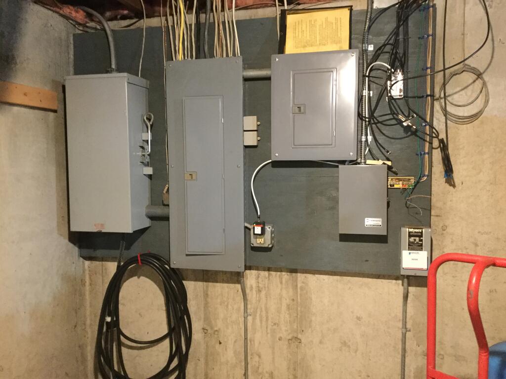

CCW 1,516 #18 Posted August 19, 2020 Have had this transfer switch in my basement for the past six years. Though we did not lose power in the storm two weeks ago I decided it was time to install it. The last time we lost power it was for nine days. Now no more extension cords running throughout the house. Over the past 30 years I have had to use the generator three or four times. 1 Share this post Link to post Share on other sites

ZXT 2,402 #21 Posted August 20, 2020 7 hours ago, CCW said: Have had this transfer switch in my basement for the past six years. Though we did not lose power in the storm two weeks ago I decided it was time to install it. The last time we lost power it was for nine days. Now no more extension cords running throughout the house. Over the past 30 years I have had to use the generator three or four times. Do you have any kind of a transfer switch or do you just have it tied into your panel? If not I'm curious what keeps it from backfeeding past your panel other than maybe a main breaker that you have turned off. 11 hours ago, clueless said: the last thing you want is to be plugging electrical cords into a running generator while your standing on a wet surface in your worn out pair of crocs On top of this, I still see people from time to time selling "suicide cords" online to use with generators.. Good way to electrocute yourself and possibly a linesman trying to get your power back on! Share this post Link to post Share on other sites
Sparky-(Admin) 26,195 #22 Posted August 20, 2020 3 minutes ago, ZXT said: Do you have any kind of a transfer switch or do you just have it tied into your panel? If not I'm curious what keeps it from backfeeding past your panel other than maybe a main breaker that you have turned off. On top of this, I still see people from time to time selling "suicide cords" online to use with generators.. Good way to electrocute yourself and possibly a linesman trying to get your power back on! Those 6 switches are individual transfer switches. Once each one is switched from line to gen that particular circuit becomes fed from the generator and is isolated from street power. Very safe and totally legal 5 Share this post Link to post Share on other sites
ZXT 2,402 #23 Posted August 20, 2020 Just now, Sparky said: Those 6 switches are individual transfer switches. Once each one is switched from line to gen that particular circuit becomes fed from the generator and is isolated from street power. Very safe and totally legal Thanks Mike! Couldn't read the labeling on my tiny laptop screen. Pulled it up on the TV and can read it now. I've only installed whole home generators and transfer switches. Never dealt with one of the smaller panels. We don't have power outages here often (maybe once or twice for an hour during my life) but something like this might be nice to install and have just in case! 1 Share this post Link to post Share on other sites
