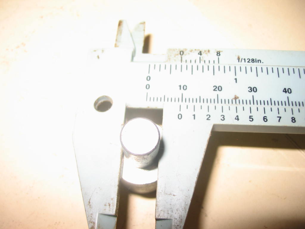

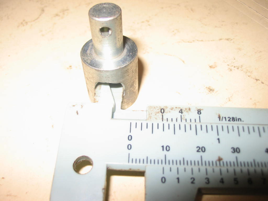

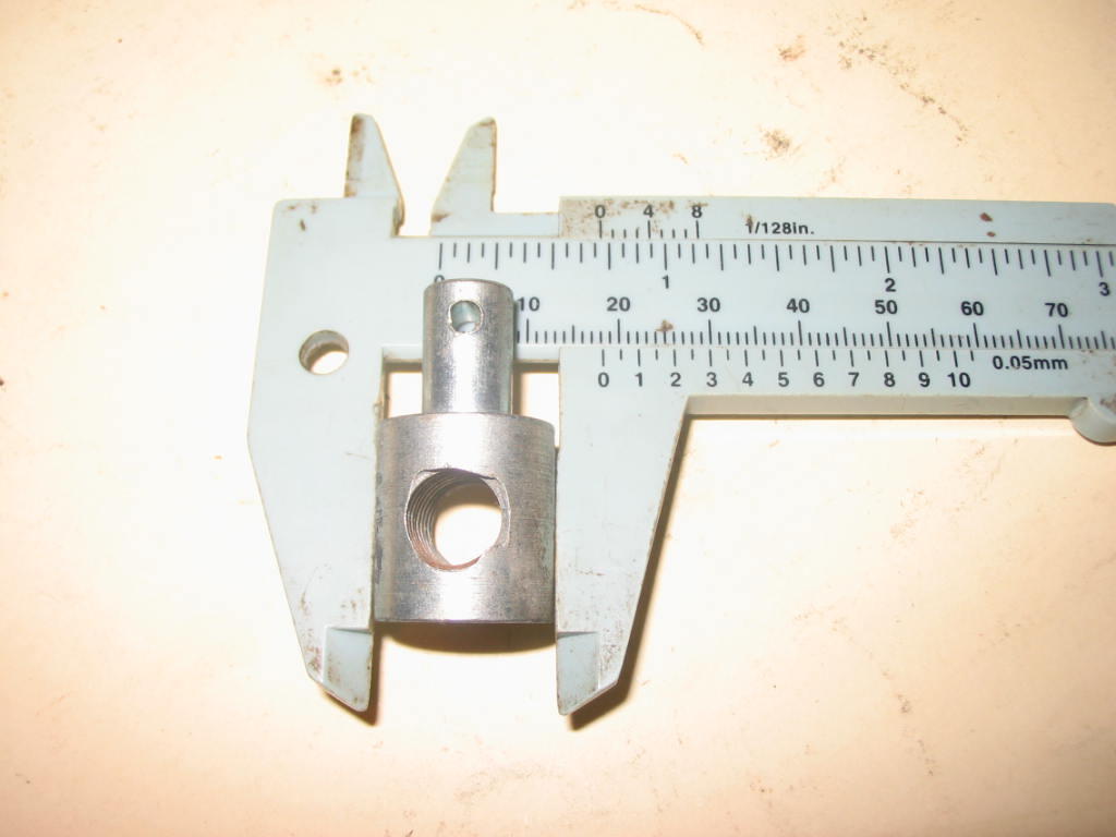

daveoman1966
I have 3 of these..new.  Part 103431.  Looks like it can be drilled out to 1/2. It now has a 3/8 hole---threaded.
$12...shipped...

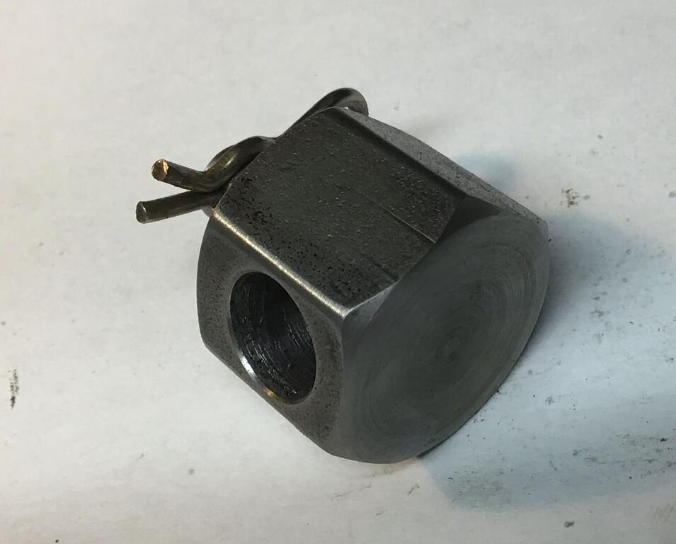

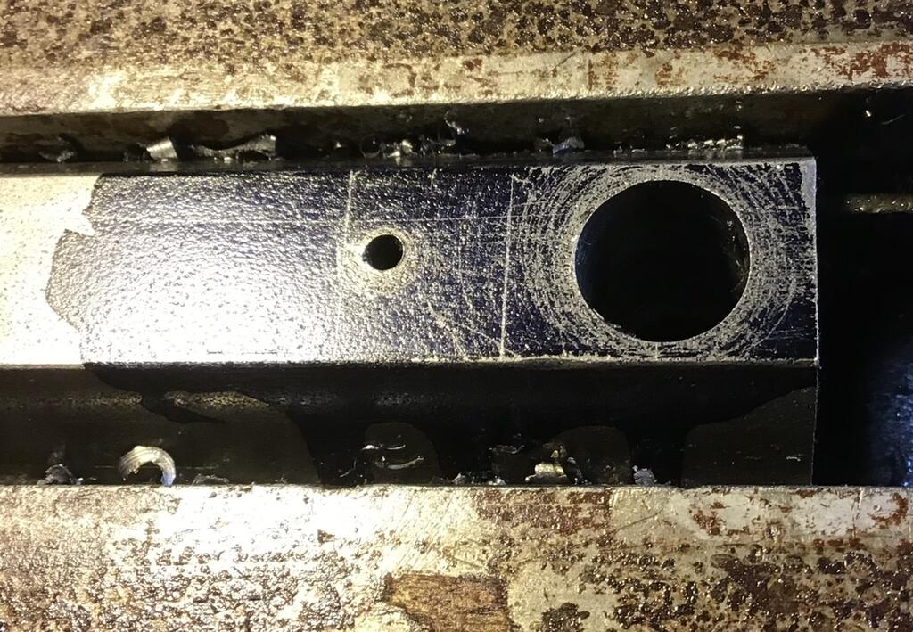

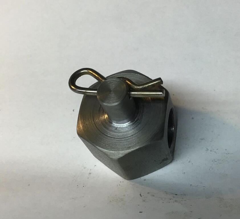

Lost Pup

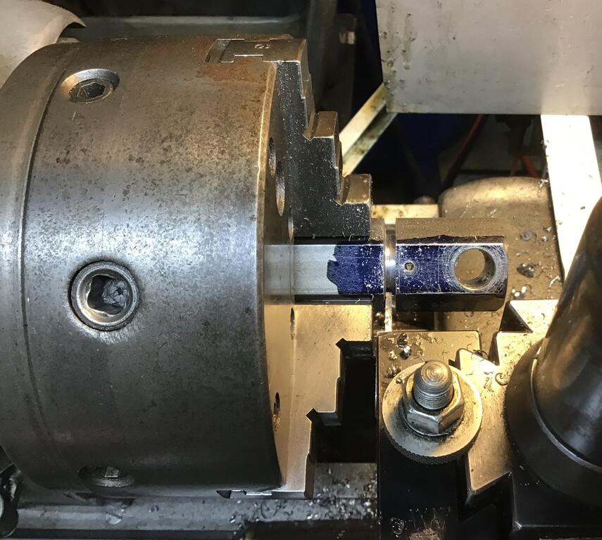

All I had was a short piece of 304 Stainless hex.
1 1/8 across width. I can turn it down round if you wish.
Marked our per your request. Holes drilled first on drill press.
South Bend 10k lathe , chucked and cut to length.
Faced and small diameter .375 turned. Edges And holes chamfered  And cleaned up.
Paul , I could not upload Pics  in the PM. Exclusive iPad user.
Comments Welcome.
Lost Pup
  • Excellent 1
  • Heart 1
Lost Pup
pfrederi gave me his approval so I will make up a second and mail it off to him.
The hex side was left alone to provide a flat bearing service for the nut.
  • Excellent 1
