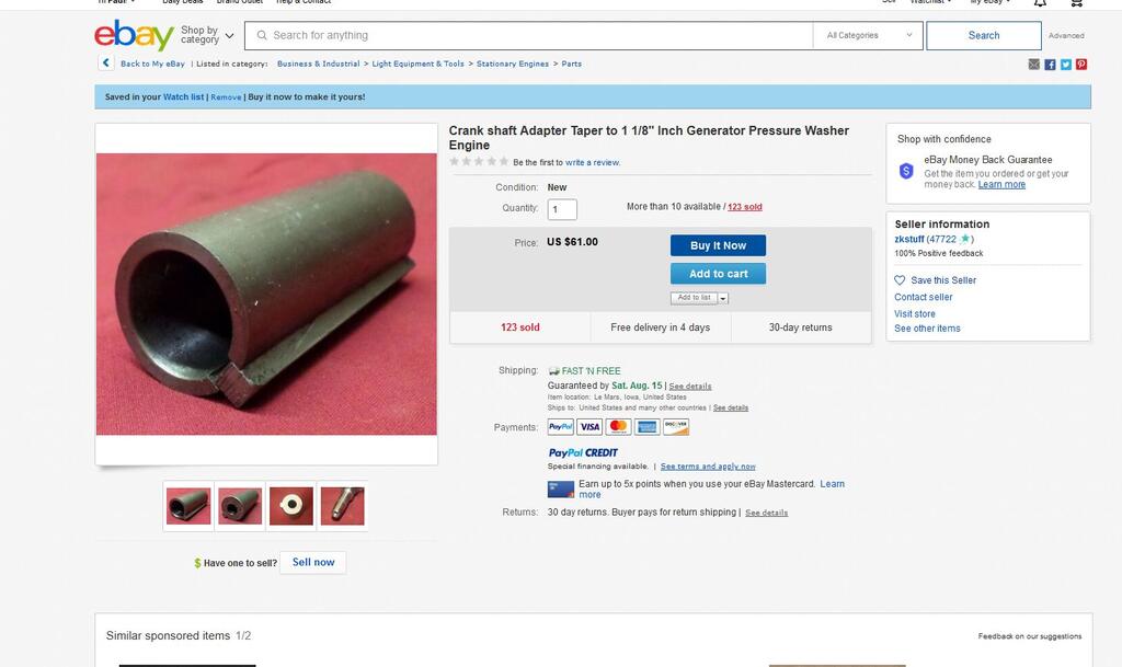

Dan.gerous 2,696 #48 Posted August 9, 2020 Another question... What are the options for using a tapered shaft engine? It's there a fitting to go over the taper or do you have to replace the crank? Just curious as lots of generator engines about, but they have the wrong shaft configuration. Found a Ruggerini MD150 twin cylinder that might be an interesting option except it came off a generator, also the rpm is 3000 which might be just a little low with the standard pulleys. 1 Share this post Link to post Share on other sites
ebinmaine 80,651 #49 Posted August 9, 2020 2 hours ago, Dan.gerous said: Another question... What are the options for using a tapered shaft engine? It's there a fitting to go over the taper or do you have to replace the crank? Just curious as lots of generator engines about, but they have the wrong shaft configuration. Found a Ruggerini MD150 twin cylinder that might be an interesting option except it came off a generator, also the rpm is 3000 which might be just a little low with the standard pulleys. There are taper adapters available. @Achto could help you out here. That rpm would be tolerable to me where we don't run implements. You could change a pulley slightly to compensate if needed. 1 Share this post Link to post Share on other sites
