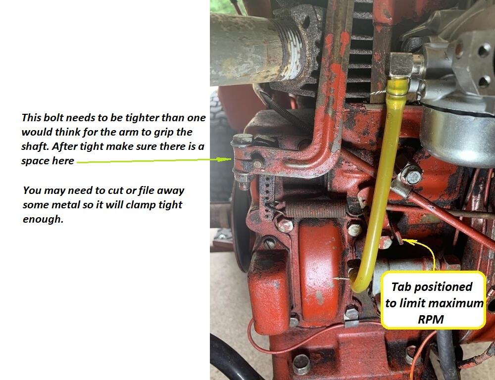

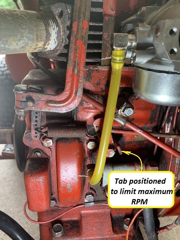

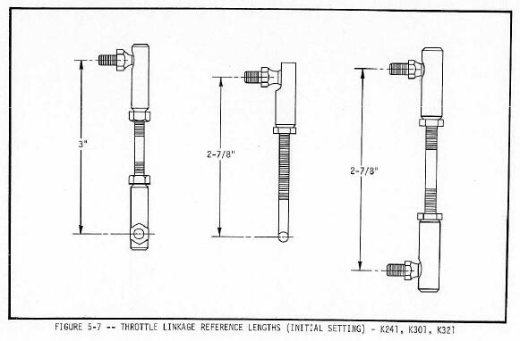

tallen4392 71 #11 Posted August 3, 2020 I bought this with carb parts missing so I put new carb on does this threaded linkage rod have to do with the governed is there a correct way to adj it Share this post Link to post Share on other sites

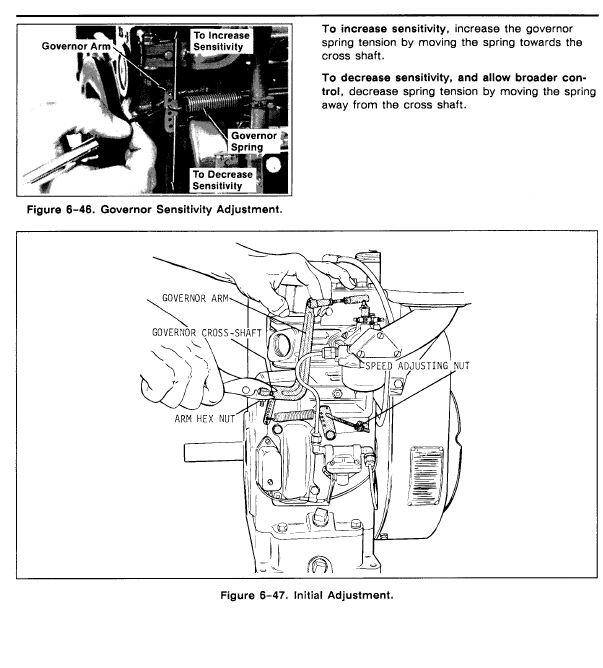

gwest_ca-(File Mod) 12,371 #12 Posted August 3, 2020 From an early Kohler service manual After it is installed the governor adjustment is required. Garry 2 1 Share this post Link to post Share on other sites
tallen4392 71 #13 Posted August 6, 2020 I still cannot get this right I must be missing something this thing will rev way to high the engine would blow if I open the throttle all the way don’t want to do that But on my c81 I can crack the throttle all the way no problem that is what I use the last 4 years to push snow throttle wide open I would like to use this auto charger 12 if I can get it to run right I might have to bring it to the small shop in town don’t really want to but I am scratching my head on this one any ideas Share this post Link to post Share on other sites
gwest_ca-(File Mod) 12,371 #14 Posted August 6, 2020 Take a close look and see if the governor arm clamp is stretched and not providing sufficient holding power. Garry 3 Share this post Link to post Share on other sites

tallen4392 71 #16 Posted August 6, 2020 Thanks for all the tips there is a great video on YouTube how to adj the governor on a k series Kohler it took about 5 min very simple when you can watch someone do it seems to work better Thanks again Share this post Link to post Share on other sites
