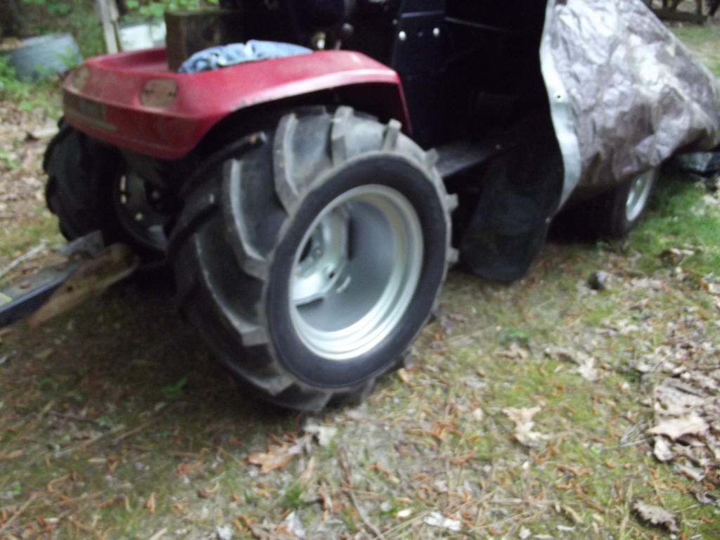

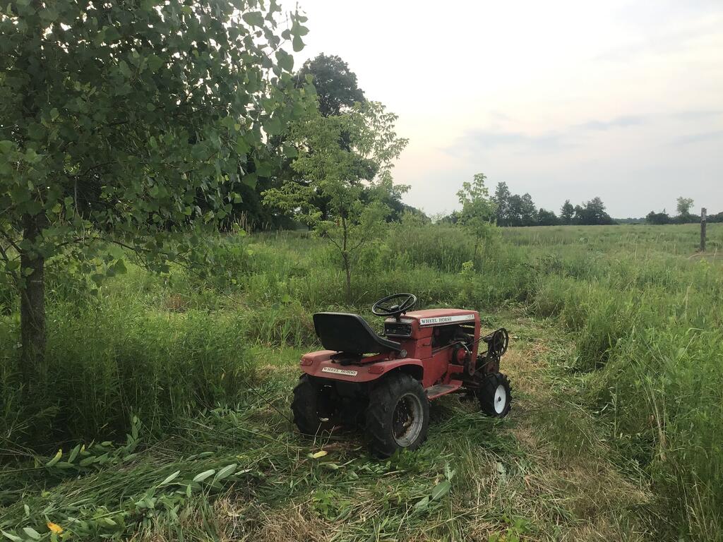

Lee1977 7,709 #2 Posted August 2, 2020 (edited) My tires on my 312-8 are 25 x 900 x 12 Alltrail II. I did raise the seat bracket, gas tank and fender 1 3/4". There was someone who put put 23 x 850 x 12 in the same tire on his tractor,but I don't remember who. Edited August 2, 2020 by Lee1977 4 Share this post Link to post Share on other sites
TonyToro 1,189 #3 Posted August 2, 2020 55 minutes ago, Lee1977 said: My tires on my 312-8 are 25 x 900 x 12 Alltrail II. I did raise the seat bracket, gas tank and fender 1 3/4". There was someone who put put 23 x 850 x 12 in the same tire on his tractor,but I don't remember who. That looks great. The tires make it more trail capable. Looks limit raised you 2-3” center of the axle. Share this post Link to post Share on other sites
Lee1977 7,709 #4 Posted August 3, 2020 I also kept the long front spindles for the 6" rims and added 400 x 8 tri ribs. 1 2 Share this post Link to post Share on other sites

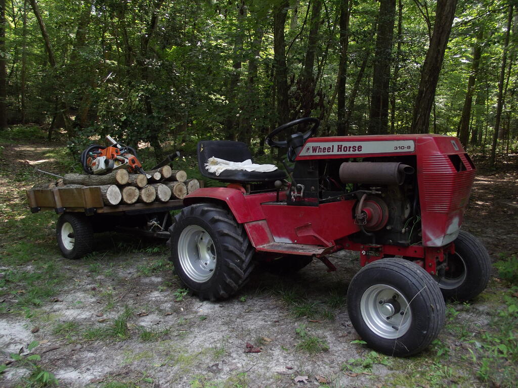

JAinVA 4,638 #5 Posted August 3, 2020 (edited) These are 10.5 Carlisle's on 8.00 rims.The second set are 8.5 Carlisle's on 7" rims. . Edited August 3, 2020 by JAinVA 5 Share this post Link to post Share on other sites
TonyToro 1,189 #6 Posted August 3, 2020 38 minutes ago, JAinVA said: These are 10.5 Carlisle's on 8.00 rims.The second set are 8.5 Carlisle's on 7" rims. . The bottom picture is 8.5”? If I read it right...those look good. I wasn’t sure if they would look to narrow on the tractor. 1 Share this post Link to post Share on other sites
JAinVA 4,638 #7 Posted August 3, 2020 (edited) That is correct.The bottom picture is 8.5 on 7" rims.I really like them. Edited August 3, 2020 by JAinVA 1 Share this post Link to post Share on other sites
RandyLittrell 3,944 #8 Posted August 3, 2020 I have an 85 310-8 just like @JAinVA, 23x8.50-12 Carlyle's. I really like them too! Randy 2 Share this post Link to post Share on other sites
JAinVA 4,638 #9 Posted August 3, 2020 (edited) I am really have to get the right hood on my machines.The 310 hood is not correct.What you see is a 312-8.When I did the muffler test last year I had a 414 hood on my 416 tractor .My bad. Edited August 3, 2020 by JAinVA 1 Share this post Link to post Share on other sites

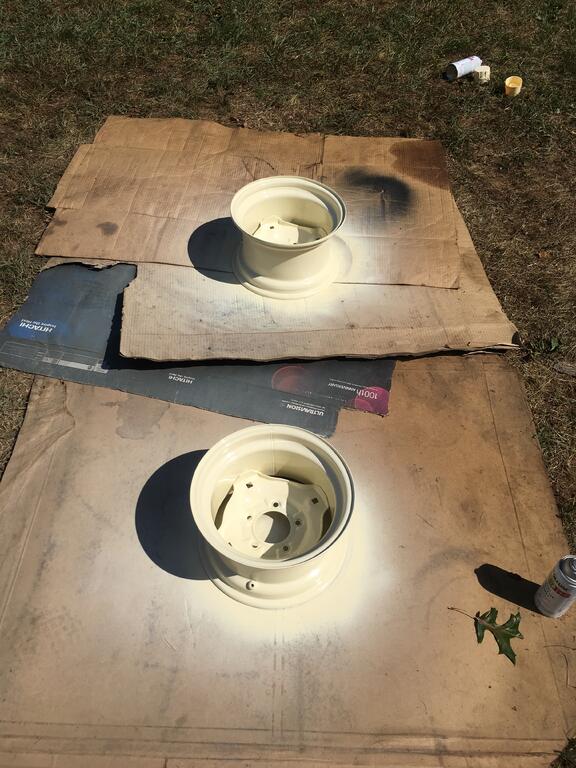

TonyToro 1,189 #16 Posted August 23, 2020 Update! It’s been slow going but got the rims painted today. Tires should go on tomorrow. Share this post Link to post Share on other sites
