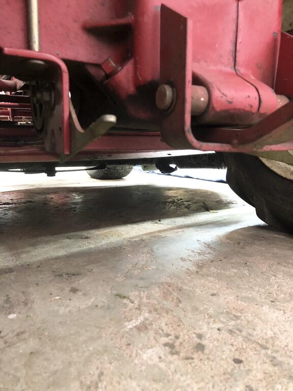

ArturHawk 195 #1 Posted July 31, 2020 Hello again! I just can't stop bugging y'all with my problems so here I am again. I got a second rear tach-a-matic so I could use multiple implements at once by switching seats, not attachments (one horse for each attachment, right?). It was a pain to get on because the two sides are connected by a bar. Once everything was ready and good to go, I went to put on my rototiller...and the tach-a-matic is too wide. It looks to be a wheel horse part. Did they make wider versions at some point? I can't decide if I want to cut the connecting bar off and use it without or sell it and buy a different unit. Thoughts? 1 Share this post Link to post Share on other sites

ArturHawk 195 #3 Posted July 31, 2020 Tires are 23x10.50-12. I took the bracket off and held it up to the tiller, two snow plows, and a snowblower and it was too wide for all of them... Share this post Link to post Share on other sites

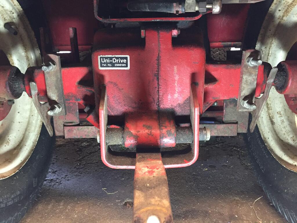

The Tuul Crib 7,354 #4 Posted July 31, 2020 The brackets you have does not look like the normal bracket. Perhaps it was fabricated by someone. Here's a picture of the one I have on my 414. 2 Share this post Link to post Share on other sites
gwest_ca-(File Mod) 12,511 #5 Posted July 31, 2020 Looks like an early version that mounts ahead of the rear axle. Dozer DNA of short tractor frame dozer blades 1961 model BD-4271 - Fits SHORT frame tractors - Mounts ahead of the rear axle - replaced by 1962 model BD-4262 - Fits SHORT frame tractors - Mounts ahead of the rear axle 1963 model BD-4263 - Fits SHORT frame tractors - Mounts ahead of the rear axle 1964 model BD-4264 - Fits SHORT frame tractors - Mounts ahead of the rear axle 1965-1966 model BD-4264A - Fits SHORT frame tractors - Mounts ahead of the rear axle 1967 model BD-4267 - Fits SHORT frame tractors - Mounts ahead of the rear axle 1968 model 6-2111 - Fits SHORT frame tractors - Mounts ahead of the rear axle ----------------------------------------------------------------------------------------------------------------------------------- 1968 model 6-4111 - First to fit LONG & SHORT frame tractors and first to mount under the rear axle Garry 1 Share this post Link to post Share on other sites
squonk 48,229 #6 Posted July 31, 2020 Yes you have the bracket to fit the older short frame plows and the like. I just went thru this on my 857. Read this. it mentions the brackets. 1 Share this post Link to post Share on other sites
ArturHawk 195 #7 Posted July 31, 2020 Well, now it all makes sense. I'd hate to destroy an item that has already survived over 50 years to work on my machine, so I guess i'll sell it and buy the right now. At least now I know what I'm looking for. I read the post that @squonk posted above...My second plow (that I haven't tried to mount) has the extension brackets on it like this one. What was the purpose of adding the extension? Will it cause problems when mounted to either a Raider 10 or C-120? Share this post Link to post Share on other sites
squonk 48,229 #8 Posted July 31, 2020 20 minutes ago, ArturHawk said: Well, now it all makes sense. I'd hate to destroy an item that has already survived over 50 years to work on my machine, so I guess i'll sell it and buy the right now. At least now I know what I'm looking for. I read the post that @squonk posted above...My second plow (that I haven't tried to mount) has the extension brackets on it like this one. What was the purpose of adding the extension? Will it cause problems when mounted to either a Raider 10 or C-120? That extension is for the 520 with swept axle. Take it off Share this post Link to post Share on other sites
