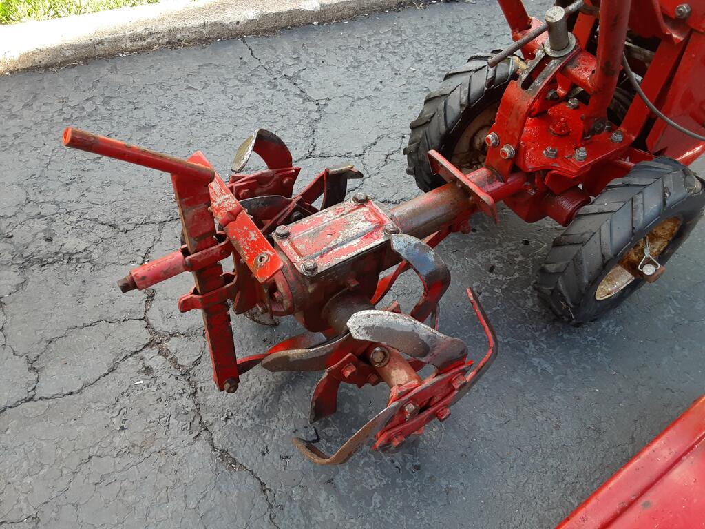

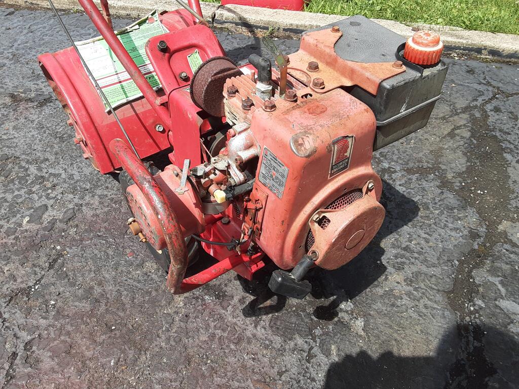

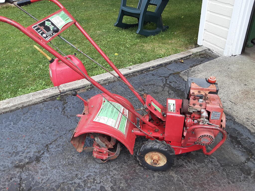

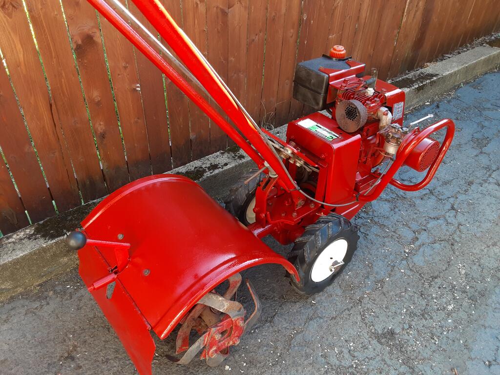

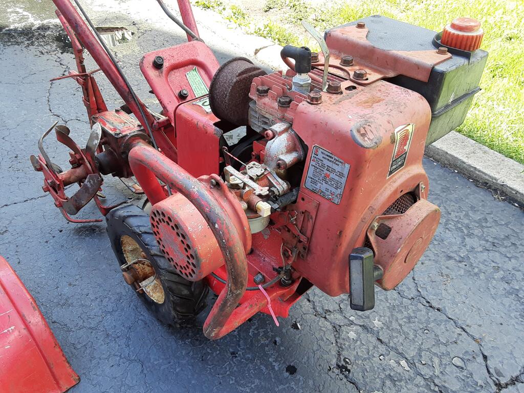

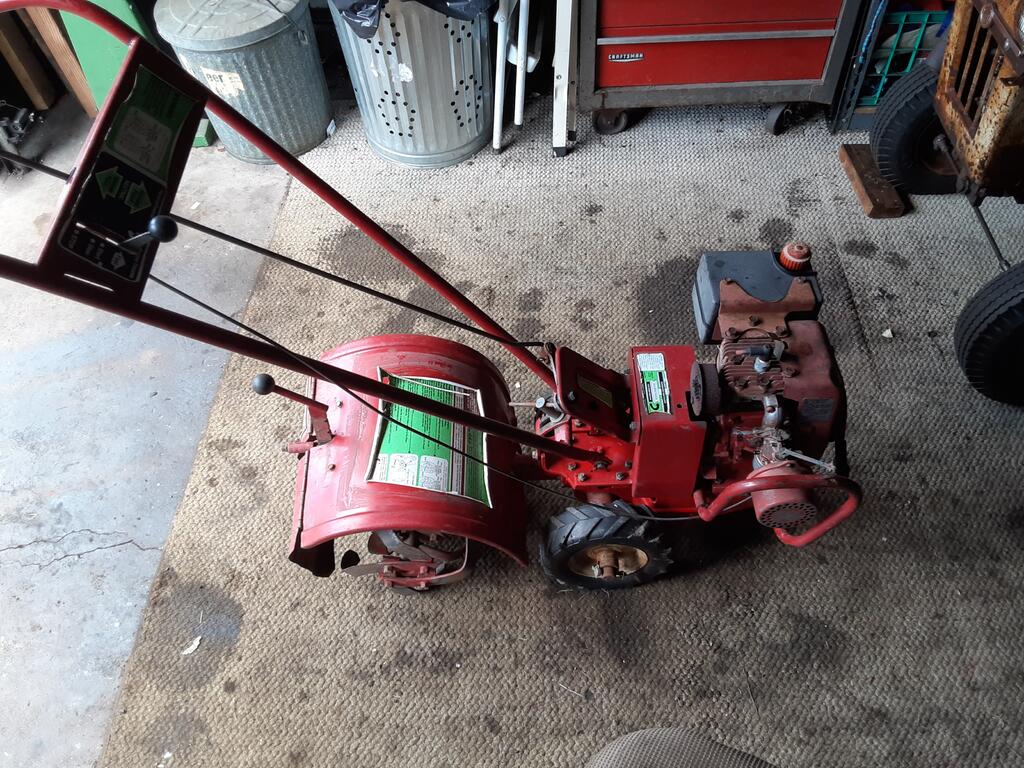

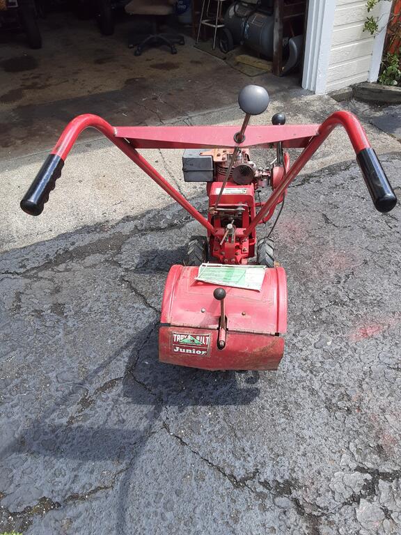

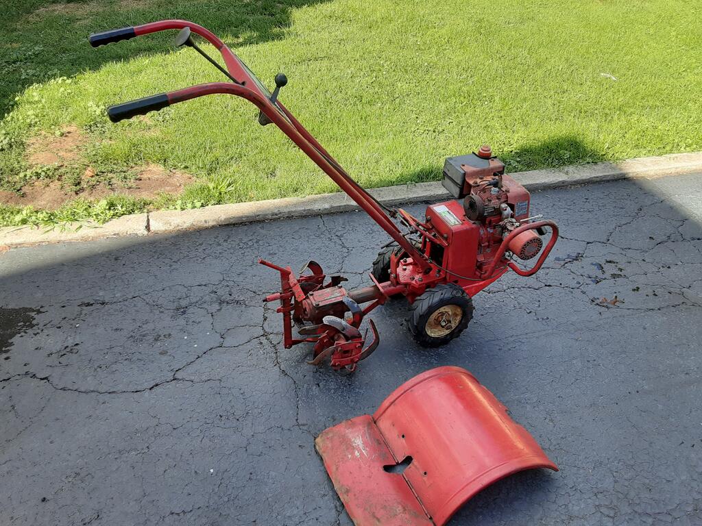

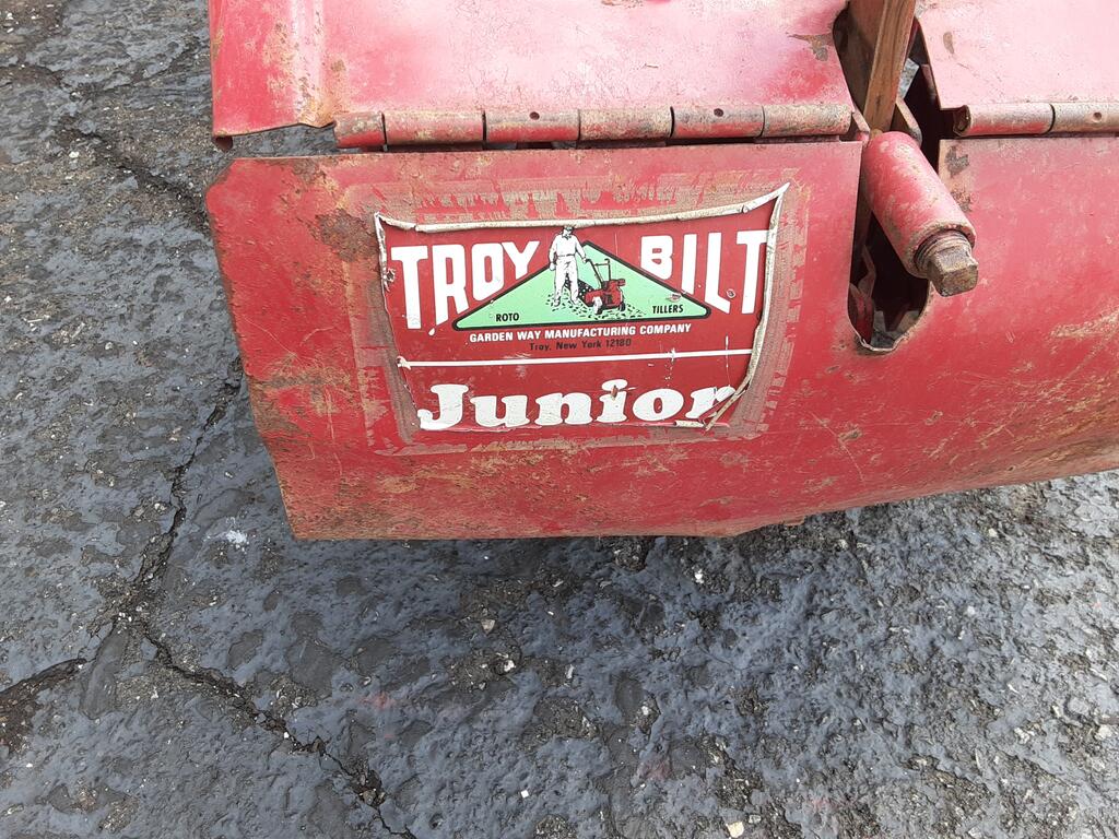

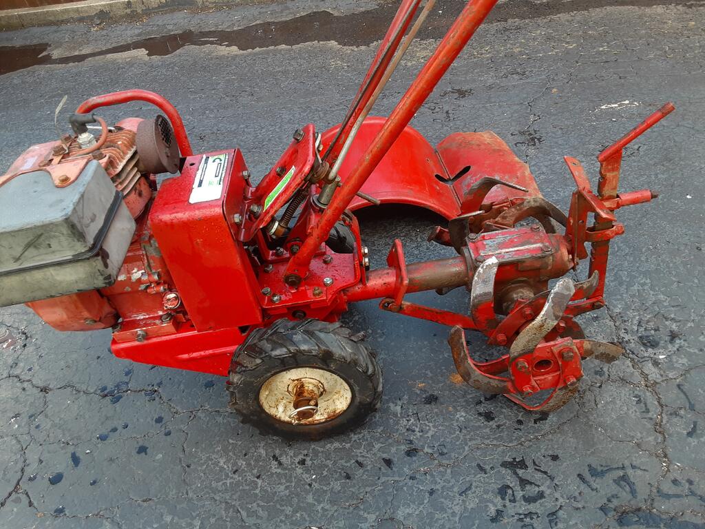

D_Mac 9,339 #1 Posted July 31, 2020 (edited) I am going to start a new thread on this. Picked it up at a garage sale. I know nothing about tillers. Figured I would give it some love and fix it up some. Ordered a new carb for the 3.5hp Tecumseh. Going to change fuel line, change oil, change plug, new air filter and the engine will be good to go. I cant find a ID number anywhere on the tiller. I know its a Junior from the sticker but I dont see any like this one with the square cast iron gear housing for the tines. It also has a cast iron transmission housing for the wheel drive. I would like to change oil in both and not sure what to use in each. Can anyone help me out? Edited July 31, 2020 by D_Mac 4 Share this post Link to post Share on other sites

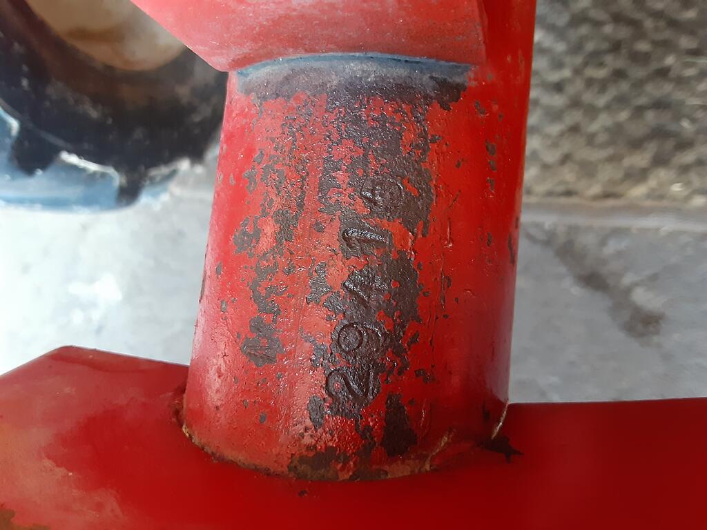

tunahead72 2,660 #2 Posted July 31, 2020 I don't know anything about the Junior model, but if it's anything like the Horse, the serial number will be stamped on top of the transmission housing, just above the axle. If you don't get any information from anybody else, I'll check my notes in the morning and see if I can find anything more useful. These guys might be able to help: @cafoose @Lee1977 1 Share this post Link to post Share on other sites

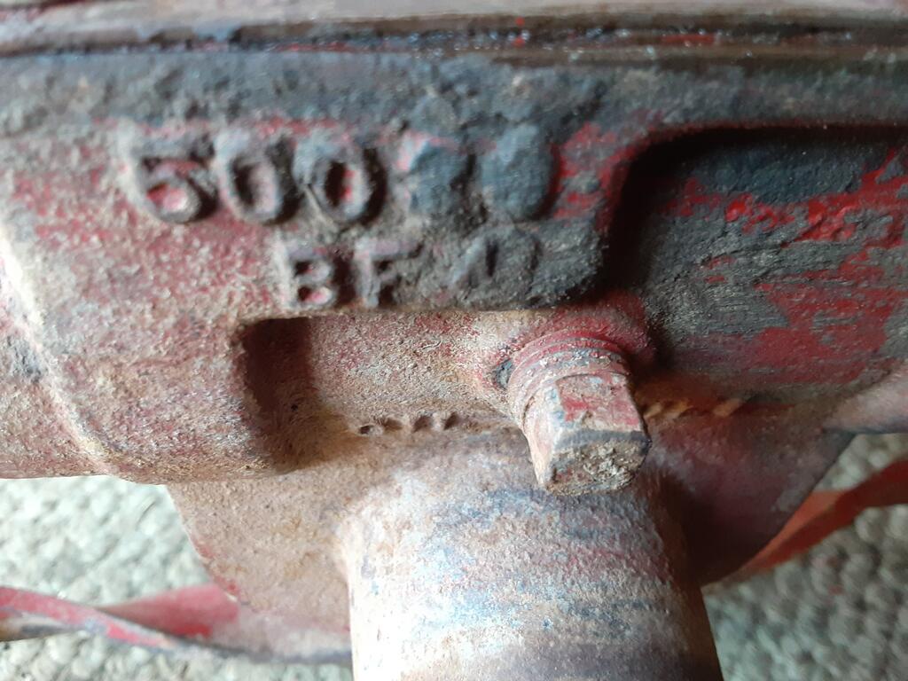

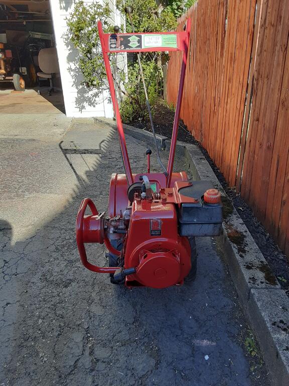

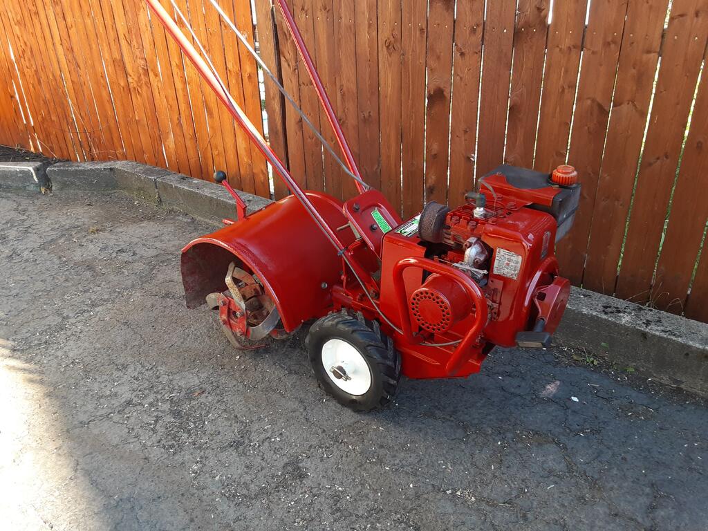

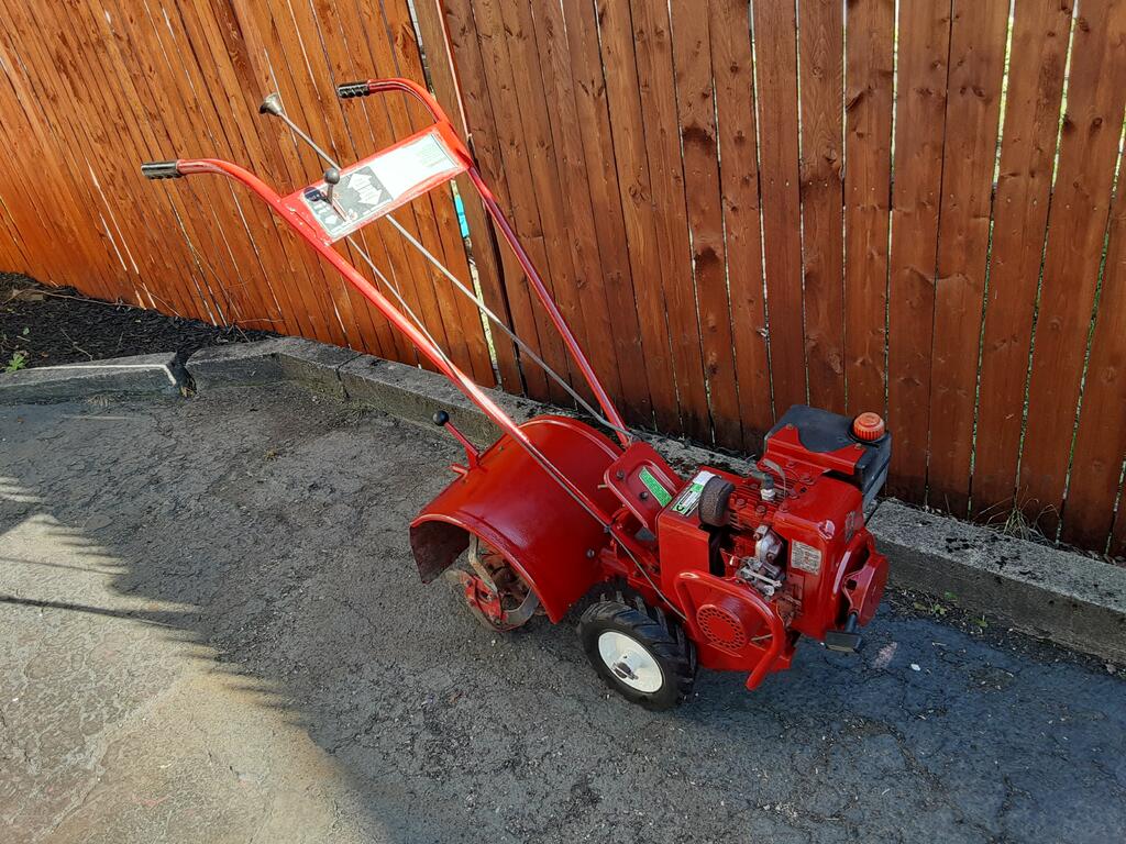

D_Mac 9,339 #10 Posted July 31, 2020 (edited) Well the only numbers I found were stamped on the tube frame. 29415. I googled it and nothing. The tiller gear box had those numbers on it. Cant really make them out. Well I changed the oil in both gear boxes. Each seemed pretty low. I thought I would throw some paint on it so I did. Came out OK. Paint kinda orange peeled a bit but looks a lot better. I decided not to paint the tines. Waiting for the carb. When it comes in I will do the engine work and finish it off. I have decals ordered as well. Still would like to know model # and what year it was made. Edited July 31, 2020 by D_Mac 3 Share this post Link to post Share on other sites
