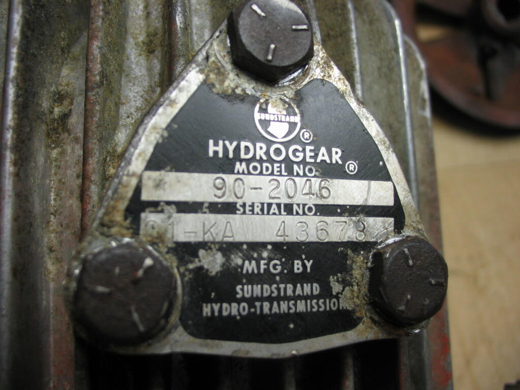

daveoman1966 3,884 #8 Posted July 27, 2020 Here is a Hyd Pump ID plate from the side of a 90-2046. The 90-2062 model has the same ID Plate. 2 Share this post Link to post Share on other sites
