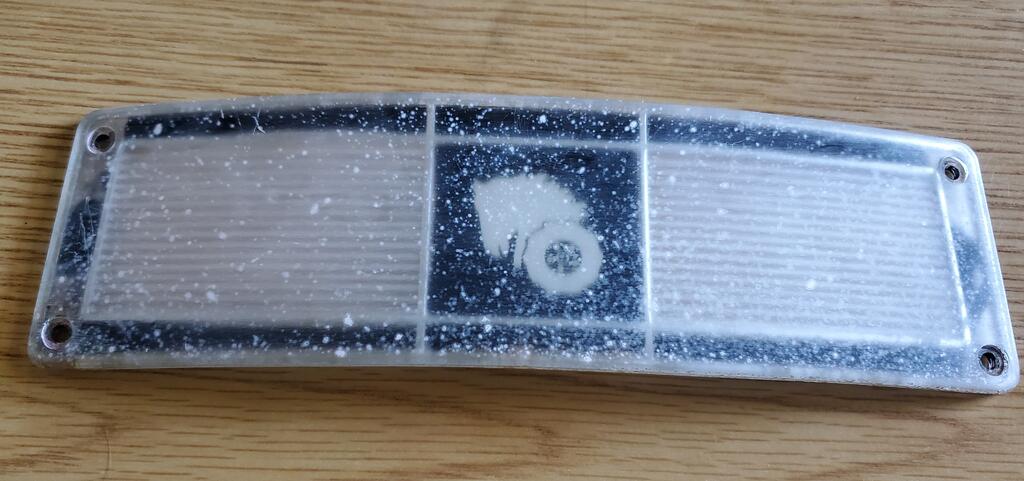

12Horse Paladin 1,038 #1 Posted July 24, 2020 mornin, Y'all. If this isnt the right spot, please feel free to move; didnt kno where exactly to post this... Any ideas as to what i could use/do to clean up this headlight lens; maybe fixup the black border...? Its cloudy, as you can see. Ill use it as is, but if i could make it look a lil better n cleanup the clear parts, id like to. Also, where can you get the screws to mount it? PO used phillips screws, n i kno that's not right... I hope everyone has a good day, n thanks😊 Share this post Link to post Share on other sites

Pollack Pete 2,273 #5 Posted July 24, 2020 I use plastic polish.Can't recall the brand right now,it's out in my shop.Will look later.I also use polish made for pinball machine plastics.Product called Novus.Has 3 different grits.1 for light scratches.2 for medium scratches.3 for heavy scratches.This stuff works really well. 1 Share this post Link to post Share on other sites
peter lena 10,047 #6 Posted July 24, 2020 12 horsepalidin, i use MEGUIRES PLASTIC X , MADE FOR FADED HEADLIGHT LENSES , https://www.walmart.com/ip/Meguiar-s-G12310-PlastX-Clear-Plastic-Cleaner-Polish-10-oz/16550253?wmlspartner=wlpa&selectedSellerId=0&wl13=2200&&adid=22222222227010027956&wl0=&wl1=g&wl2=c&wl3=40838625392&wl4=pla-78651900512&wl5=9003292&wl6=&wl7=&wl8=&wl9=pla&wl10=8175035&wl11=local&wl12=16550253&veh=sem&gclid=EAIaIQobChMI74G4nI7m6gIV7wiICR0cAwsJEAQYASABEgIwDvD_BwE not only does it really clean up a lens , do it a couple of times , but it will make plastic squeaky clean , used it on all my car lights , look like new, pete 3 Share this post Link to post Share on other sites

Lee1977 7,764 #11 Posted July 24, 2020 13 minutes ago, 12Horse Paladin said: Ok; i will. I dunno if im gonna remove my headlight bucket yet, tho, as im not too keen bout the process. Kno i can drill out the rivets, but not sure what i need to put it all back, as ive never worked with those. May just try to get what i can reach, there. But i will.I will 😊 Ty, again As well as I can remember the head light bucket is pop-rivited in, I have used tooth paste to polish wrist watch cristels . Might want to try it on the bottom edge first to see how it does. 1 Share this post Link to post Share on other sites

pfrederi 21,145 #13 Posted July 24, 2020 When you put the lens back on get 4 tiny o rings that will fit around the screws and fit into the well on the lens. helps cushion and prevent cracking... 3 Share this post Link to post Share on other sites
bc.gold 3,406 #14 Posted July 24, 2020 (edited) Vapour polishing ABS. 1. Wet sand your headlight smooth using 100-600 grid (240 in this case) 2. Wash and let dry to a haze 3. Use 10-30cc acetone in the kit per headlight 4. Slowly start vaping from bottom to top. Try to cover all area. No need to repeat. 5. Let it sit for 10 mins before touching or reinstall 6. Avoid rain or carwash for 1-2 days Edited July 24, 2020 by bcgold 1 Share this post Link to post Share on other sites
