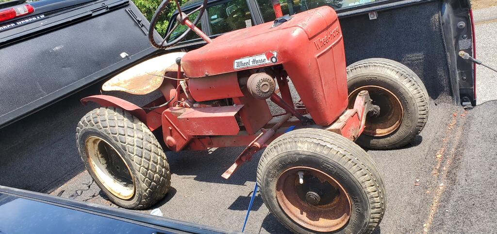

WHX?? 58,060 #15 Posted July 22, 2020 (edited) No... but should be no problem with a android device. Looks like it's maybe not in the right file format? I downloaded that last one and saved it to desktop and I could see it then. Karl @nylyon can you coach Chevrat ? Check out his boat fellas!!!!!!!!!!!!!! Wow didn't work for me either.... going to try to change it to a .jpeg You guys gotta see this boat!!!!!!!!!!!!!!! 20200707_183806.heic Edited July 22, 2020 by WHX24 Share this post Link to post Share on other sites
WHX?? 58,060 #16 Posted July 22, 2020 OK I used a online converter lets see if this works..... 1 1 Share this post Link to post Share on other sites
WHX?? 58,060 #17 Posted July 22, 2020 (edited) BINGO!!! So there might be the problem 'Rat In your 'droid there might be a way to save images as a jpeg rather than high eff. image format?? hopefully the IT fellas can chime in. BTW thanks for becoming a supporter! Edited July 22, 2020 by WHX24 Share this post Link to post Share on other sites
WHX?? 58,060 #18 Posted July 22, 2020 Here's the 550 ... not too shabby! Solid seat pan could suggest a early '60 2 Share this post Link to post Share on other sites
Jennifer 1,878 #19 Posted July 22, 2020 (edited) 3 minutes ago, WHX24 said: Here's the 550 ... not too shabby! Solid seat pan could suggest a early '60 Belt guard one line indicates 1960. Tech engine electric start so ya! 550! I can’t see the levers but... Great looking tractor! Love the rear tires!!! Edited July 22, 2020 by Jennifer 1 Share this post Link to post Share on other sites
nylyon-(Admin) 9,054 #20 Posted July 23, 2020 Problem is that the forum software doesn't recognize heic as a valid image format. Converting it is the best way to go for now. Share this post Link to post Share on other sites
