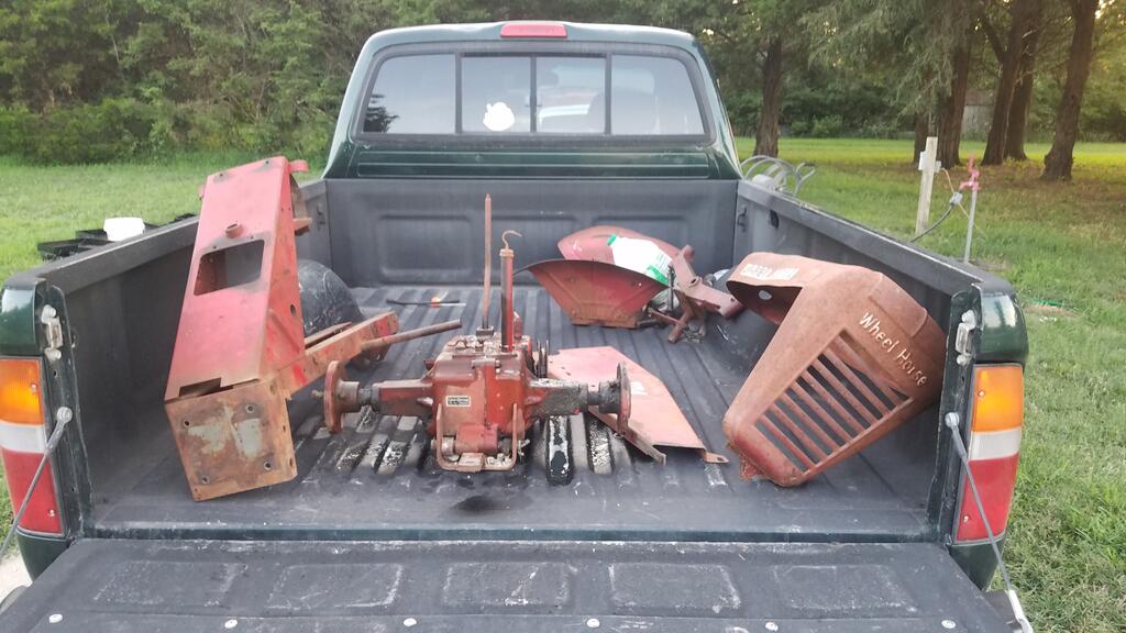

DBlackston 333 #1 Posted July 18, 2020 I have a 704 that had a bad transmission. I also have an 8 speed that came out of a C-111. The 704 has a K161 motor in it. I have new brake rods and clutch linkages from a raider that should take care of the problem of the brake drum being mounted on a different transmission shaft in the 4 vs 8 speed. I have read somewhere and now I can't find it that there is a different sized pulley I will need to run on the input shaft to be compatible. Can anyone point me in that direction? Heres a picture of the project tore apart in the bed of my truck. Share this post Link to post Share on other sites
