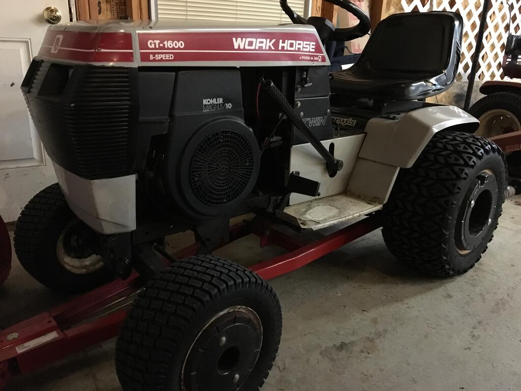

Sparky-(Admin) 26,407 #10 Posted July 18, 2020 I bought this GT-1600 already converted to a Kohler Magnum 10. 3 Share this post Link to post Share on other sites
