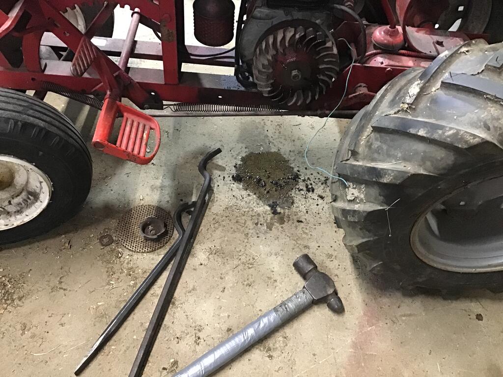

WHNJ701 4,173 #26 Posted August 22, 2020 (edited) Put the nut back on so it is flush with the end of the crank, you take 2 pry bars on the back of the flywheel and have her take a hammer and tap the nut/crank Edited August 22, 2020 by jabelman 1 2 2 Share this post Link to post Share on other sites
Pullstart 71,563 #27 Posted August 22, 2020 12 minutes ago, jabelman said: Put the nut back on so it is flush with the end of the crank, you take 2 pry bars on the back of the flywheel and have her take a hammer and tap the the nut/crank it worked! 4 2 1 Share this post Link to post Share on other sites

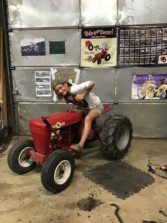

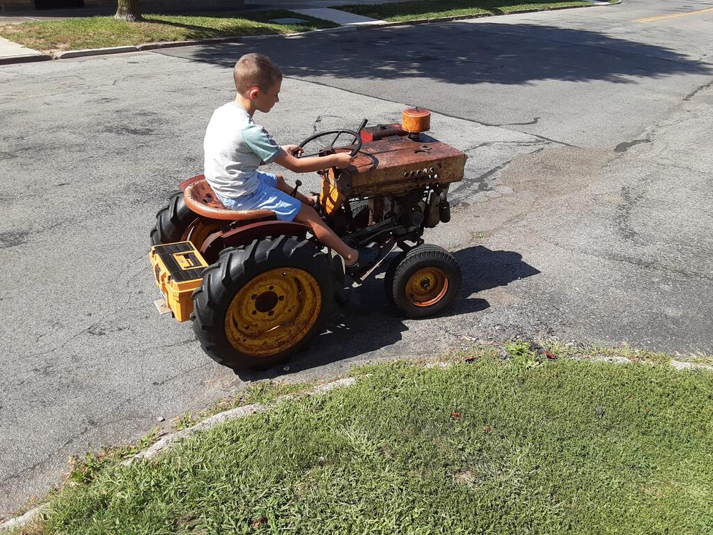

Pullstart 71,563 #28 Posted August 22, 2020 It runs! Rylee posed like the Race Horse guy on the poster! It’s past 11:30 at night, time for that kid to hit the hay! 1 6 2 Share this post Link to post Share on other sites

Pullstart 71,563 #37 Posted August 23, 2020 On 8/21/2020 at 11:53 PM, D_Mac said: Can she pull start it herself? I told my little nephew if he could pull start one of my tractors he could have it. So far he cant do it. He is only 6. She couldn’t quite get it fired up... but I have a feeling with a carb rebuild she’ll get it! It was pouring fuel out, I shut off the petcock then rolled it over myself for quite a while to dry out the plug. Once it fired up, I turned the fuel back on for her to take a stroll! 5 2 Share this post Link to post Share on other sites
D_Mac 9,339 #38 Posted August 23, 2020 Almost ..... She gets closer then my nephew gets. Maybe if she got a better angle on it. The Speedanza starts really easy. Most of the time first pull its running. 1 Share this post Link to post Share on other sites

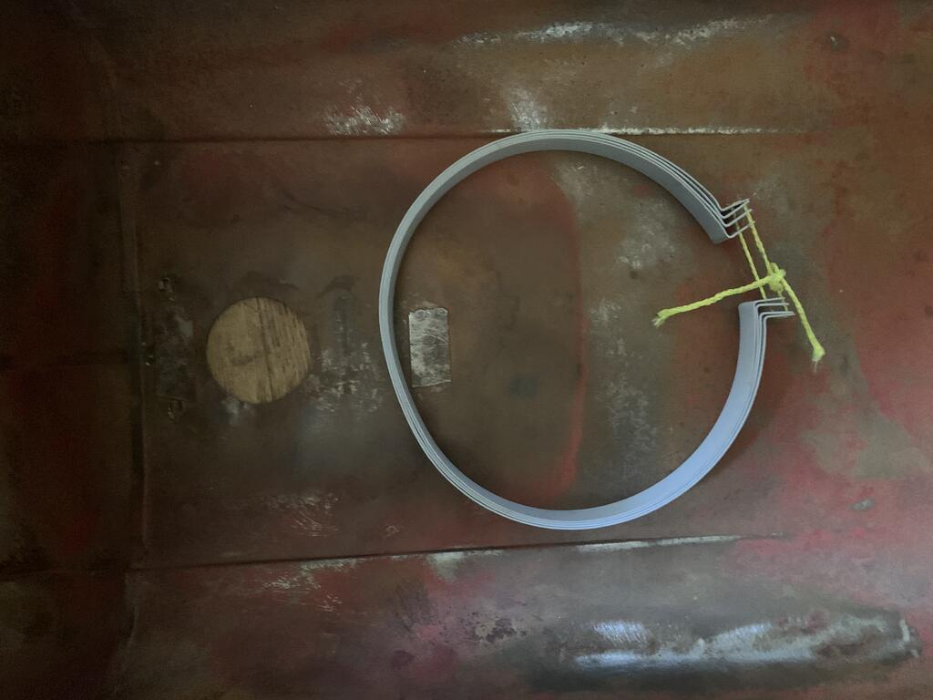

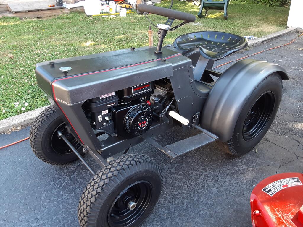

Pullstart 71,563 #40 Posted June 20, 2022 Not sure if I ever mentioned, Rylee calls this tractor “Fat Bob”. We”re replacing the fuel sediment bowl and rock hard fuel line in preparation of the show. The fuel tank straps are in dire straights but we’ll get to that. She still wants to cruise the show so that’s what we’ll do! 5 Share this post Link to post Share on other sites
Pullstart 71,563 #41 Posted June 20, 2022 Ready for the show! 3 2 Share this post Link to post Share on other sites
WHX?? 58,388 #42 Posted June 20, 2022 I was always wondering how to fix those straps. Maybe just make some all new ones? 2 Share this post Link to post Share on other sites

Pullstart 71,563 #44 Posted June 20, 2022 7 hours ago, WHX?? said: I was always wondering how to fix those straps. Maybe just make some all new ones? I’m thinking a bolt on support from the bottom. Take the weight off the hood. Though it lasted 60 years that way! Uncle Jim that old Clinton popped off and was running like a top. No smoke, ready to go! 2 1 Share this post Link to post Share on other sites
WHX?? 58,388 #45 Posted June 20, 2022 (edited) Thank you Jen I think I saw those too somewhere. I was going to suggest one of those Novar electronic ignition thingamabobs Kev. The Clinton I have on a 400 sets & the points need dollar billing. No big deal but a pain to have pull everything. I also suspected a bad condenser & points arcing so I moved that to the outside. Going to try the electronic route. Like I said that was always a good running motor but just never got ran unless kids here. Was always going to get one of those modded splined replacement steering wheels too. I thought I have the bushings & seals for the tranny just never got to it. Will look for them for ya. Yep I like the tank support from the bottom. Quick easy & reversible if you ever pull the hood for the right fix. Would be nice if a guy could find a locking throttle like @Achto has on his 701. Edited June 20, 2022 by WHX?? 1 Share this post Link to post Share on other sites
