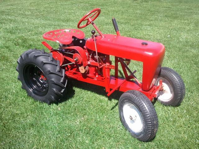

Lockupchuck 7 #1 Posted July 8, 2020 (edited) I believe I have a rj-35, or 85. Can someone help me with location of serial #s on frame, and Kohler 4hp serial# as there is several coats of paint on this Tractor, so I know exactly what I am working on? Thank you so much I believe it is a 50's Model Edited July 8, 2020 by Lockupchuck Added text Share this post Link to post Share on other sites
prondzy 3,889 #2 Posted July 8, 2020 No serial numbers on the frame tractors that old didnt have serial numbers. 4hp kohler most likely a k90 or k91 serial tag would be riveted tk the flywheel shroud on the carburetor side. Post pics of your tractor so we can help you identify it. 2 Share this post Link to post Share on other sites

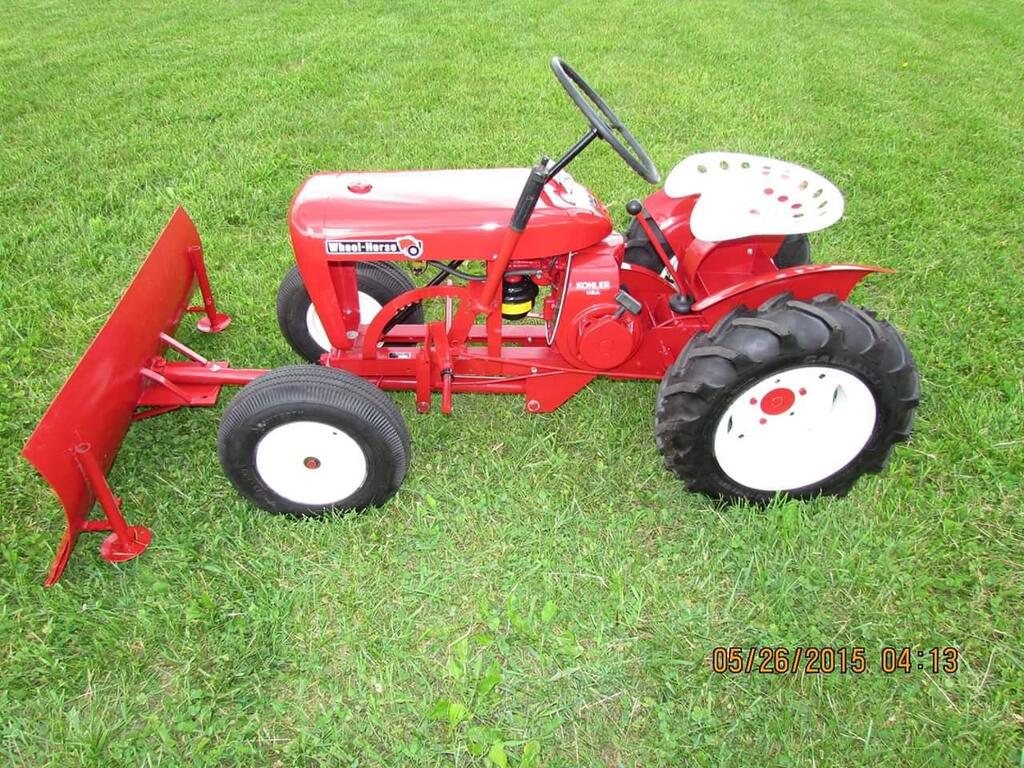

Achto 32,095 #7 Posted July 8, 2020 (edited) 1958 RJ58 would be the first year with a 3 speed transmission. Earlier years had a variable speed tranny that was operated by placing the lever on the right hand side in to different notches to adjust your speed. A picture of a RJ35 Edited July 8, 2020 by Achto 4 1 1 Share this post Link to post Share on other sites

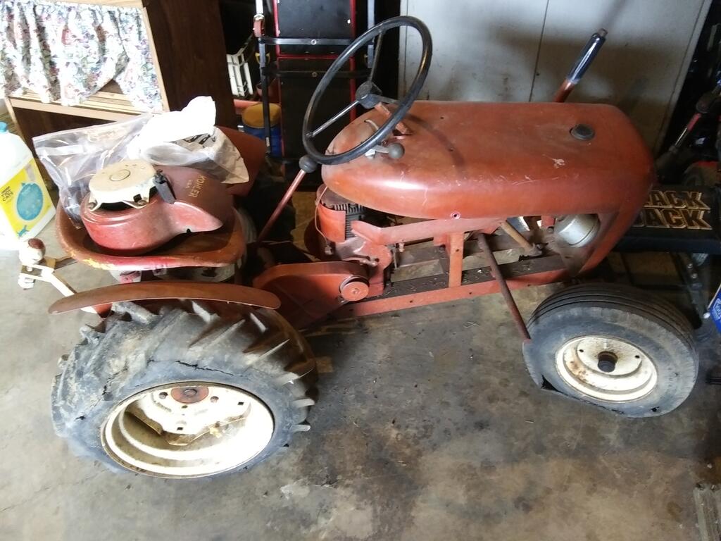

Lockupchuck 7 #12 Posted July 9, 2020 A Co-Worker got this ad a gift from his Father when he was 7 yrs old. They never could get it running. His Father has soon passed, and he asked me to look at it. The 4hp Kohler (I think) had 100# of Compression, but no spark. 2 Share this post Link to post Share on other sites
c-series don 12,129 #13 Posted July 9, 2020 Chuck, you will not find a nicer group of people than here at Red Square. This is another reason these little tractors are addictive!! 1 Share this post Link to post Share on other sites
Achto 32,095 #14 Posted July 9, 2020 1 hour ago, Lockupchuck said: 4hp Kohler (I think) had 100# of Compression, but no spark. Start by cleaning the points, first with a small file then a final clean by running a dollar bill through them. Check the gap & reset if needed. After checking run a dollar bill through them again to ensure that there was no residue left behind from the feeler gauge. If cleaning the points does not do the trick then try replacing the coil & condenser. You will have to remove the fly wheel to service these parts. Coil part number is 220435S Here is one source for parts. http://www.psep.biz/store/kohler_ignition_coils.htm Share this post Link to post Share on other sites

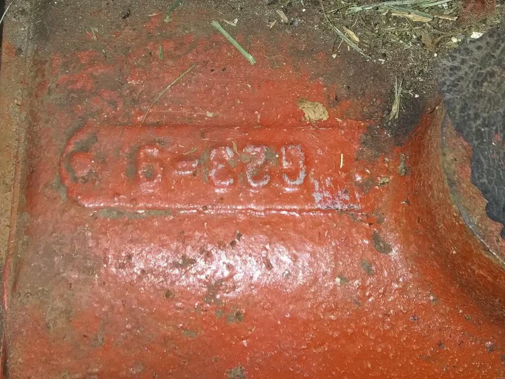

Lockupchuck 7 #15 Posted July 11, 2020 (edited) G23-9 is the Serial # on the Transmission Edited July 11, 2020 by Lockupchuck Added pics Share this post Link to post Share on other sites
Lane Ranger 12,031 #16 Posted August 5, 2020 (edited) Your rj is a 1959 based on G-239 on transmission. Built July 23,1959 Edited August 5, 2020 by Lane Ranger 1 Share this post Link to post Share on other sites

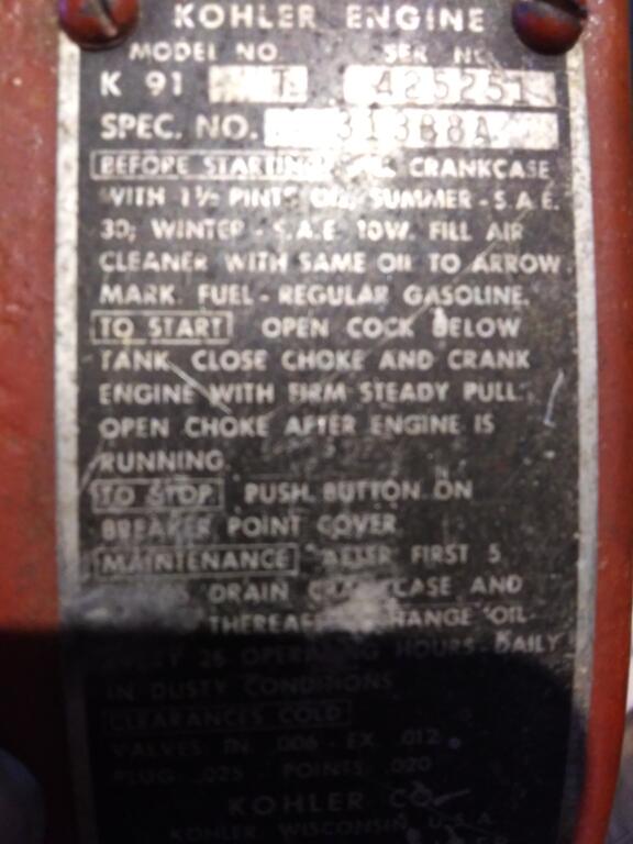

evanloock 263 #17 Posted August 5, 2020 What's the model and spec number on the K-91 Kohler? 1 Share this post Link to post Share on other sites
Lockupchuck 7 #18 Posted August 5, 2020 (edited) here is the Tag Edited August 5, 2020 by Lockupchuck Thank you Share this post Link to post Share on other sites
gwest_ca-(File Mod) 12,354 #19 Posted August 5, 2020 https://www.partstree.com/models/k91-31388-kohler-k-series-engine-made-for-wheel-horse-4hp-3kw/ Garry Share this post Link to post Share on other sites

bottjernat1 2,196 #22 Posted August 5, 2020 @Lane Ranger Is correct. 1959 The last digit is a 9 so that means she was made in 59. At least the transmission was. Share this post Link to post Share on other sites

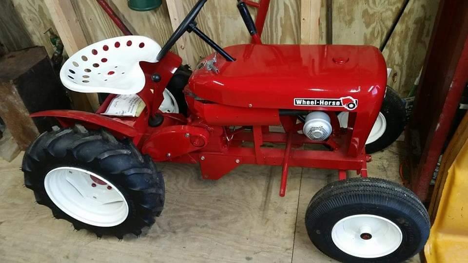

WHX?? 57,395 #23 Posted August 5, 2020 (edited) Is that a Clinton B1290 in there? Sure is a fine looking survivor! Never mind just saw the Kohler tin on the seat LOL Edited August 5, 2020 by WHX24 Share this post Link to post Share on other sites
bottjernat1 2,196 #24 Posted August 5, 2020 2 minutes ago, WHX24 said: Is that a Clinton B1290 in there? Sure is a fine looking survivor! I think every photo so far the motors are kohlers. My restored rj58 is a 4hp kohler Early 58 and some 59 had clintons tho. Share this post Link to post Share on other sites
