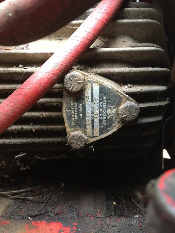

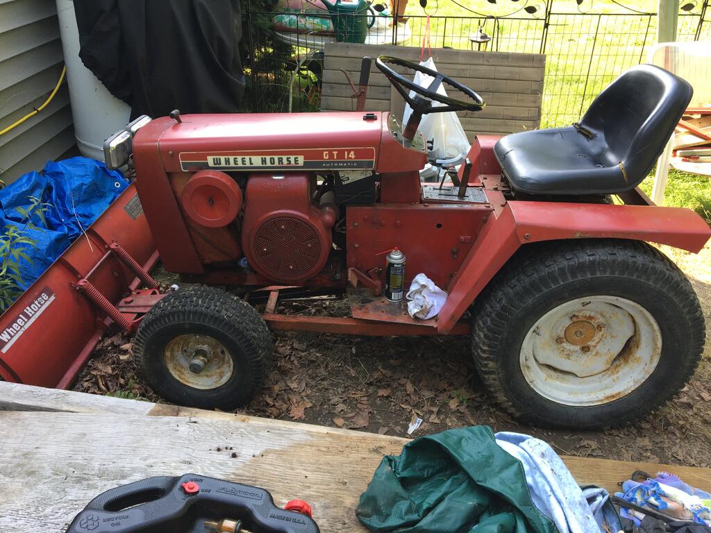

WheelHorseNut 222 #1 Posted July 7, 2020 (edited) Hey guys! It's been a while but I am starting a new project -- it's actually a tractor I bought about 2 years ago. It ran when I got it but I only messed around with it twice or three times and then it sat. We had a new addition to our family and, well, that was that for the rebuild. I actually bought this tractor to be mostly a plow (snow and dirt) tractor. When I got it, it ran good, no smoke.Some of the issues it has are as follows: There was a throttle cable issue (the casing was broken, not allowing it to operate the linkage). The ball joints were missing, replaced by bolts The usual wiring issues - PTO wiring was melted, aftermarket lights were put in and not working, rear lights were messed up, etc. So, I started working on it one morning: Changed the oil to 30W, new Autolite 4316 Plug, new air filter, fuel filter, proper sized battery (22NF), drained all the fuel & replaced, change a fuel line, etc. She started up and ran good -- a little popping from time to time. The carb, I think is messed up and could probably use a rebuild. If I manually operate the throttle linkage, it seems to load up and want to die and I can see it looks like it's dumping fuel as there is black smoke coming out of the exhaust. So, I took my daughter around the property on my lap and she thought it was hilarious and talks about going on the tractor all the time now. I go out there today to take her for another ride and get the thing started, then, it dies -- I wasn't quick enough on the choke. I go to start it and nothing. The ammeter is working (it shows a discharge with the key in run) so I jump the solenoid with a screwdriver and she turns over. I figure, no problem -- must be the ignition switch. I go out later and turn the key into the on position and jump the solenoid with a jumper wire and it starts up. I let it run for a bit and then shut it off with the key. Now, the ammeter shows no movement with the key in any position and I can't jump the solenoid. I'm guessing that finally killed the rest of the ignition switch, right? I also read that the ammeter could go bad and stop the ignition switch from getting power -- is that possible? I can't get out there with my meter now as it's raining... Here are some pics. Any thoughts would be great. Thanks! Edited July 7, 2020 by WheelHorseNut 5 1 Share this post Link to post Share on other sites
953 nut 69,439 #2 Posted July 8, 2020 2 hours ago, WheelHorseNut said: Now, the ammeter shows no movement with the key in any position and I can't jump the solenoid. I'm guessing that finally killed the rest of the ignition switch, right? I also read that the ammeter could go bad and stop the ignition switch from getting power -- is that possible? Amp meters can and do go bad, just remove the meter and bolt the two wires together for testing. Many of us remove amp meters and use a Volt meter. You should be able to jump the solenoid (big post to big post) even with a bad amp meter. The "+" battery cable goes directly to one post and the starter is connected to the other. Check the battery cables including the ground. 2 Share this post Link to post Share on other sites

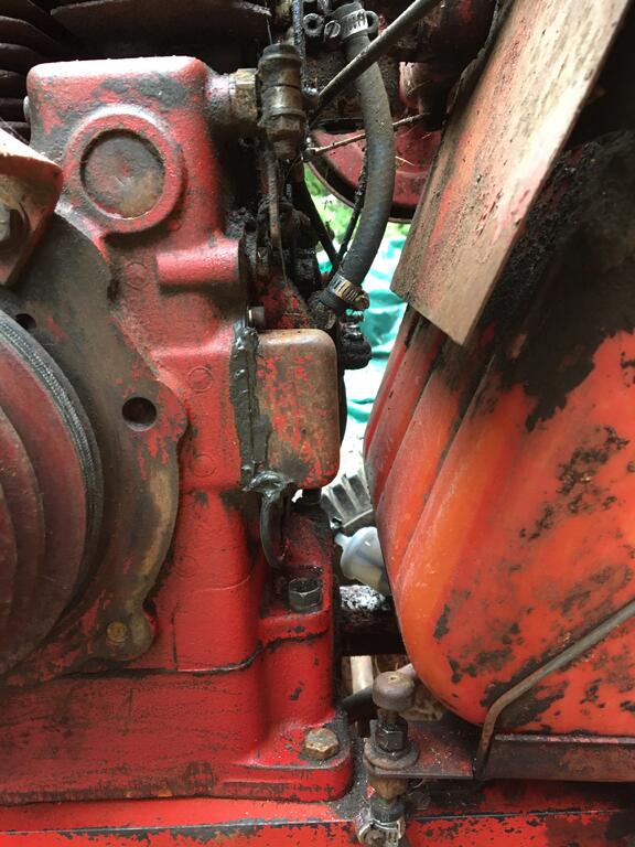

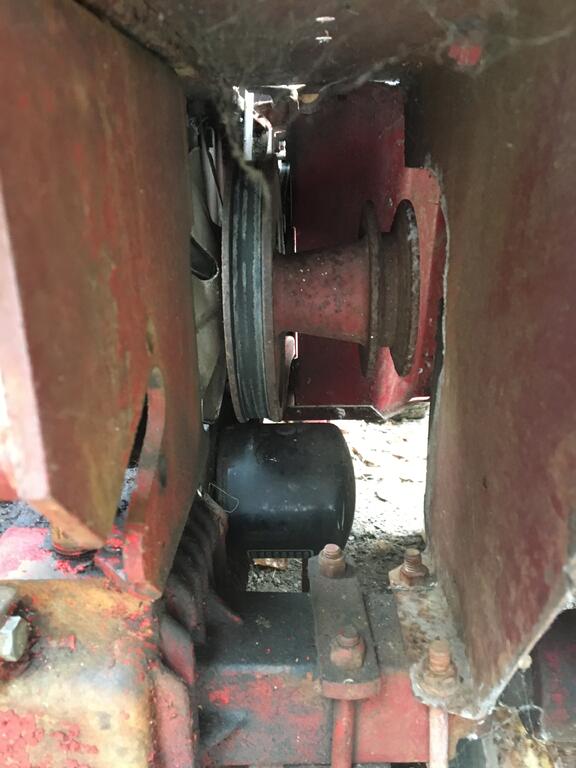

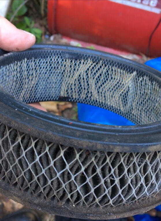

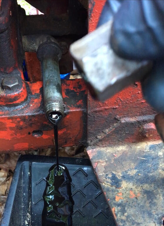

WheelHorseNut 222 #5 Posted July 8, 2020 26 minutes ago, pullstart said: If you don’t need that rear pulley for a tiller, I know of a certain young man looking to run a tiller with his “Blackbeard”... @PeacemakerJack Hahah! I'll keep that in mind, but I didn't even notice it when I bought the tractor (cold and rainy day -- I was going to buy it no matter what as the price was right). I just noticed it the other day when I was examining the hydro. The oil came out like mud and the air filter was the worst I've ever seen. At least the hydro filter is correct -- an OEM Toro filter... I am doing a double change on the hydro just to make sure. Looks like oil in there but I can't tell for sure (it's definitely not ATF) so I'm going to do a double change. Cheap insurance... I have a picture of the oil and air filter here somewhere...Ah, found them. 1 Share this post Link to post Share on other sites

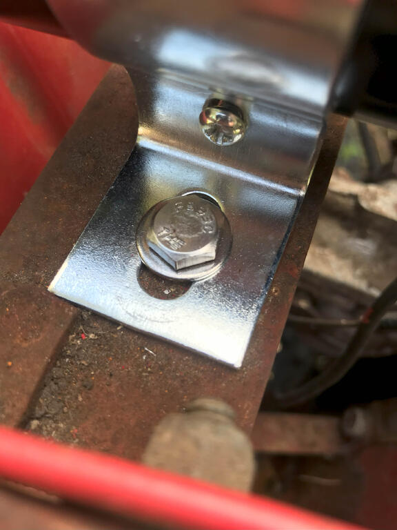

953 nut 69,439 #8 Posted July 8, 2020 8 hours ago, WheelHorseNut said: Do you guys run a secondary ground to the block? I like to run the ground cable to the engine block. Your starter is going to place the heaviest demand on the electrical system so I like to use one of the starter bolts as a grounding point. 1 Share this post Link to post Share on other sites
WheelHorseNut 222 #9 Posted July 10, 2020 On 7/8/2020 at 7:12 AM, 953 nut said: I like to run the ground cable to the engine block. Your starter is going to place the heaviest demand on the electrical system so I like to use one of the starter bolts as a grounding point. Will do -- I bought a longer negative figuring it should probably go somewhere other than that spot on the hood support framework. 1 Share this post Link to post Share on other sites

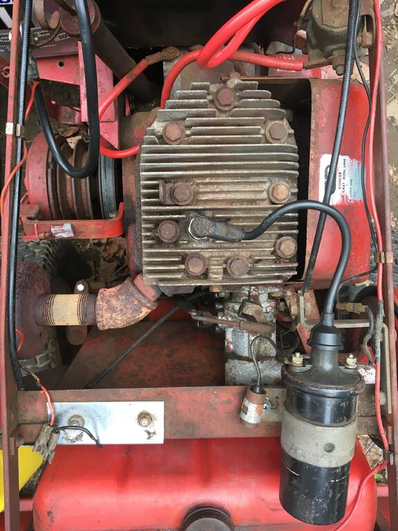

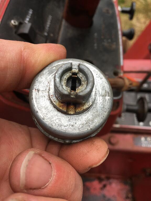

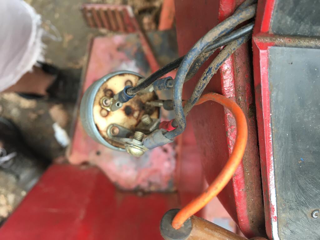

WheelHorseNut 222 #10 Posted July 10, 2020 I'm looking at getting a new ignition switch as I don't like the look of mine (almost a burn mark in the center on the back - see pic) and, from what I have found in the forums, there are two different switches used -- one for the solid state ignitions and one for the coil/condenser/points setups. I believe I have a points setup although I haven't looked under the RTV'd-to-hell cover I'll show in the pictures. If I have the coil and condenser and that little cover on the block, it should be the points style, correct? Does anyone have a Toro part number for the proper switch on points? I want to keep the standard GT14 4 positions on the ignition. In a post, Garry mentioned a 8362 Toro part (Ignition Switch Needed for a GT-14). Actually, I read another thread where he confirmed that the 8362 is not the correct switch for a points tractor (Help Wiring My GT14 Wheel Horse). I read a thread somewhere on here mentioning two other switches: 103990 - Should be for battery ignition (coil/condenser/points), correct? 103991 - Should be for Solid State/Electronic Ignition/Magneto/Breakerless (I've seen it mentioned many different ways), correct? Found the thread for that above info: GT-14 Ignition Switch Garry mentioned in one of those above links: On 9/9/2015 at 11:16 AM, gwest_ca said: 1969-1971 GT-14 used the 8362 switch with breakerless ignition 1972-1973 GT-14 used the 101876 switch with battery ignition. So, I'm guessing I need the switch# 103990, correct? That's what it looks like to me... Sorry for hashing this out in a thread but I wanted to make sure that if someone was looking for an ignition switch for their GT14 that all the info was in one place. Oh, there was also this informative thread from Garry regarding the differences: Using The Wrong Ignition Switch Here are some pics: Share this post Link to post Share on other sites
pfrederi 21,167 #11 Posted July 10, 2020 (edited) Why do you want the 4 position switch? With your battery points system the 103990 would work... I converted my GT-14 to battery points. The shank of the 103990 switch is a bit short the Instrument Panel in a GT 14 is thick only leaves a couple of threads to catch but it worked Edited July 10, 2020 by pfrederi 1 Share this post Link to post Share on other sites
WheelHorseNut 222 #12 Posted July 10, 2020 14 minutes ago, pfrederi said: Why do you want the 4 position switch? With your battery points system the 103990 would work... I converted my GT-14 to battery points. The shank of the 103990 switch is a bit short the Instrument Panel in a GT 14 is thick only leaves a couple of threads to catch but it worked I was thinking it would be more original and match the dashboard trim that has those designations on it (I have a fix for that, though). The following positions are retained in the 103990? Off Run Start You'd lose the Run & Accessory position, correct? The PTO switch would then work in the run mode instead of having to switch it back one, correct? Thanks for the info on that switch. I was hoping someone had tried it out. 1 Share this post Link to post Share on other sites
pfrederi 21,167 #13 Posted July 10, 2020 My electric PTO runs just fine in run with 3 position. Share this post Link to post Share on other sites

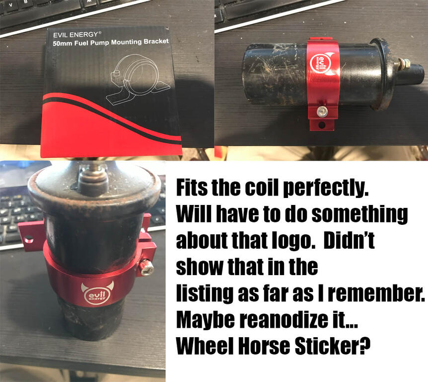

WheelHorseNut 222 #14 Posted October 11, 2023 Just added a new coil, condenser and stainless hardware to fix up the old stuff. The hardware, especially, was a mess. Mish-mosh of washers and crazy screws and bolt mix. Going to be working on it in the coming month to get her stone reliable for the winter. I also have to move some earth, to which she'll be an integral piece of the puzzle! I want to get a cool coil bracket for this one -- I saw some anodized red fuel pump brackets on that I'd consider trying. I can also machine something if I need to (I work in the metal stamping and manufacturing field). I just know that that 'plated' coil bracket is going to look like crap in a few years. 1 1 Share this post Link to post Share on other sites
WheelHorseNut 222 #15 Posted October 11, 2023 (edited) This is the one I'm considering: EVIL ENERGY 50mm Fuel Filter Mounting Bracket, Fuel Pump Clamp Holder Red It's 50mm with the rubber isolator and 55mm without. My coil is 55.1mm, so I think it'd work just fine. It's cheap enough at ~$10. Just not sure if it'd fit under the hood. Might have to make a bracket or something to relocate it slightly. Edit: Actually, they got back to me on the overall height -- they say it's 2.56" from top to bottom. My coil at the largest part of the diameter is 2.59" and that fits under the hood, so I'm guessing this will as well. I'm ordering one now and will update when it comes in. Edited October 11, 2023 by WheelHorseNut Added price Share this post Link to post Share on other sites

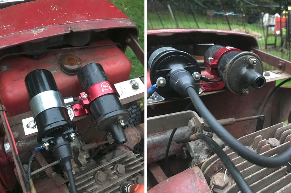

WheelHorseNut 222 #17 Posted October 12, 2023 (edited) 19 hours ago, Moparfanforever said: Pretty cool looking bracket!! I saved it to get one for myself. Yeah, man! I think it's going to really pop under the hood and it's cheap! It'll be here tomorrow, so I'll take some pics of it with the coil in it and mocked up under the hood. In the meantime, I am trying to get this thig reliable as I had mentioned. I am waiting to get my good voltmeter to replace the broken ammeter I took out and bypassed. It's going to be here in 2-3 months as it's totally custom. In the meantime, I bought this cheap mini voltmeter and I 3d printed this spacer flange for it. It's a temporary fix but I have the STL and gcode files if anyone wants to modify it to work with their tractor. Edited October 12, 2023 by WheelHorseNut added link Share this post Link to post Share on other sites

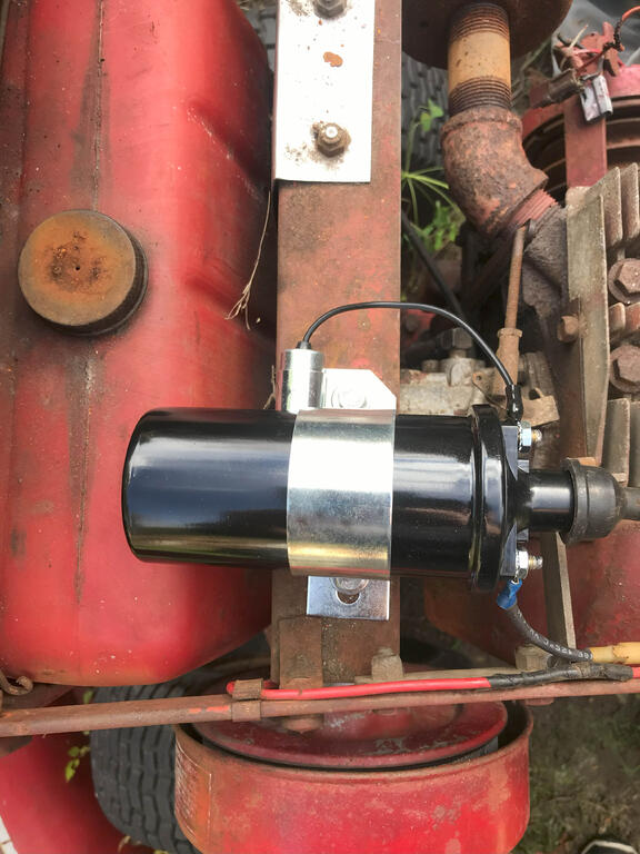

WheelHorseNut 222 #18 Posted October 13, 2023 This is how it fits -- now I am just waiting for the Amazon driver to show up with the little meter and other tractor goodies I ordered. I bought some replacement 8-32 x 1/2" pan head phillips stainless screws from tractor supply for $2.29. I also did a really solid permanent bypass for the ammeter wiring with a barrel connector and heat shrink tubing. It'll last until I rewire the whole tractor, which is the plan when I can afford the time to take her out of service. If anyone wants one, let me know. I printed an extra. I wish I had red filament -- would've been nice. Oh well. I'll also refine the print just because it's not as smooth as I wanted it... even though it's just a temporary thing for this tractor. 1 Share this post Link to post Share on other sites
WheelHorseNut 222 #19 Posted October 14, 2023 On 10/11/2023 at 6:35 PM, Moparfanforever said: Pretty cool looking bracket!! I saved it to get one for myself. I got the bracket and it fits perfectly! Will have to do something about the logo though.... Share this post Link to post Share on other sites
Moparfanforever 938 #20 Posted October 14, 2023 Good to know the coil fits. Looks sharp!! Share this post Link to post Share on other sites
WheelHorseNut 222 #21 Posted October 14, 2023 (edited) 13 hours ago, Moparfanforever said: Good to know the coil fits. Looks sharp!! It was raining but I snuck outside to mock it up and see how it would fit under the hood. Here are the pics. It actually sits lower than the stock bracket. I am going to be installing this for good on Monday. I am also going to talk to my pad printer from work and see what'll remove that pad print without harming the anodizing. This bracket is slick... totally worth the $10! I could have it powder coated... or just rattle can it, too... Let me see what it looks like when it's all said and done. EDIT: I spoke with my pad printer and here's what he said about removing pad printing off of anodized surfaces: I really depends on what ink mixture was used and how recently they were printed. We'd try Isopropyl Alcohol first to see if the printing comes off. Next we would heat the part for five minutes up to 160-170 F and using ink thinner, try to get it off. If that doesn't work we have an ultrasonic cleaner that can soften the ink layer a bit and then try the above methods again Edited October 15, 2023 by WheelHorseNut Added info from pad printer 1 1 Share this post Link to post Share on other sites
