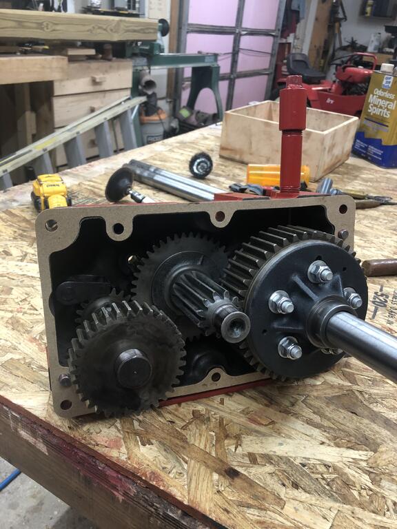

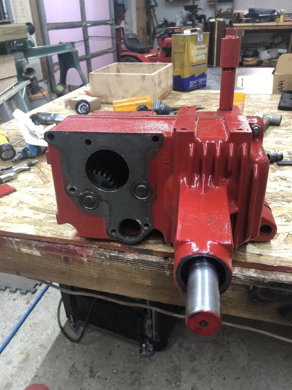

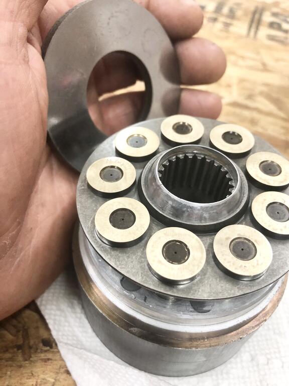

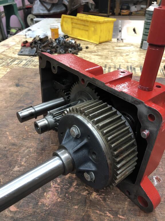

The Tuul Crib 7,354 #1 Posted July 4, 2020 Went through all the parts on the case first to make sure everything was correct. I had the parking brake pawl fixed and make sure all the gears are turning properly. Polished up the slippers and the swash plate. 2 Share this post Link to post Share on other sites
953 nut 68,791 #2 Posted July 4, 2020 Have you found the rest of the bolts for the differential? 3 Share this post Link to post Share on other sites
The Tuul Crib 7,354 #3 Posted July 4, 2020 52 minutes ago, 953 nut said: Have you found the rest of the bolts for the differential? Yes I do have all the bolts but I put in two for a dry fit to hold it together. I'm going to get new locking or Nila nuts for the bolts . I'm having some issues with one of the axles that has been repaired by the previous owner which does look like it was done correctly but my thoughts are now is the time to replace it if there are any doubts. 2 Share this post Link to post Share on other sites

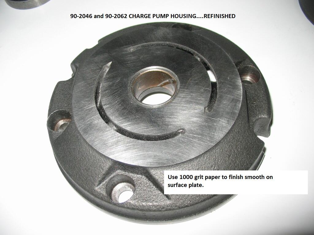

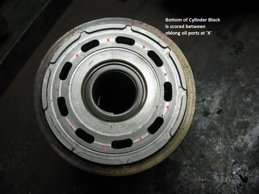

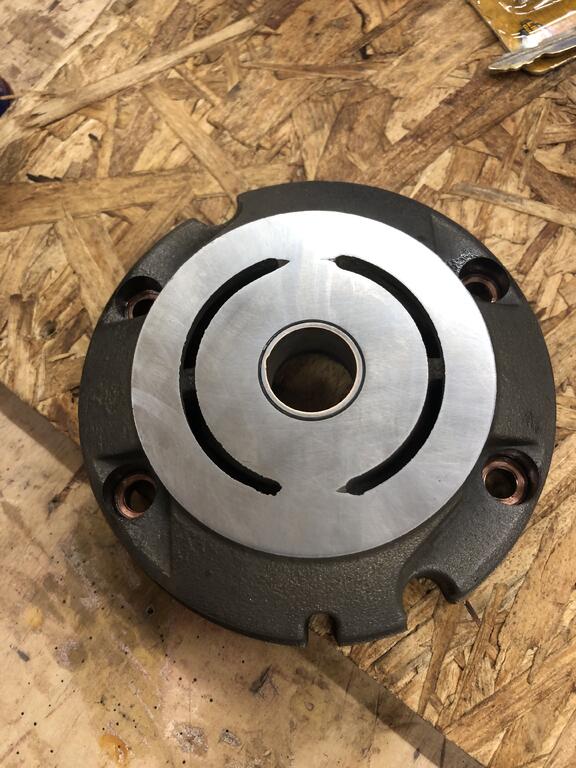

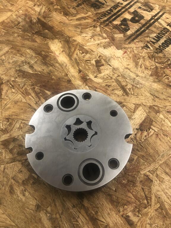

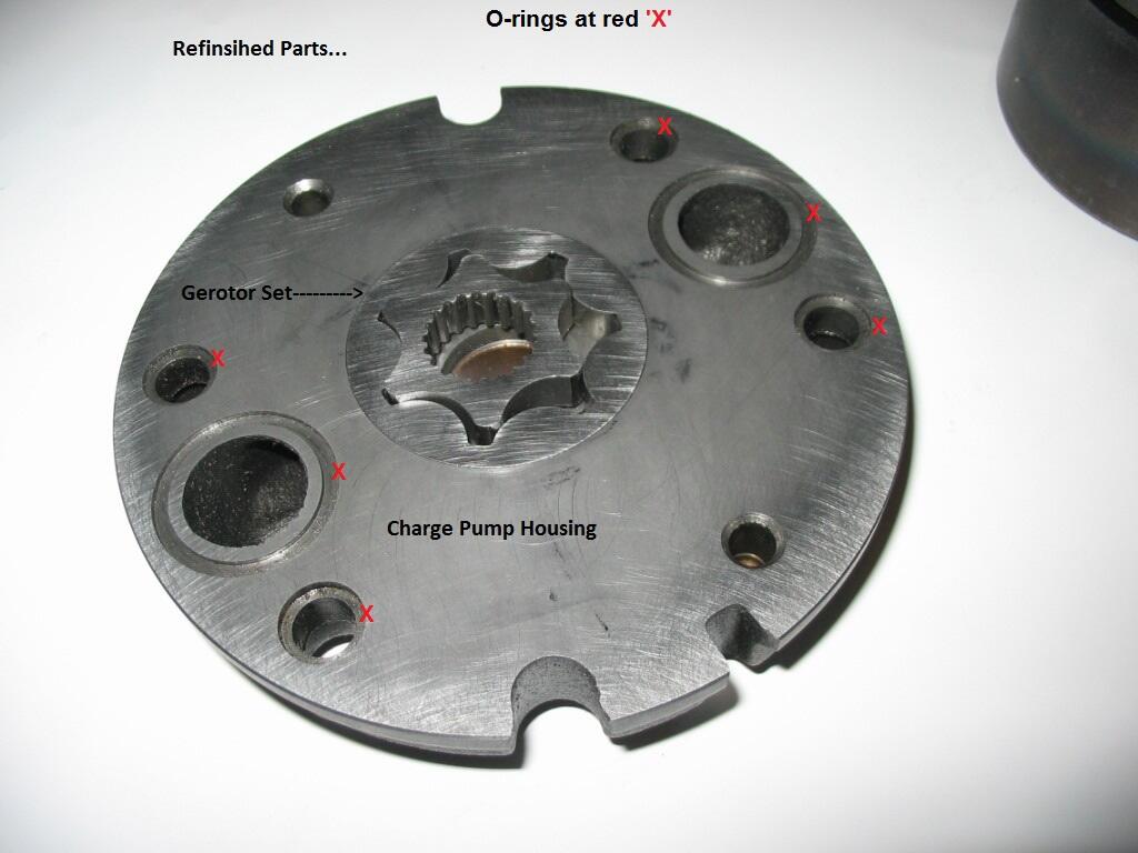

daveoman1966 3,884 #4 Posted July 5, 2020 Look at the base of the CYLINDER BLOCK. and the CHARGE PUMP housing with the GEROTOR SET. ALL of these parts need to have smooth surfaces...no deep scratches or gouges. 2 Share this post Link to post Share on other sites

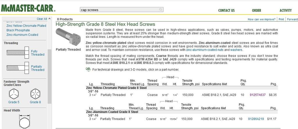

The Tuul Crib 7,354 #5 Posted July 5, 2020 13 hours ago, daveoman1966 said: Look at the base of the CYLINDER BLOCK. and the CHARGE PUMP housing with the GEROTOR SET. ALL of these parts need to have smooth surfaces...no deep scratches or gouges. So I'm looking to trade out the bolts on this differential that are about 3 1/4 inch long. 3 1/2 is too long and 3 inches too short. I could just leave the grade 5 bolt in it they seem to be OK. Share this post Link to post Share on other sites

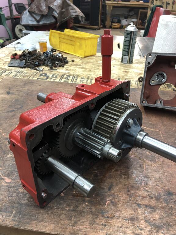

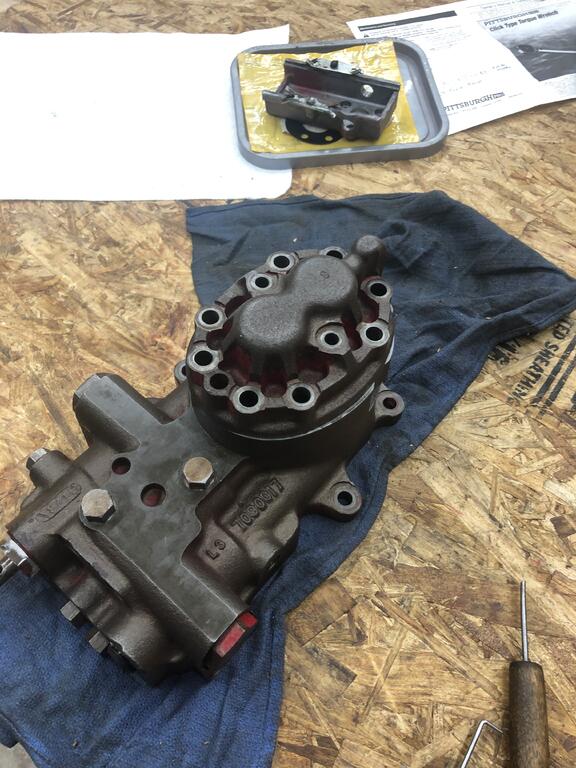

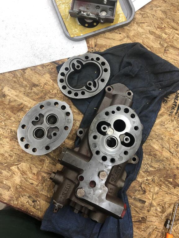

The Tuul Crib 7,354 #7 Posted July 8, 2020 Here's what I got so far. Just got my box today from McMaster Carr and I must say it was a speedy delivery! Great service there. Now I can start putting some painted parts together to look like a tractor. I still have a ways to go on the transmission. 1 Share this post Link to post Share on other sites
The Tuul Crib 7,354 #8 Posted July 10, 2020 (edited) Just got done with this part of the charge pump housing . My arms are killin me!! Edited July 11, 2020 by The Tuul Crib 1 Share this post Link to post Share on other sites
daveoman1966 3,884 #9 Posted July 10, 2020 5 minutes ago, The Tuul Crib said: Just got done with this part of the charge pump housing . My arms are killin me!! hahaha... looks good from here. It's all a 'labor of love'. Share this post Link to post Share on other sites
The Tuul Crib 7,354 #10 Posted July 10, 2020 2 minutes ago, daveoman1966 said: Yes I have to agree! And when my fat ass is sitting on this tractor riding around the yard I will be smiling!! Share this post Link to post Share on other sites

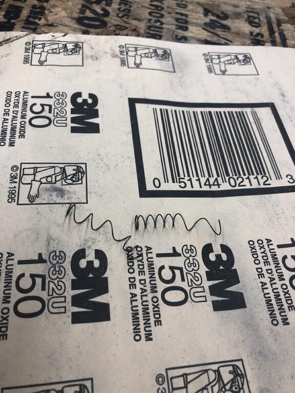

The Tuul Crib 7,354 #12 Posted July 11, 2020 Got in a little deeper I found this broken spring. Thankfully I have a donor transmission with two good ones! Share this post Link to post Share on other sites

mrc 1,116 #14 Posted July 18, 2020 hello tuul crib, the broken springs that you pictured: are they acceleration valve springs? are new springs available? if so, where? thank you mike in mass. Share this post Link to post Share on other sites
The Tuul Crib 7,354 #15 Posted July 18, 2020 The ones that are broken are not the Excelerator valve springs. The Excelerator springs are available through wheel horse parts and more in the vendors section here. Share this post Link to post Share on other sites

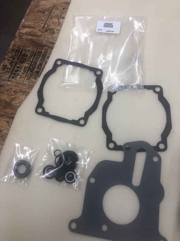

The Tuul Crib 7,354 #16 Posted July 25, 2020 (edited) I just got the seal kit from LJ fluid power for the Sunstrand transmission. It comes with every seal , o ring and gasket necessary to make it happen. 44 bucks. Does anyone know the torque specs on these 10 bolts? @daveoman1966 Edited July 25, 2020 by The Tuul Crib Share this post Link to post Share on other sites
953 nut 68,791 #17 Posted July 26, 2020 14 hours ago, The Tuul Crib said: Does anyone know the torque specs on these 10 bolts I have always referred to the torque spec charts. https://www.boltdepot.com/fastener-information/bolts/US-Recommended-Torque.aspx 1 Share this post Link to post Share on other sites
