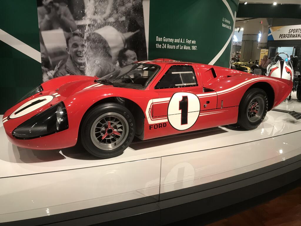

8ntruck 9,310 #39 Posted July 10, 2021 Looks like you two had a great trip. The Henry Ford Museum is one of my favorite places. Been a long time since I was there. In the late '90s, we hosted an exchange student from Finland. He was a big Ferrari fan. One of the trips we made with him was to the Henry Ford Museum. We got to that red GT 40 and I gleefully pointed out that it was a Ferrari killer when he asked what it was. 4 Share this post Link to post Share on other sites
