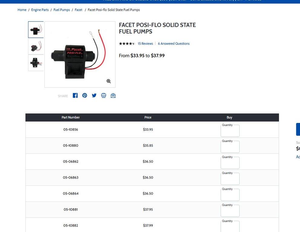

pfrederi 20,827 #2 Posted July 2, 2020 Glad it worked out ...US made Facet Posi flow are about $35, at their current draw relays are not necessary... 4 1 Share this post Link to post Share on other sites
roadapples 6,987 #3 Posted July 2, 2020 24 minutes ago, pfrederi said: Glad it worked out ...US made Facet Posi flow are about $35, at their current draw relays are not necessary... @pfrederido you have the part number for the one you use. I used the cube style 40163 because it is 1.5-2.5 psi. But it was about $67 with shipping.... Share this post Link to post Share on other sites
pfrederi 20,827 #4 Posted July 3, 2020 I use 60345 4 psi no issues comes with fittings. others may want lower pressure 60301 1 1 Share this post Link to post Share on other sites

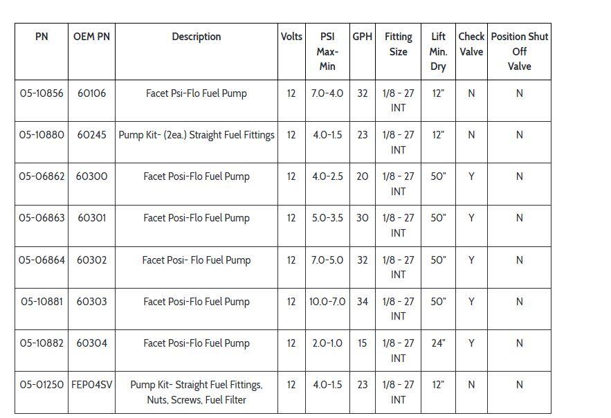

KC9KAS 4,746 #5 Posted July 12, 2020 On 7/2/2020 at 7:06 PM, pfrederi said: Glad it worked out ...US made Facet Posi flow are about $35, at their current draw relays are not necessary... I bought a Facet Posi Flow # 60106 and it was $65 at an auto parts shop. You sure you didn't use #60245? 1 Share this post Link to post Share on other sites
pfrederi 20,827 #6 Posted July 12, 2020 Yes fat finger typing 60245. Your auto parts store has a heck of mark up...Also the 60106 is kind of high pressure for our purposes. 1 Share this post Link to post Share on other sites
