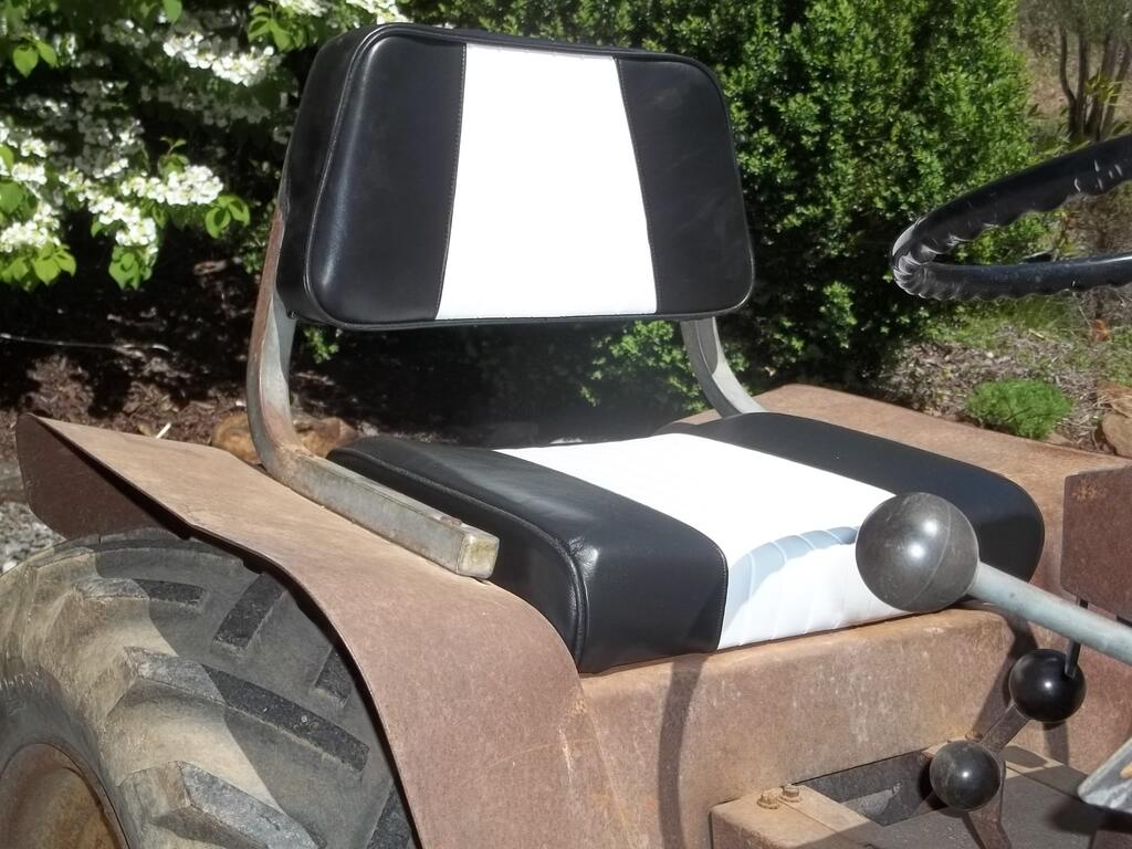

BOB ELLISON 2,983 #1 Posted July 1, 2020 As most of you know I make seats. Particularly 1054/953 c160/gt14 And lawn rangers. I'm retiring from them this year. I've made my last c160 seats and I posted in the FOR SALE I posted when I first started making them that the c160 was very challenging and that it was a work of love for these great tractors and the guys that make up Redsquare. But my health says I'm ready to lay it down. I've always tried to make the very best I could. I never scrimp on materials and the quality was as high as I could afford without compromise. The c160 was a beautiful style but I had to invest a lot to make it. I'm not complaining I'm proud to probably be the only one that has ever made a reproduction of this seat. I will continue to make the lawn ranger and the 1054/953 until October this year. Thanks to everyone that purchased from me and if you were not satisfied with my work pm me and I'll make it right.Thank you all 4 3 7 Share this post Link to post Share on other sites

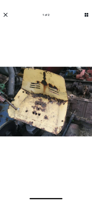

Jon D 82 #9 Posted September 22, 2020 Hi Bob, I’m new to this forum and just saw your work, looks amazing! I’m pretty handy with the sewing machine and just wondering if you could give me some pointers on making the cushions for a seat pan I just purchased. Once I restore the pan, I plan on making the cushions and putting it on a 1973 wheel horse. The current seat is not the original and in bad shape. Here is a pic of the pan I plan to use 1 Share this post Link to post Share on other sites
BOB ELLISON 2,983 #10 Posted September 23, 2020 Hi @Jon D It was a very hard job to make the patterns just to make that seat. The lawn ranger seat as I call them takes 5 different pieces of black vinyl and about a 2ft×2ft piece of pleated vinyl plus 7 feet of piping. Just to make one seat you would have to purchase the materials and you'll see that the cost is quite high. But a regular sewing machine will have trouble getting through all the layers. I invested more then $1500.00 just to make my first seat. I can tell you where to buy the materals if you want to build your own. 1 yard of black vinyl costs $30.00 a yard White pleated vinyl just costed me $71.00 for 2 yards. Piping is $3.00 a yard plus $3 or $4 Shipping I but it by the spoil 100 yards for $120.00 i buy the foam from a company 50 miles north of me. 2 inch 84"x72" for $90.00 1 inch 84x 72 for $72.00 If you don't have patterns to cut out the vinyl and know how to sew them on it will be a very hard job to make your own seat. The first 4 or 5 seats i made i had to throw out. I had to invent the little tricks to make a seat fit on the pan. A lot of trail and error. 1 2 Share this post Link to post Share on other sites
Jon D 82 #11 Posted September 23, 2020 33 minutes ago, BOB ELLISON said: Hi @Jon D It was a very hard job to make the patterns just to make that seat. The lawn ranger seat as I call them takes 5 different pieces of black vinyl and about a 2ft×2ft piece of pleated vinyl plus 7 feet of piping. Just to make one seat you would have to purchase the materials and you'll see that the cost is quite high. But a regular sewing machine will have trouble getting through all the layers. I invested more then $1500.00 just to make my first seat. I can tell you where to buy the materals if you want to build your own. 1 yard of black vinyl costs $30.00 a yard White pleated vinyl just costed me $71.00 for 2 yards. Piping is $3.00 a yard plus $3 or $4 Shipping I but it by the spoil 100 yards for $120.00 i buy the foam from a company 50 miles north of me. 2 inch 84"x72" for $90.00 1 inch 84x 72 for $72.00 If you don't have patterns to cut out the vinyl and know how to sew them on it will be a very hard job to make your own seat. The first 4 or 5 seats i made i had to throw out. I had to invent the little tricks to make a seat fit on the pan. A lot of trail and error. I have a few yards of high quality vinyl and one of my machines is capable of sewing multiple layers. What density of foam did you use? And what did you use for the foam backing? I’ve used thin plywood in the past on smaller seats for pedal cars. I’ve also made a few custom motorcycle seats before. Share this post Link to post Share on other sites

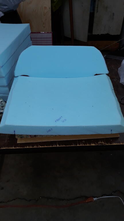

BOB ELLISON 2,983 #12 Posted September 23, 2020 (edited) I use a high density rubber foam. Here's there add. Our Luxury Firm foam is a high density foam. This foam grade is recommended for cars, seat pads, seat cushions and massage tables 4" thick or thinner. If you are looking for support and durability, then this foam is for you. This kind of foam has rubber based characteristics; which means it will maintain its original shape and density for many years with a high degree of support. I don't use any backing on the foam it is cut to fit the pan so the cover fits on it. The cover keeps the foam down tight. I slit the foam on the bottom to comform to the pan Edited September 23, 2020 by BOB ELLISON 2 Share this post Link to post Share on other sites

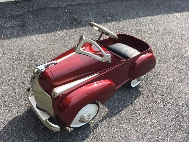

Jon D 82 #13 Posted September 23, 2020 Here’s a pic of the small seat I made for my daughter’s pedal car when she was little. I did a full restoration on this thing. Was her Grandfather’s when he was a little kid and was in bad shape before I started 3 4 Share this post Link to post Share on other sites
953 nut 66,310 #14 Posted September 23, 2020 14 hours ago, Jon D said: Here is a pic of the pan I plan to use That seat pan looks the same as the C-160 @BOB ELLISON makes cushions for. It is a very involved process, you would be better off buying them from Bob. Share this post Link to post Share on other sites
Jon D 82 #15 Posted September 23, 2020 28 minutes ago, 953 nut said: That seat pan looks the same as the C-160 @BOB ELLISON makes cushions for. It is a very involved process, you would be better off buying them from Bob. Bob is retiring from making them Share this post Link to post Share on other sites
BOB ELLISON 2,983 #16 Posted September 23, 2020 3 hours ago, Jon D said: Bob is retiring from making them Yes @953 nut is correct and that is a c160 pan. Good eye Richard I am not making them anymore. But on that pan the foam did have a backing and it was metal. I didn't look at it hard enough. I thought it was a lawn ranger seat pan. The vinyl for those has to be glued to the metal plates. I paid $85.00 for a quart of 3m glue when I was doing those but it will never come apart. If you don't have a fixture to hold and compress the foam as you glue its very hard to attach the vinyl to the metal. I'll post some pictures of the process later for you to see. 1 Share this post Link to post Share on other sites

BOB ELLISON 2,983 #21 Posted September 23, 2020 6 hours ago, jabelman said: @BOB ELLISON just curious on an average seat; how many hours did it if I started from scratch and I had all the materials on hand and only did one seat. Thats cutting black vinyl Cutting the pleated white vinyl cut wood,drill,sand and insert t-nuts cut foam sewing. for the c160 it was a much more involved with imprinting the lines and the wheel horse emblem. Stretching the vinyl and foam over the metal plates and gluing. Lawn ranger------ about 3 hours 953/1054------- about 5 hours C160 ---------------about 8 hours Share this post Link to post Share on other sites
