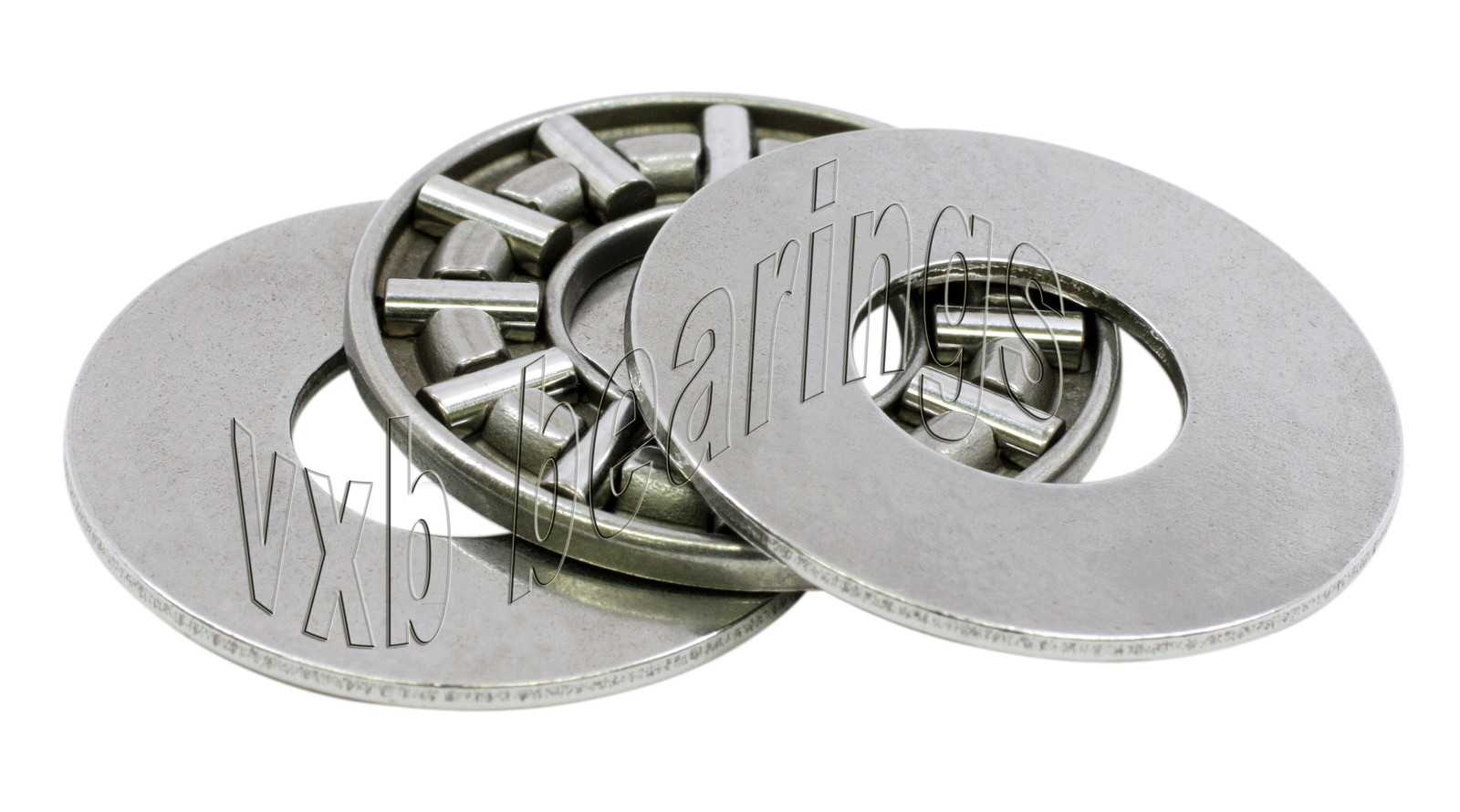

953 nut 70,064 #7 Posted June 29, 2020 One easy idea to reduce steering effort is to use thrust needle bearings. If you remove the spindles, cut off enough material from the top of the axle to allow for the bearing and washers. Place the bearing and washers on the spindle and put it back on the axle. Some occasional cleaning and lubrication will be needed but the whole job will cost about $ 35.00 and take a couple hours. 7/8' for GT-14/953/1054 and 3/4" for others. 1 1 Share this post Link to post Share on other sites
JAinVA 4,638 #8 Posted June 29, 2020 (edited) Richard has a good point.This idea can reduce steering effort.The only down side is if you need to reduce the top of the axle to much then wear is increaesed on both the axle and spindle.If you are reusing the parts you have,axle and spindle then the worn section of the spindles will be dropped from where they are now.This in the short term could increase steering effort until the high spot is worn down.The only to way minimize this issue would be to remove the stack height of the bearing and washers from the bottom of the axle. Edited June 29, 2020 by JAinVA 2 Share this post Link to post Share on other sites

RandyLittrell 3,946 #10 Posted June 30, 2020 2 hours ago, 953 nut said: One easy idea to reduce steering effort is to use thrust needle bearings. If you remove the spindles, cut off enough material from the top of the axle to allow for the bearing and washers. Place the bearing and washers on the spindle and put it back on the axle. Some occasional cleaning and lubrication will be needed but the whole job will cost about $ 35.00 and take a couple hours. 7/8' for GT-14/953/1054 and 3/4" for others. That was already in the works, I got part #'s from @ebinmaine and thats what got my mind on the idea of going to a gear reduction steering. It will take me awhile to find a steering unit and have a time when i want to have the loader down for a bit. I use it a lot. Needs the two front cylinders rebuilt so I gotta pull them and send them off to Lowell while I am at it. Randy 2 Share this post Link to post Share on other sites

bds1984 1,519 #12 Posted July 1, 2020 One aspect of steering that many often overlook in search of easy steering effort is the years of packed/caked on petrified grease on any point that moves. My straight axle 520H mutt had tons of thirty year old grease on it that once it was cleaned off and fresh grease installed, there was a noticeable drop in effort to turn. I'd still like to install the needle thrust bearings but fresh grease was much cheaper at the time. 1 Share this post Link to post Share on other sites
