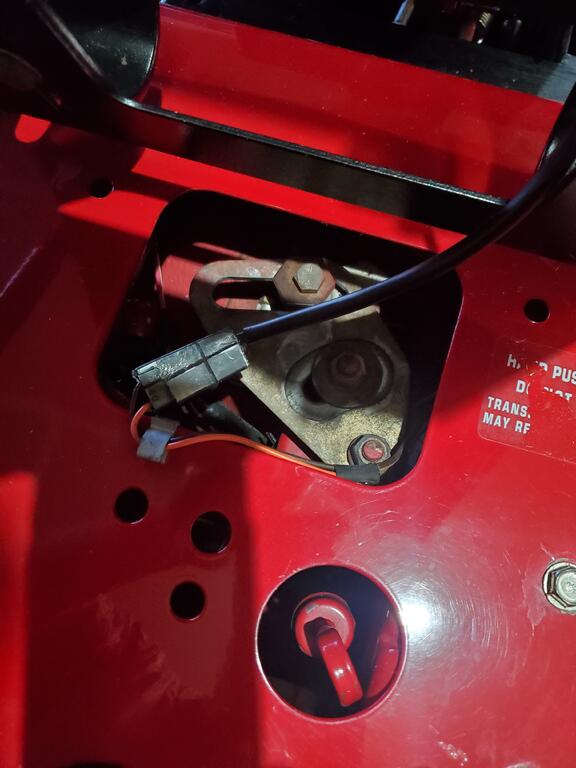

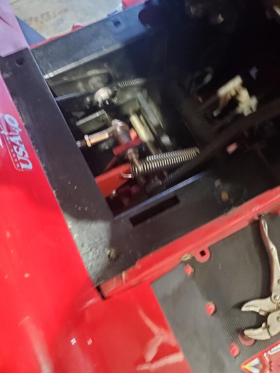

608KEB 794 #1 Posted June 29, 2020 How do I release the tension on the motion control for the transmission. I installed a foot pedal. It won't go back to neutral easily. 1 Share this post Link to post Share on other sites
JAinVA 4,619 #2 Posted June 29, 2020 Turn the nut CCW on the elongated slot portion. 1 Share this post Link to post Share on other sites
JAinVA 4,619 #3 Posted June 29, 2020 Just to be clear the upper plate closet to the camera.You can see where the washer rubs. Share this post Link to post Share on other sites
