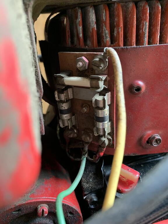

Crmaverick 91 #6 Posted June 28, 2020 2 hours ago, Terry M said: Disconnect the ground wire from the key switch(on L-157 Model) or from the on/off switch(On Model L-107) and see what happens. So I disconnected this ground wire at the terminal block leading to the ignition switch, problem is still there. Is there anything I should check on this terminal block? I see some fuses on the terminal block In the attached picture. Anything else I could try bypassing? Share this post Link to post Share on other sites
pfrederi 21,301 #7 Posted June 28, 2020 The bottom two are diodes for the charging system should have no impact on operation 2 Share this post Link to post Share on other sites

Tractorhead 9,218 #9 Posted June 29, 2020 22 hours ago, Crmaverick said: So I disconnected this ground wire at the terminal block leading to the ignition switch, problem is still there. Is there anything I should check on this terminal block? I see some fuses on the terminal block In the attached picture. Anything else I could try bypassing? 2 different Engines with exactly the same results? i doubt that the error is in both Engines exactly the same, or was it just a base Engine Swap and you using the complete envoiremental parts of your old Engine. When i do a bit closer inspection on your Pict, i see firstly a lot of oxydation in the fuse holders. independently if this occurs the troubles, pull them out ( mark before also direction for the diodes) clean the surface of fuseholder with a abrasive fleece use just a bit vaseline to protect the contact surface and then pull the part in again. Do the same on all other electrical contacts, part by part even on all Ground and Battery contacts. So you can exclude an electrical issue. Next i would check the Airfilter if it‘s clogged or even simply exchange the filter element. check also the intake and outlet paths if there is any Leak or clog. check also the silencer, if maybe a rusted part is loosening and felling in the silencer and clog the Exhaust path. ( use a Airgun and blow in exhaust direction) Same issues on 2 Engines seems for me to be a external issue. another simple Way is let the Engine run, ( even if it’s hard to start) and if it runs spray with WD40 along the intake path. if engine reacts, you find a leak. Share this post Link to post Share on other sites
Crmaverick 91 #10 Posted June 30, 2020 4 hours ago, Tractorhead said: 2 different Engines with exactly the same results? i doubt that the error is in both Engines exactly the same, or was it just a base Engine Swap and you using the complete envoiremental parts of your old Engine. When i do a bit closer inspection on your Pict, i see firstly a lot of oxydation in the fuse holders. independently if this occurs the troubles, pull them out ( mark before also direction for the diodes) clean the surface of fuseholder with a abrasive fleece use just a bit vaseline to protect the contact surface and then pull the part in again. Do the same on all other electrical contacts, part by part even on all Ground and Battery contacts. So you can exclude an electrical issue. Next i would check the Airfilter if it‘s clogged or even simply exchange the filter element. check also the intake and outlet paths if there is any Leak or clog. check also the silencer, if maybe a rusted part is loosening and felling in the silencer and clog the Exhaust path. ( use a Airgun and blow in exhaust direction) Same issues on 2 Engines seems for me to be a external issue. another simple Way is let the Engine run, ( even if it’s hard to start) and if it runs spray with WD40 along the intake path. if engine reacts, you find a leak. So I cleaned all those connections and checked fuses for continuity. Removed muffler and air filter. It actually ran normal for a few minutes and then the same problem happened. I wonder if the new carb I put on just clogged up real quick. With the old primer style carb I was able to keep it running by pushing the primer. I ordered a OEM tecemseh carb today and will replace the cheap aftermarket one I put on and bypass the fuel tank on the first try with it. 1 Share this post Link to post Share on other sites

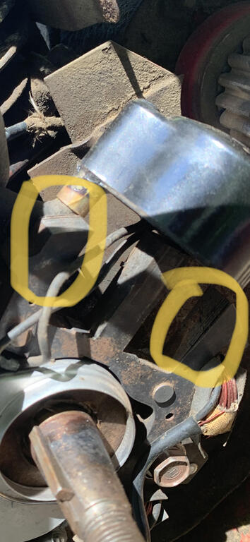

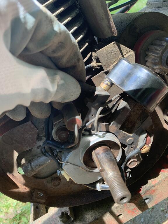

Crmaverick 91 #14 Posted July 2, 2020 18 minutes ago, D_Ram said: I need to follow this, apparently I am having the same issue with my 69 HH100. So let us know what you find. it’s very strange, new carburetor with fresh fuel bypassing the tank, exact same problem. then I had to jump the battery with a jumper pack, cranked the motor over and got it started for a couple mins. Then it started coughing when I gave it throttle and shut off. after that it wouldn’t start anymore. I checked for spark and didn’t see any spark, although it’s doing something because it gave me a nice shock. Share this post Link to post Share on other sites

Crmaverick 91 #16 Posted July 2, 2020 24 minutes ago, pfrederi said: You HH10 probably has the solid state ignition...Completely different system so I’m not getting continuity on these two middle fuses, they look different from regular fuses. Is there any reason I can’t replace them with regular 10 amp fuses like the top white one? Share this post Link to post Share on other sites
D_Ram 17 #17 Posted July 2, 2020 56 minutes ago, pfrederi said: You HH10 probably has the solid state ignition...Completely different system Yes it does have SSI Share this post Link to post Share on other sites
Tractorhead 9,218 #18 Posted July 2, 2020 (edited) On 6/28/2020 at 11:46 PM, pfrederi said: The bottom two are diodes for the charging system should have no impact on operation Paul @pfrederihad allready told what they both in the middle are for, that are no fuses, that are diodes. That‘s completely other things. Diodes just let current flow in one direction. Check you ground connection and ground wires, clean the surface between Engine, Frame and Battery and the screwed teminals. they must be metallic blank on contact surface. dismount the poles ( one at a time) clean it i.eg. with a steelbrush and scew it back on. At least protect the contacts with a light film of Vaseline, to prevent rust. if the screwed connectors on the Cables are bad, exchange them with new ones. dang few hundrets of miles between us for a quick visit and get it running. Even check this on all other electrical connector. Be aware for exchange the diodes with fuses, that will destoy a lot. even the diodes must urgently after cleaning the surfaces reinserting in the same direction as they are now. otherwise they will not work or even been damaged. Edited July 2, 2020 by Tractorhead 2 Share this post Link to post Share on other sites

953 nut 70,322 #22 Posted July 2, 2020 I would double check the setting on your points. Share this post Link to post Share on other sites
Crmaverick 91 #23 Posted July 2, 2020 32 minutes ago, 953 nut said: I would double check the setting on your points. I triple checked them when I had the flywheel off last weekend. Share this post Link to post Share on other sites
