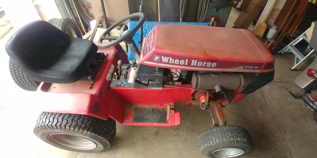

WVHillbilly520H 10,376 #9 Posted June 29, 2020 I recently picked up a non running 414-8 (and got it running) but a bit like you if I move the throttle fast from idle to WOT it will also "hiccup" but if I move it slowly upward to WOT it goes flawlessly each time... Maybe it's a Magnum thing. 2 1 Share this post Link to post Share on other sites
AHS 1,563 #10 Posted June 29, 2020 8 hours ago, WVHillbilly520H said: I recently picked up a non running 414-8 (and got it running) but a bit like you if I move the throttle fast from idle to WOT it will also "hiccup" but if I move it slowly upward to WOT it goes flawlessly each time... Maybe it's a Magnum thing. Yours looks a lot cleaner than mine!! Mine is mowing the dust bowl Maine’s got right now! No rain for approx 2-3 weeks.... everybody’s lawn is dead!! I’m trying to get ready for snowblowing, this is my first year on this tractor, so I’m trying to work all the kinks out of it!!! I know I’ve got to change my fuel line!! 1 Share this post Link to post Share on other sites
ebinmaine 74,551 #11 Posted June 29, 2020 No more dust bowl in southern Maine. Been raining all night. You'll see it soon. 1 Share this post Link to post Share on other sites
WVHillbilly520H 10,376 #12 Posted June 29, 2020 (edited) On 6/29/2020 at 5:34 AM, AHS said: Yours looks a lot cleaner than mine!! Mine is mowing the dust bowl Maine’s got right now! No rain for approx 2-3 weeks.... everybody’s lawn is dead!! I’m trying to get ready for snowblowing, this is my first year on this tractor, so I’m trying to work all the kinks out of it!!! I know I’ve got to change my fuel line!! That's the after pics... Original owner got the point of not caring and it was rather filthy... And I replaced ALL the fuel lines and filter and cleaned the engine and carb. Edited June 30, 2020 by WVHillbilly520H Share this post Link to post Share on other sites
