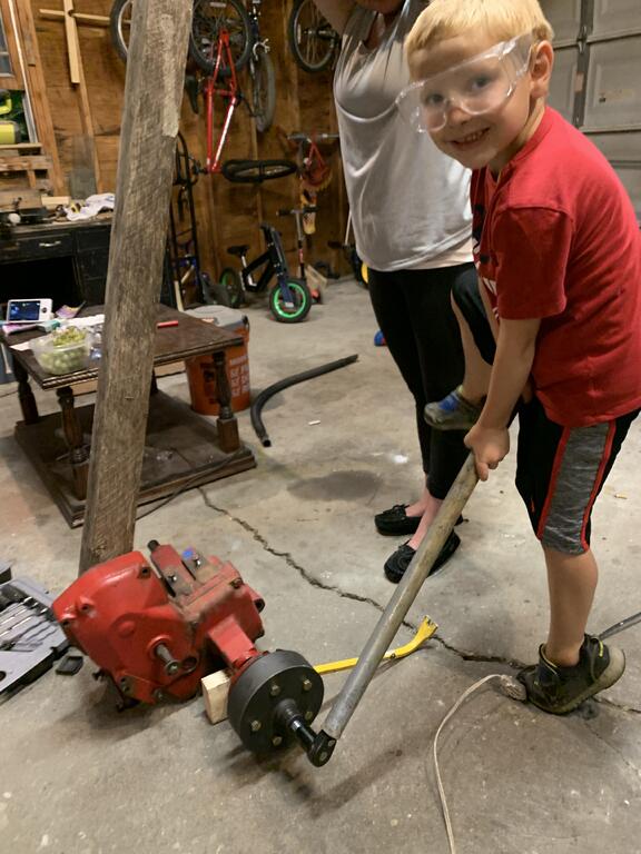

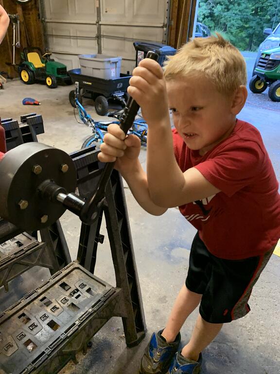

Well it took an acetylene torch a breaker bar and the entire family, but I got the hubs off. The black one slid off easily, must of been replaced recently. But the red one wouldn't pop until the bitter end. I had to dead load it to the ceiling joist. Little Sal had a blast though.

On 7/21/2020 at 9:02 PM, ebinmaine said:
hubs can be a bear to remove.
Here is an idea that works well for hub removal. Once you have the hub under tension a few hard blows along the axle part of the hub (not the flange) can be helpful.
  • Like 3
  • Thanks 1
Salbreth1
Bottle jack would have been nice. The issue was not having an immovable object to anchor the rear to. Nevertheless their off. New seals should be here next week.

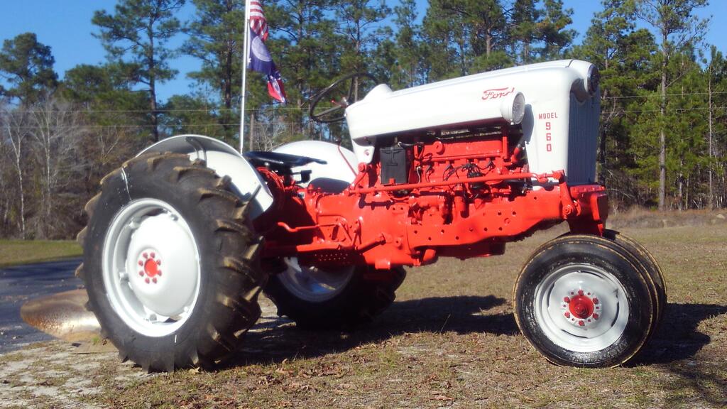

I have some experience with majic brand,never through an airless though. Just El cheapo $50 regular gun. I painted a tractor and a truck. Used generic paint thinner and then majic clear over the top. Not so great. Worked decent on tractor, honestly if it was my truck I had painted I'd redo it. But my buddy was happy with it.
 I learned some things and the last project I did I used majic again. But with the matching harderner and thinner and primer. Directions to a tee. No clear coat
 Very impressed, considering I'm not a paint guy.
I also brushed the back wheels and the paint was very forgiving in case you need to touch up or miss a piece.
  • Like 4
  • Excellent 2

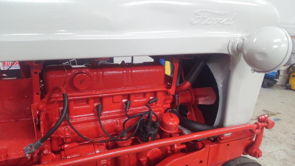

Redneckdavis
Painting tip, use thin coat of vasoline on the tires you didn't dismount. Forget the tape.
And without that harderner, the majic stuff will fade if left parked outside. Even with all the clear that first tractor and buddy's truck are not what they were.
Those colors are Ford red/safety red. And Light Ford grey( not very grey)

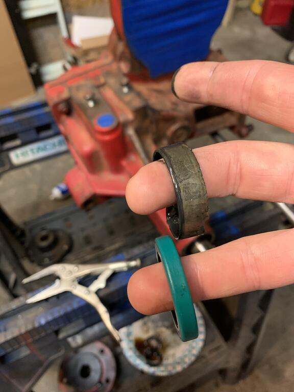

Salbreth1
Well I got the axle seals from wheelhorsepartsandmore. They are half the width of the originals. I contacted them about it and they said they will work fine. They probably will but I thought I’d check with you guys.
  • Like 1
ebinmaine
I have confidence in Lowell's knowledge.
I can see that as being an advantage if it didn't sit in the same groove as the other seal. You'd have a fresh sealing axle surface.
  • Like 2
953 nut
Here is a source for the wider ones.  Lowell's seals will probably be fine but this is what I have used.
https://www.ebay.com/itm/TORO-Wheelhorse-Axle-Seals-6449-Set-of-2pc-FREE-SHIPPING/142042768245
  • Like 1
jay bee
I had a pretty worn axle, put one on and it still leaked.  Doubled them up and it cured that problem.
  • Like 5

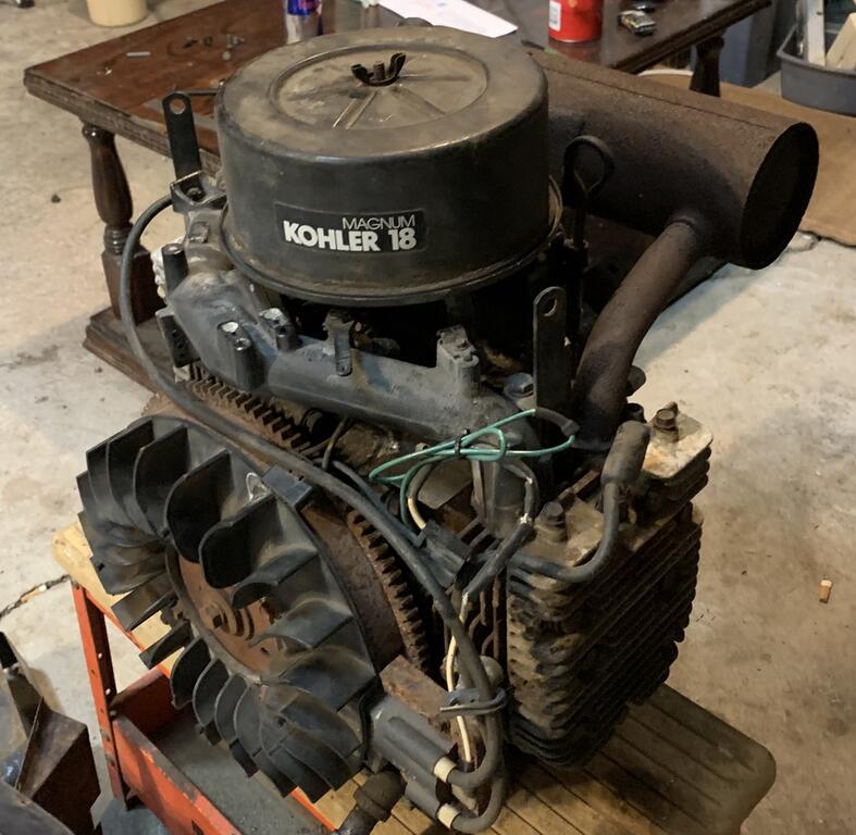

Salbreth1
Well, thanks to the previous owner I got a great deal on the original motor with all the sheet metal, wiring harness and gauges. There is 1500 hours on the meter. I havent had a minute lately but I’m anxious to bench start it! Not exactly sure how to do that either. Nevertheless I’m stoked!

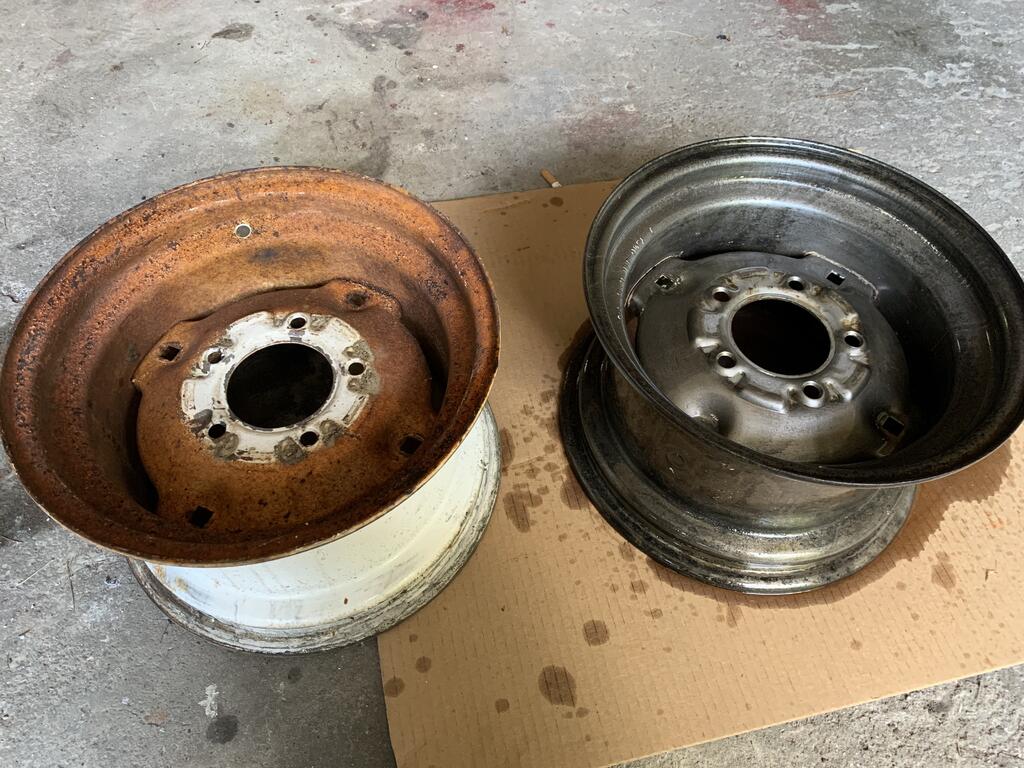

On 7/21/2020 at 2:49 PM, Salbreth1 said:
Ok, got an old school charger. 10A for 2 days and it’s good as new. Definitely a pain to wire brush the crevices but I am very happy with the result. 3 more to go.
Man, that wheel turned out great !
  • Like 2
Jeff-C175
1 minute ago, Horse Newbie said:
turned out great
Electrolysis is great!  Only downside is that black slimy 5h1t that it leaves behind that needs scrubbing to get off.
Still, better than trying to clean them up with a flapper wheel!
Only thing better would probably be blasting with the media of your choice.
