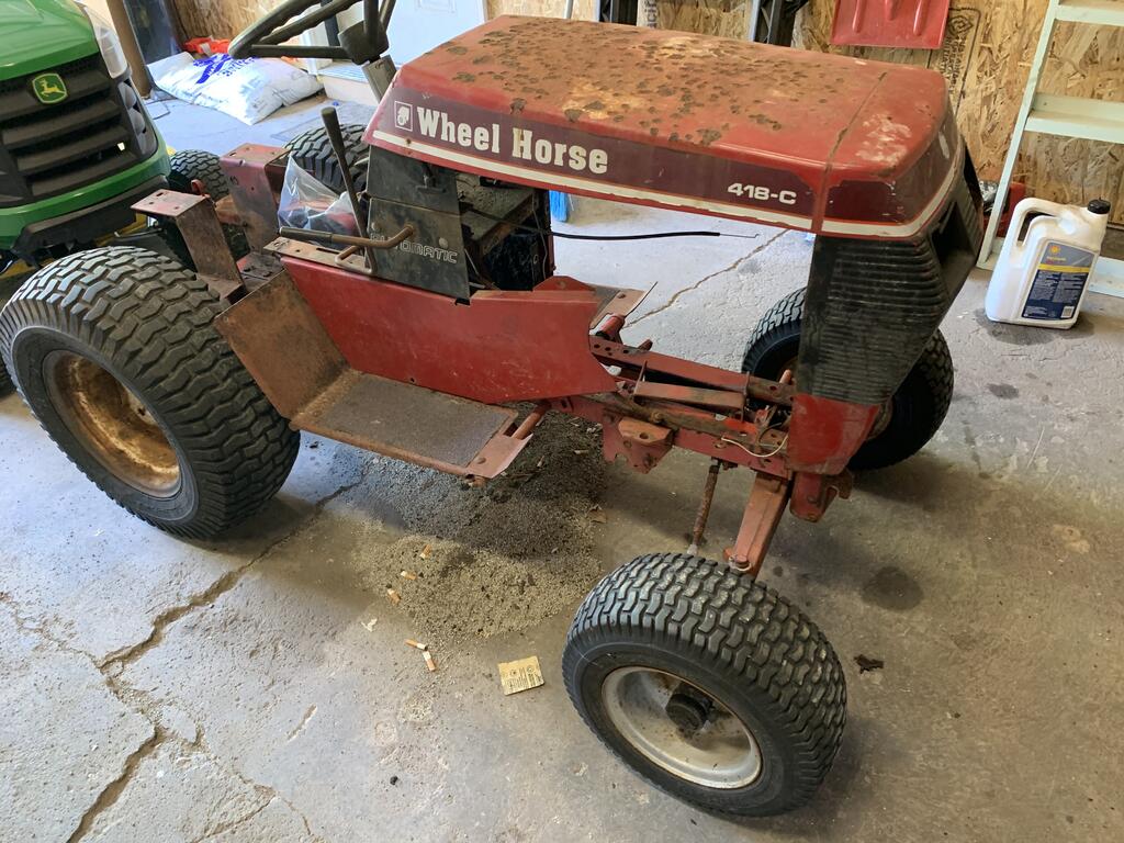

Hello guys and thanks again for the welcome! So long story short, my wife calls me and says theirs a tractor on the trash. So like any normal human I hopped in my truck and drove up to find this 418-C and a set of aluminum ramps on the side of the road. Had to be fate.
So me and my 6 year old sons new found love of tractor pulling has inspired this build. I’ve been researching everything about the model and currently have it stripped and prepping it for paint.

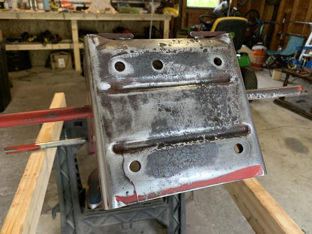

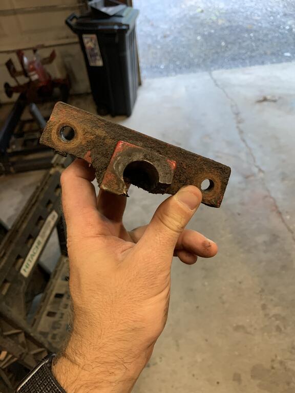

Not much progress but I found 4 nice cracks in the axle mounting plate. I’ll have to drill and fill them. Maybe weld a backer plate to it.
  • Like 3
ebinmaine
There are several threads about how to repair and reinforce the area.
Pretty common on horses with hard usage.
Salbreth1
Thank you, I found the threads. I’ll have to pick up a length of angle.
  • Like 2
  • Excellent 1
ebinmaine
OLD bedframe is good angle iron
  • Like 1

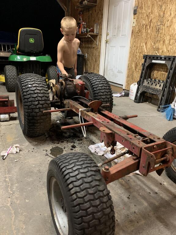

im not sure what parts I’m missing now but I’m going to take it a step at a time. First get all the bones painted and  re-assembled. I read the paint threat and of course different opinions about primers. I don’t have a sprayer but had good results with rustoleum. I’ve taken the frame down to bare metal and gave it an acetone bath. After I weld the new angles on the transmission plate I’d like to prime it and feel like got somewhere.
here’s a shot of my son while we were disassembling. He’s all about it!

Do a test cut before using bed frame angle iron, some have a high carbon content and becomes brittle next to the welded area.
Credits.
Ahhh, Mystery Metal! Fun stuff! Most bed frames made toaday are made from what Bob said - light gauge Hot Rolled steel, and they weld, cut, and drill fine. Good for non-structural stuff. BUT if you get hold of an older frame that has some weight to it and has angle that you can't twist a little bit in your hands, it's a way different story. That's the Mystery Metal stuff - and it is HARD! I don't use it for anything at all.

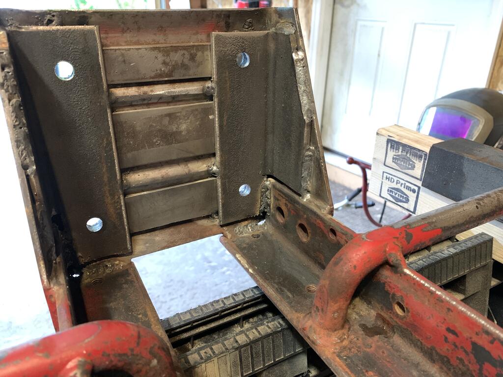

so I grabbed a piece of 2x2x3/16 mild steal and fabbed the angles. Their was a piece of 1/8” flat bar already welded at the top so I guess someone made an attempt to fix it once. I added 2 more and welded it up. Came out pretty nice.
Edited by Salbreth1
  • Like 2

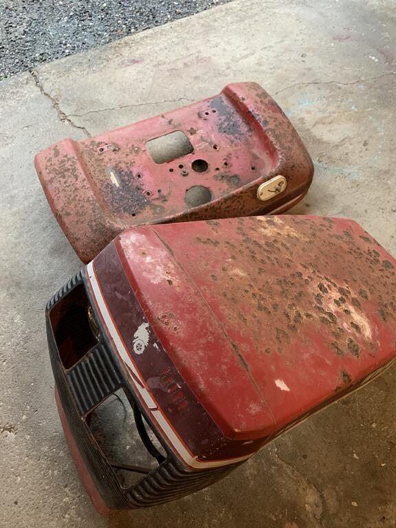

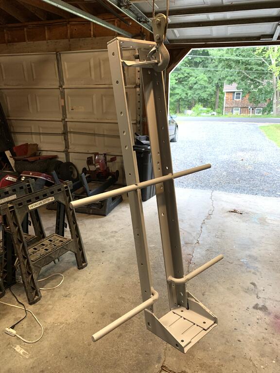

 Just celebrated my daughters 1st birthday. She was born on the forth. It was mayhem, but lots of fun. but I finally got to priming the frame. I be spraying the other parts during the week if time allows. Also had a crack in the lower steering support and had to order one off eBay. The hood and saddle are in rough shape. Not sure if I should do the body work or find a better one.
  • Like 3
ebinmaine
How much rust pitting is there?
Kind of a Time value vs money value thing.
Salbreth1
Yea, I could get lucky locally. It’s pitted pretty bad. Lots of prep and bondo. Worse than sheet rock...
ebinmaine
Might not be a bad idea to throw a want ad in our classified section.
WildmanC120
Install the 416 tower, use the steering wheel assembly with the cast dash and then use the fiberglass hood from the 161.
  • Like 1

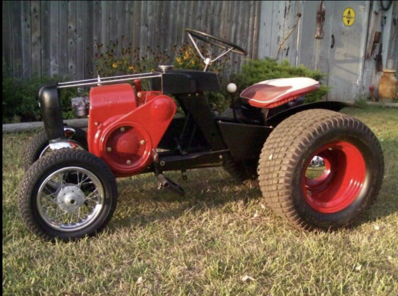

I could go custom and same some time. Maybe something like this...
  • Like 4
