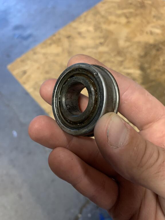

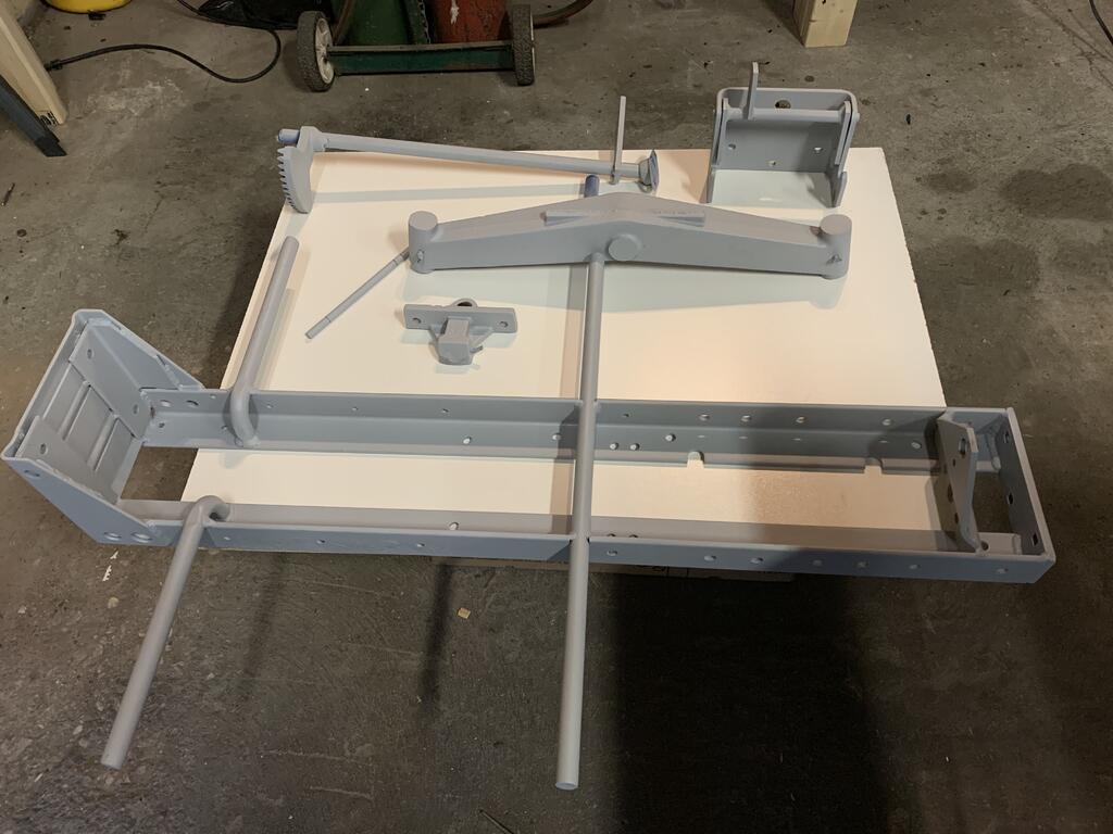

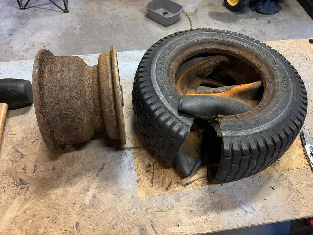

Had some time to some priming.  Im painting just what I need to get a rolling, steering chassis for now. Chiseling the grease Off of everything  has been a nightmare. The tires had a bit of moisture inside and did a number on the wheels. Wish I had a sand blaster. Also found a bad front wheel bearing. My wheels use the big flanged bearing. 1 3/4” OD, 3/4” ID. $75 each on toros site. Jeeze. I’ll see what McMaster Carr has. Bare with me, this build might take a while.

ebinmaine
That's a good idea.
Also remember to check with Lincoln at A to Z.

Thanks guys,  I’m gonna have to hit the wheels with a wire wheel but I think they will be ok. I am not looking forward to it. Then it’s time to de grease the rear. I’m hoping the axle seals are good. Nothing was leaking before I drained it but who knows once it heats up.

WildmanC120
Guess I should find out who Lincoln is at A to Z. Thanks for the source ebinmaine.
Setup a small electrolysis tank. It will do a great job breaking down the crap on the wheels and they will cleanup easier

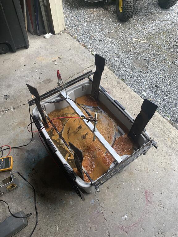

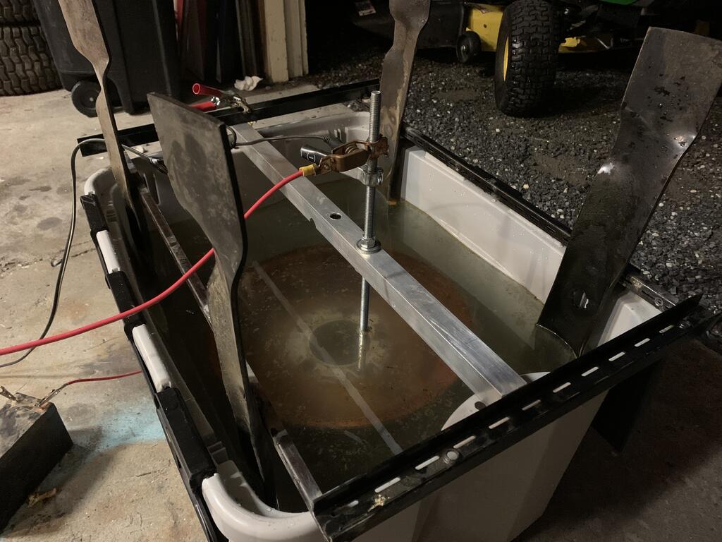

And we have electrolysis! So I sanded the paint off old mower blades and welded them up. The wheel is bolted to the all thread and suspended.
all I have is a little digital charger 1.5A. I had to put a power wheels battery in parallel to trigger it but is bubbling like hell. If it dies I have a few DC power supplies an can use.
been about 10 minutes and the water is already murky. I hate leaving things like this running at night but I have the garage open and a fan on it

Salbreth1
Making progress but gonna need a better charger. My regulated power supply is rated for 2.5A but after 10 minutes I could fry an egg on it. Actual current draw on my digital charger is 1.5A. Maybe I need more patience.

Salbreth1
Ok, got an old school charger. 10A for 2 days and it’s good as new. Definitely a pain to wire brush the crevices but I am very happy with the result. 3 more to go.

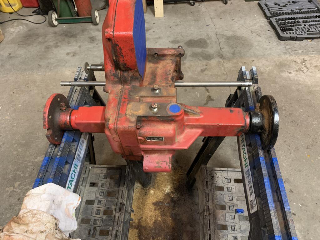

So I’m degreasing the rear and noticed a drip under the left hub. The right hub is black. Maybe it was replaced but I’m thinking I should replace the seals while it’s apart. Are these something that go? This question might be rhetorical.

ebinmaine
9 minutes ago, Salbreth1 said:
something that go
They are.
You should replace them while you're there.
Those hubs can be a bear to remove.
Check the reference section for great instructions for the process.
Do NOT use a regular puller....
Seals can be purchased through our vendor Wheelhorse parts and More, or through many other sources.
