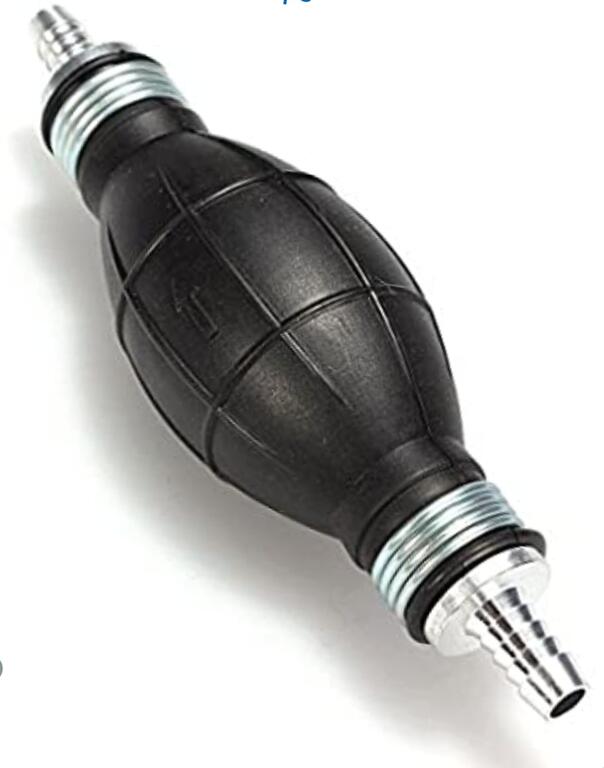

TDF5G 2,074 #14 Posted July 29, 2020 19 minutes ago, ebinmaine said: I'm not familiar with the newer horses. Is there a place to put a squeeze bulb? Yes. This was suggested to me on a facebook group. I'm thinking I might try that. Thanks 1 Share this post Link to post Share on other sites
AMC RULES 37,259 #15 Posted July 29, 2020 Just might be the ticket. 4 Share this post Link to post Share on other sites
TDF5G 2,074 #16 Posted July 29, 2020 7 minutes ago, AMC RULES said: Just might be the ticket. I was just looking at those on ebay Share this post Link to post Share on other sites
AMC RULES 37,259 #17 Posted July 29, 2020 You'll find 'em nicely priced on that jungle site too. 1 Share this post Link to post Share on other sites
TDF5G 2,074 #18 Posted July 29, 2020 (edited) 7 minutes ago, AMC RULES said: You'll find 'em nicely priced on that jungle site too. I just ordered the lowest priced one that doesn't ship from China. Edited July 29, 2020 by TDF5G 2 Share this post Link to post Share on other sites

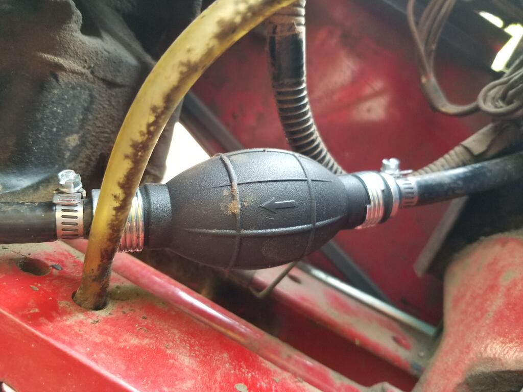

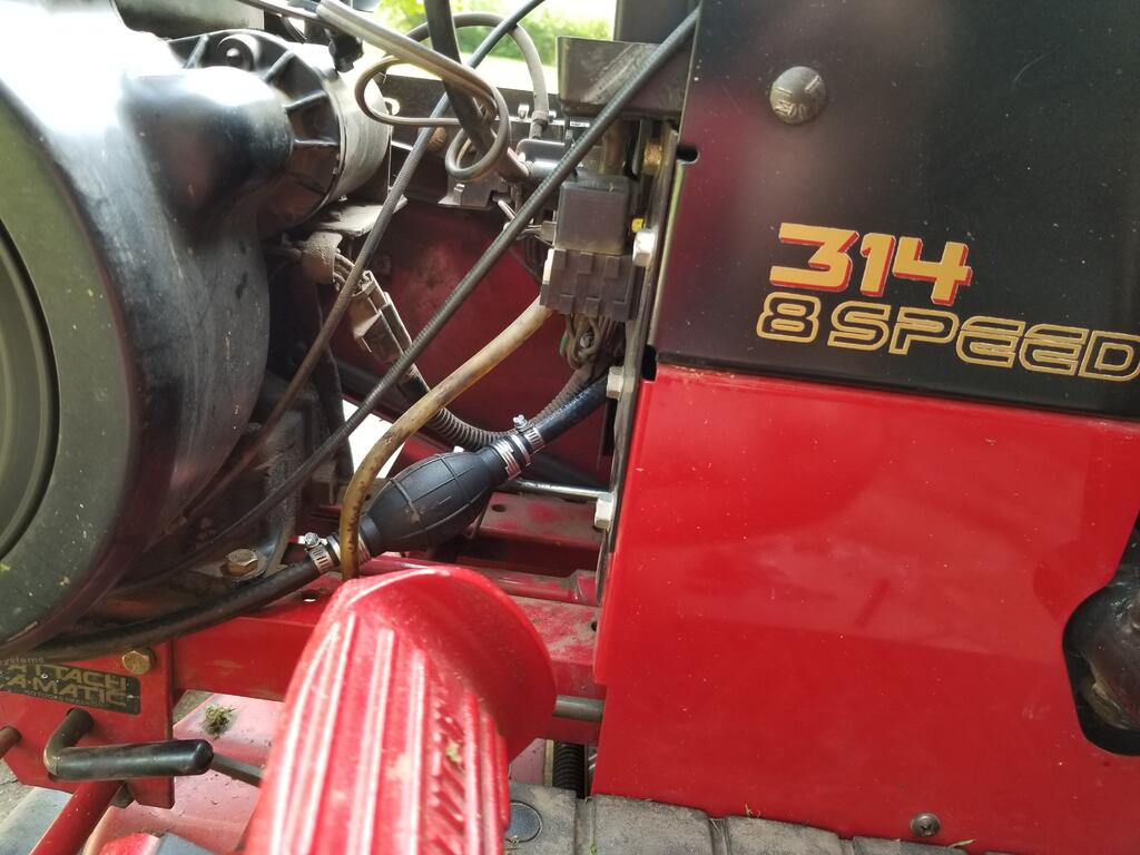

TDF5G 2,074 #25 Posted August 19, 2020 (edited) I wanted to follow up and let you all know that it seems we've found a solution to the problem. I received the primer pump a couple of weeks ago and installed it. It started right up for me. And my brother reported that it fired right up for him on Sunday. I think we are all much happier now. Thanks again for all the replies and advice. The fuel pump must not have enough suction for this set up. Edited August 31, 2020 by TDF5G 3 1 Share this post Link to post Share on other sites
