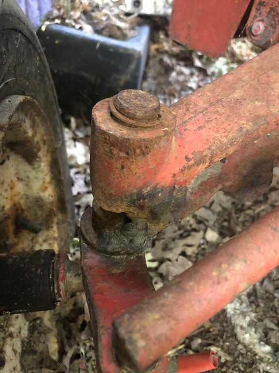

superflyoldtractorguy 23 #1 Posted June 23, 2020 (edited) I need to replace my C-125 Front axle (broken casting) - what swaps work? Decent prices on eBay, some complete with spindles & some steering parts. (212-H or 210-H Lawn tractor Cast iron front steering axle 114385 - good prices shipped) Any help here is really appreciated. And yes, I have used the Search function for more than a couple hours. Thanks in advance Further image review shows 210/212-H axles are flat Edited June 23, 2020 by superflyoldtractorguy Share this post Link to post Share on other sites
rjg854 13,422 #2 Posted June 23, 2020 I replaced my C-160 front axle with one from a 1968 Commando 8, tie-rods and all, just happened to be the same part number. 1 Share this post Link to post Share on other sites
ebinmaine 81,150 #3 Posted June 23, 2020 Could you show some pictures of exactly what part is broken? These axle beams are not known for breakage. I was just wondering if it was a spindle or something.... Share this post Link to post Share on other sites
meadowfield 3,204 #5 Posted June 23, 2020 I've seen one cracked where the spindles pass through. Pretty well anything from 1967-1990 will fit as they are almost the same - well the ones I have are Share this post Link to post Share on other sites
squonk 48,339 #6 Posted June 23, 2020 3 hours ago, superflyoldtractorguy said: I need to replace my C-125 Front axle (broken casting) - what swaps work? Decent prices on eBay, some complete with spindles & some steering parts. (212-H or 210-H Lawn tractor Cast iron front steering axle 114385 - good prices shipped) Any help here is really appreciated. And yes, I have used the Search function for more than a couple hours. Thanks in advance Further image review shows 210/212-H axles are flat Those 200 series axles will not work. Pretty much any axle from a horizontal engine model will 1 1 Share this post Link to post Share on other sites
oliver2-44 11,825 #7 Posted June 23, 2020 Since you have to buy and axle, you could go all and upgrade to an axle from a 520 and the gear reduction steering. The whole used assembly usually sells for around $300 1 Share this post Link to post Share on other sites

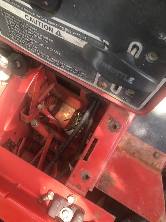

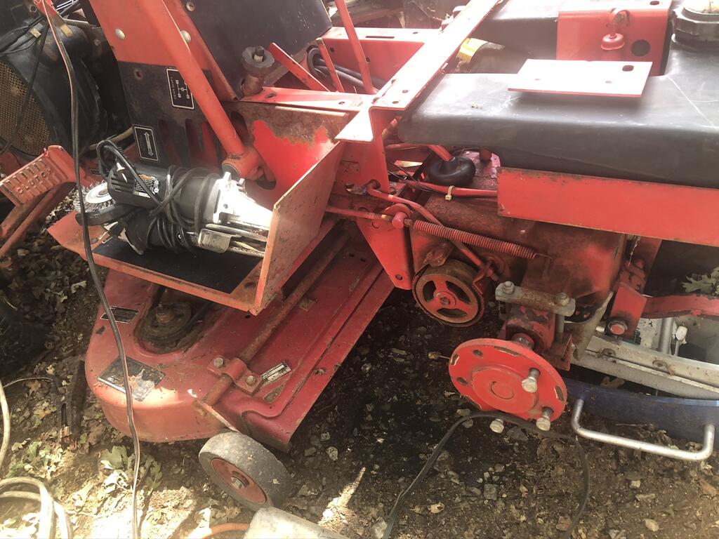

superflyoldtractorguy 23 #8 Posted June 23, 2020 (edited) Yes, broke off chunk at spindle & rewelded up. kinda goofy repair. She's (boy or girl?) really in good shape compared to the usual junk I get. Took apart to blow the mouse nests out & look for interlocks shown on diagrams - this one has a clutch switch & a PTO switch. Got a new battery, cleaned the ignition switch & am tracking down the wires. Somebody has done a really nice job of rewiring but they used the same color. need to find all the grease points before starting it. Motor looks to be in good shape, belts look pretty good. Plastic fender/seat pan is pretty cracked - they threw in a metal one which I'll mount up. Once I get the new rear tires on (fronts kinda hold air) then I'll put back together & work on getting her started up. Edited June 23, 2020 by superflyoldtractorguy 2 1 Share this post Link to post Share on other sites

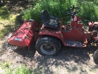

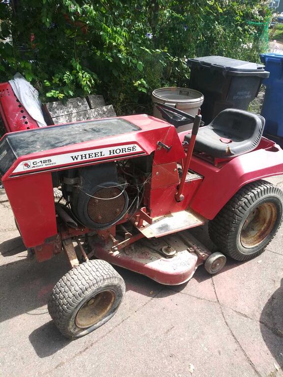

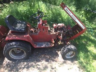

superflyoldtractorguy 23 #9 Posted June 23, 2020 I got a C-81 from the original owner recently which made me a Wheel Horse man. It came with a rototiller n front blade, which is why I started looking for a deck, the C-125 is a result of looking for a deck. I'll wait til their both side by side before making a decision on which to keep. C-81 or C-125 - which would anyone keep? 2 Share this post Link to post Share on other sites
ebinmaine 81,150 #10 Posted June 23, 2020 2 minutes ago, superflyoldtractorguy said: which would anyone keep? BOTH If you absolutely have to choose between one or the other I would lean towards the 125 but only because he would give you the extra horsepower for rototilling and mowing 1 1 Share this post Link to post Share on other sites
superflyoldtractorguy 23 #11 Posted June 23, 2020 13 minutes ago, ebinmaine said: BOTH If you absolutely have to choose between one or the other I would lean towards the 125 but only because he would give you the extra horsepower for rototilling and mowing I hear ya - Would it be sacrilege to backdate the 125 with the 81 sheetmetal? Or move the 12hp to the 8hp engine bay? 1 1 Share this post Link to post Share on other sites
ebinmaine 81,150 #12 Posted June 23, 2020 58 minutes ago, superflyoldtractorguy said: I hear ya - Would it be sacrilege to backdate the 125 with the 81 sheetmetal? Or move the 12hp to the 8hp engine bay? All of the horses in our herd at home are older ones than those two generations so I'm not really sure what it would entail. If what you need is an axle to get that 125 back up and running and you wanted to keep both there's probably a bunch of us that have spares. I've got at least a couple in the parts pile myself. Have to figure out how to get it from Maine to wherever you are. 1 Share this post Link to post Share on other sites
superflyoldtractorguy 23 #13 Posted June 23, 2020 Thanks - eBay is the way. I have an axle and but repair seems to be ok but getting a complete one with spindles would be nice. I'll prob keep the best axle & switch the other - I want to be able to sell off the extra running n operable. Other side of the country - Bay Area - can't believe I found TWO Wheely's with attachments out here. And C models to boot. I was looking for a Wards 16 hydro but the attachments win - I think the manual Wheely's will be fine. I've been thru 4 LT's (big Lawn for Cali but nothing like the back east folks have) in the last 20yrs, got sick of fixing them to only break again. 2 Share this post Link to post Share on other sites

superflyoldtractorguy 23 #23 Posted June 29, 2020 On 6/23/2020 at 2:53 AM, ebinmaine said: Could you show some pictures of exactly what part is broken? These axle beams are not known for breakage. I was just wondering if it was a spindle or something.... 1 2 Share this post Link to post Share on other sites
ebinmaine 81,150 #24 Posted June 29, 2020 Boy. Ain't that something. Share this post Link to post Share on other sites
SylvanLakeWH 32,823 #25 Posted June 29, 2020 1 hour ago, ebinmaine said: Boy. Ain't that something. Yeah that is weird... Not something you see every day... And @superflyoldtractorguy!!! 1 Share this post Link to post Share on other sites
