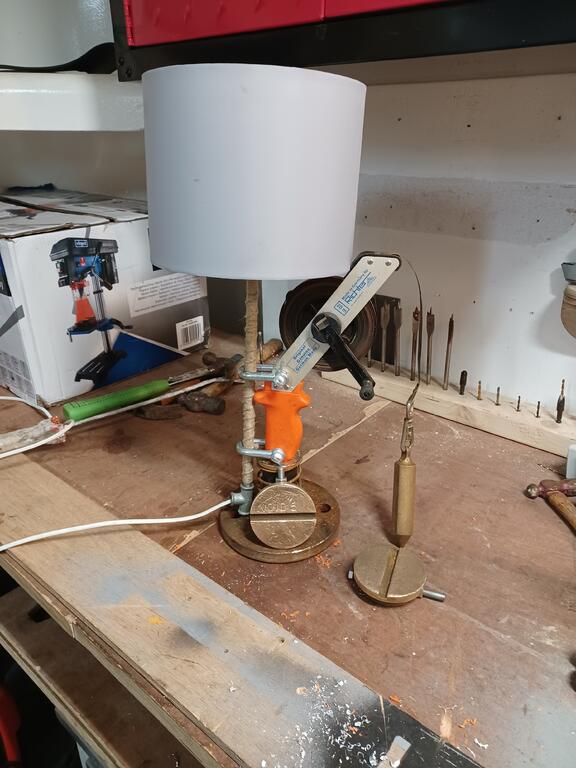

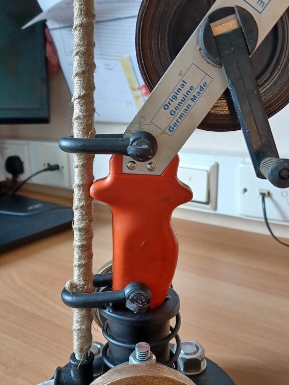

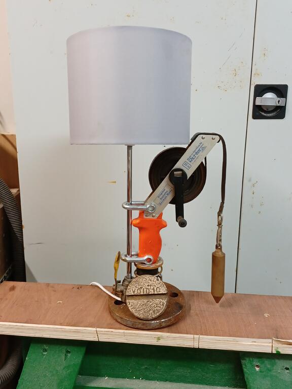

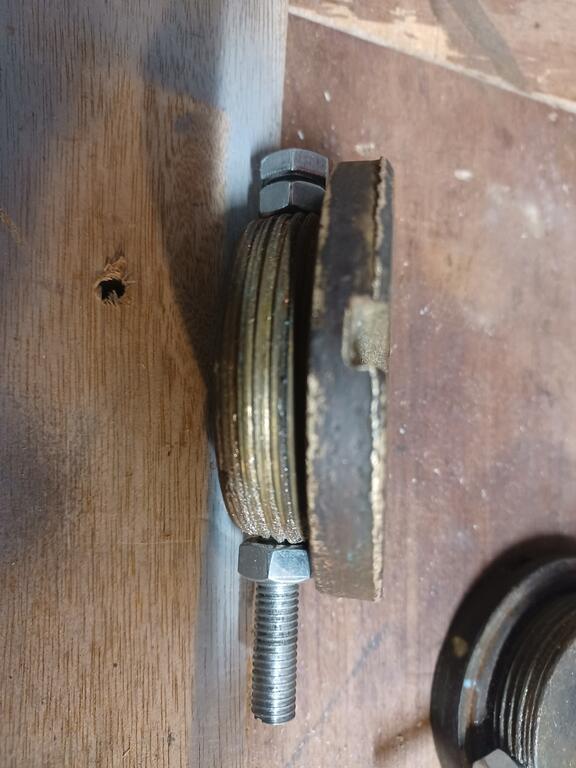

Dan.gerous 2,696 #101 Posted May 7, 2022 It's coming together now - only mocked up on the bench and lots more detail to come. I even got a sounding pipe cap with a label on it - must be an original from when she was built. Not sure exactly how the brass cap will be mounted to the steel base. Braze it maybe? Don't even know how to do that yet.... 5 Share this post Link to post Share on other sites
ebinmaine 81,012 #102 Posted May 8, 2022 2 hours ago, Dan.gerous said: Not sure exactly how the brass cap will be mounted to the steel base. Braze it maybe? Don't even know how to do that yet I haven't tried brazing yet. I understand it's easier to pick up than welding. Do have a substance like J. B. Weld? 1 Share this post Link to post Share on other sites
Dan.gerous 2,696 #103 Posted May 8, 2022 5 hours ago, ebinmaine said: I haven't tried brazing yet. I understand it's easier to pick up than welding. Do have a substance like J. B. Weld? We do have something onboard that's probably the same thing. I was thinking of tapping a threaded bar into the brass, then welding the bar to the flange. Major issue is the amount of permits and nonsense to be able to weld on here, not like home where you just fire the machine up! 1 Share this post Link to post Share on other sites
lynnmor 9,055 #104 Posted May 8, 2022 Why not just run a screw up thru the base and into the cap? It would be hidden from view, and keep people guessing. That shiny lamp post is just begging for a galvanized pipe to cover it. 1 1 Share this post Link to post Share on other sites

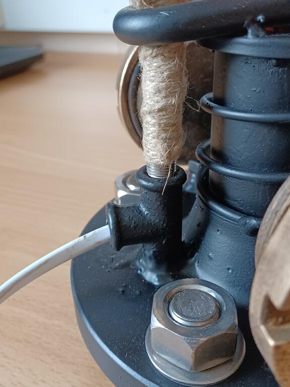

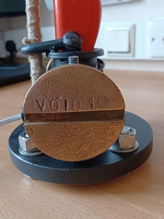

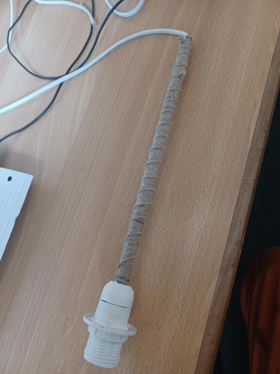

Dan.gerous 2,696 #105 Posted May 9, 2022 On 5/8/2022 at 2:10 PM, lynnmor said: Why not just run a screw up thru the base and into the cap? It would be hidden from view, and keep people guessing. That shiny lamp post is just begging for a galvanized pipe to cover it. Great minds, only just saw this thread and have done something similar. Drilled up through the plug, then going to weld the bolts to the flange. Once painted can bolt the brass plugs on The shiny steel shaft now has some subtle ropework on it. phew, was losing sleep thinking about a neat solution! 2 Share this post Link to post Share on other sites
Dan.gerous 2,696 #106 Posted May 9, 2022 Also liked the galvanised pipe idea so will incorporate a bit to keep the cable tidy - just tack it on with the welder. Ready to stick it together tomorrow, and paint. Then just need to do some artwork for the lamp shade. 3 Share this post Link to post Share on other sites

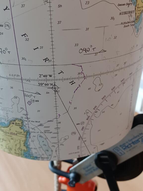

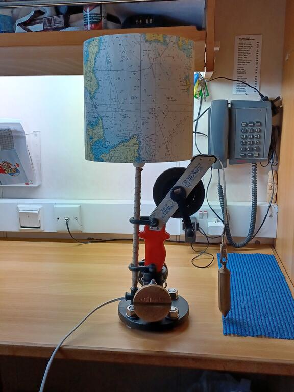

Dan.gerous 2,696 #107 Posted May 13, 2022 Basically finished. The chart is one that was actually in use and even has our pencilled in course lines and hand written notes It's also the guys home port. Looks a lot better in the flesh, will give it to him tomorrow. 2 6 Share this post Link to post Share on other sites

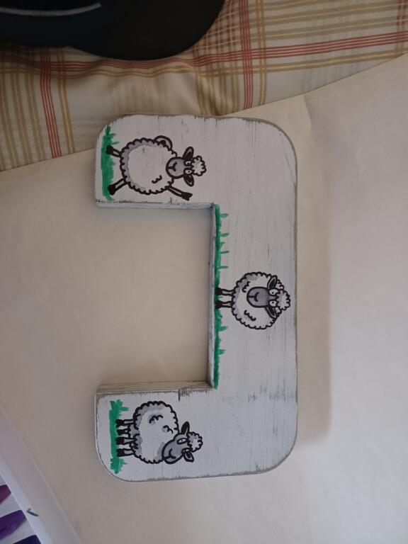

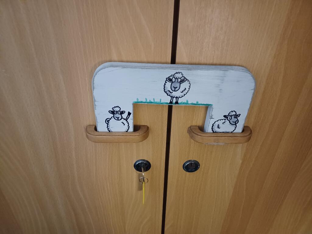

Dan.gerous 2,696 #108 Posted May 13, 2022 So a quick side project to make a wardrobe door holder for one of the cabins. Stops the doors flying open when the ship rolls. The lady who's cabin it is in is also a farmer on a small island in Shetland so the sheep was a personal touch. 2 4 Share this post Link to post Share on other sites

Dan.gerous 2,696 #112 Posted May 13, 2022 Some of the gory detail if your interested! 1 2 1 Share this post Link to post Share on other sites

Handy Don 17,606 #114 Posted May 13, 2022 9 hours ago, Dan.gerous said: farmer on a small island in Shetland so the sheep was a personal touch Did she get to take it home as a souvenir of the trip? 1 Share this post Link to post Share on other sites
Dan.gerous 2,696 #115 Posted May 13, 2022 24 minutes ago, Handy Don said: Did she get to take it home as a souvenir of the trip? No she works here full time and it's to stop the wardrobe doors opening. The lamp is a gift to go home for the guy that's leaving. Share this post Link to post Share on other sites

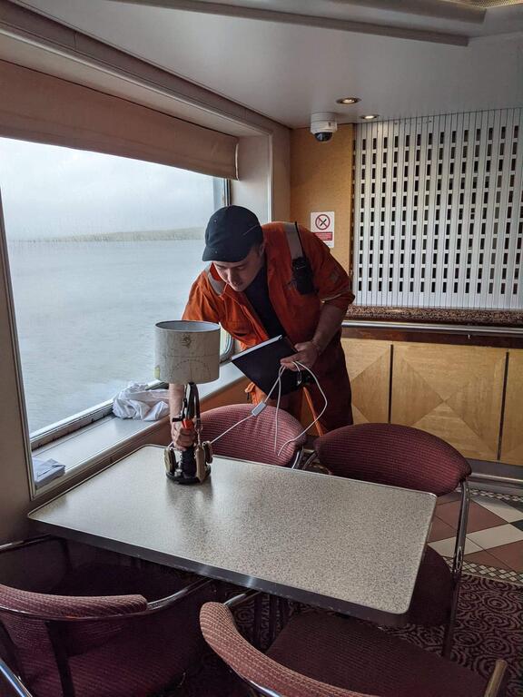

Dan.gerous 2,696 #116 Posted May 14, 2022 Mission accomplished, got a good few laughs. Can relax now. 6 Share this post Link to post Share on other sites

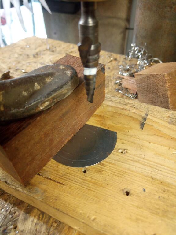

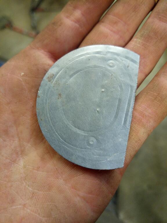

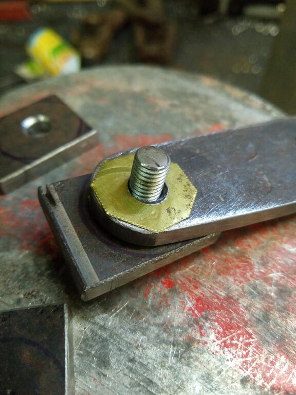

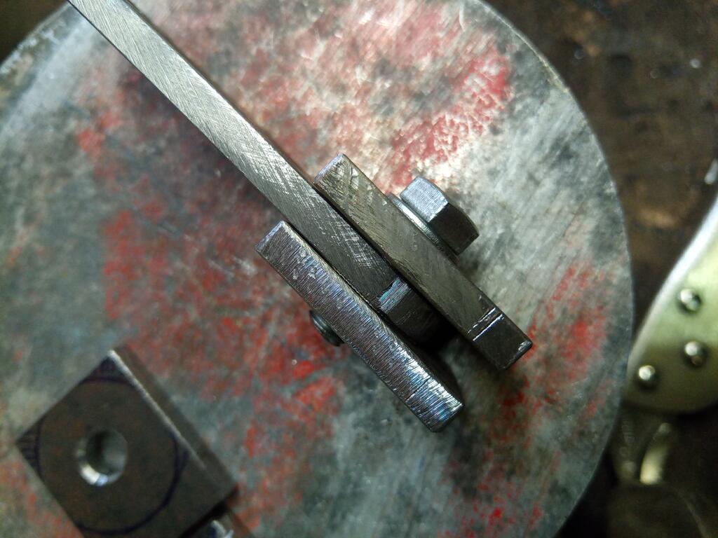

sjoemie himself 3,259 #117 Posted May 18, 2022 (edited) Needed some shimstock as spacer and didn't have anything on the shelf so I made some out of the lid of canned corn. Flattened it with a hammer and dolley, drilled some holes, cut to size, et voilá spacers NOTE: wear gloves! This stuff is razorsharp. Edited May 18, 2022 by sjoemie himself Added photo 2 1 Share this post Link to post Share on other sites
Dan.gerous 2,696 #118 Posted May 18, 2022 (edited) 1 hour ago, sjoemie himself said: Needed some shimstock as spacer and didn't have anything on the shelf so I made some out of the lid of canned corn. Flattened it with a hammer and dolley, drilled some holes, cut to size, et voilá spacers NOTE: wear gloves! This stuff is razorsharp. Its incredibly sharp! I once made a model "Anderson Shelter" out of one for a school project and it was lethal! Nice use of something that most people wouldn't even consider as useful. The shelter was a simple air raid shelter in ww2 that people installed in their back yards, you see them come up for sale quite often. Edited May 18, 2022 by Dan.gerous 1 Share this post Link to post Share on other sites
sjoemie himself 3,259 #119 Posted May 18, 2022 2 hours ago, Dan.gerous said: Anderson Shelter Never heard of that but looked it up on Giggle. Nice and simple design while being quite functional by the looks of it. About my shimstock I should note that I only used it for welding some parts together. The shims prevented the hinge from getting tight because of shrinking caused by welding. Removed them after welding and ended up with a nice free moving hinge. 3 Share this post Link to post Share on other sites
Dan.gerous 2,696 #120 Posted May 18, 2022 19 minutes ago, sjoemie himself said: Never heard of that but looked it up on Giggle. Nice and simple design while being quite functional by the looks of it. About my shimstock I should note that I only used it for welding some parts together. The shims prevented the hinge from getting tight because of shrinking caused by welding. Removed them after welding and ended up with a nice free moving hinge. Good tip, dealing with metal movement is something I am slowly learning - so many simple tricks to help. 2 Share this post Link to post Share on other sites

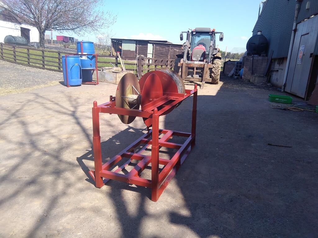

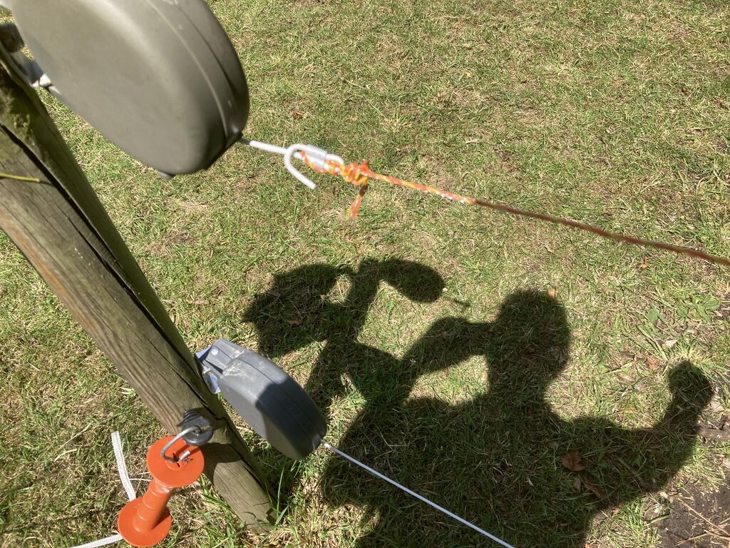

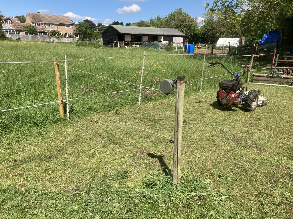

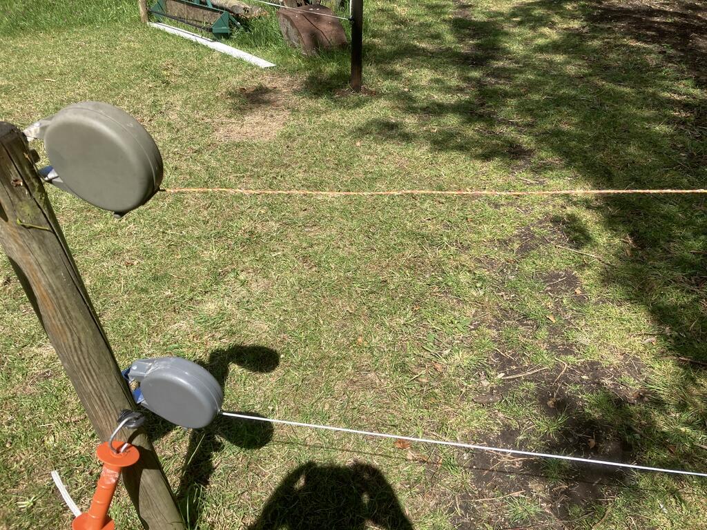

ranger 1,862 #122 Posted May 18, 2022 On 4/24/2021 at 8:03 PM, Dan.gerous said: Getting braver with the welder. It's made out of an old basket of some sort that had a three point linkage on it, which I cut off. The orange handle is from my ship, it used to be part of our old lifeboats that have been replaced. Forgot to mention, it's for the electric fence wire. I forget how much we use but it's miles and miles and miles.... We don’t use that much electric fencing around the horse paddocks, but for retractable ’Gates’ we use the retractable clothes lines from ‘Wilco’s’. After pulling out the plastic covered cord, I cut electric fence wire the same length, cut the original and splice the wire in it’s place. Clothes line is about £3.00-£4.00, retractable electric fencing gates are around 10x this. 2 Share this post Link to post Share on other sites

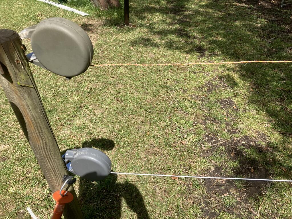

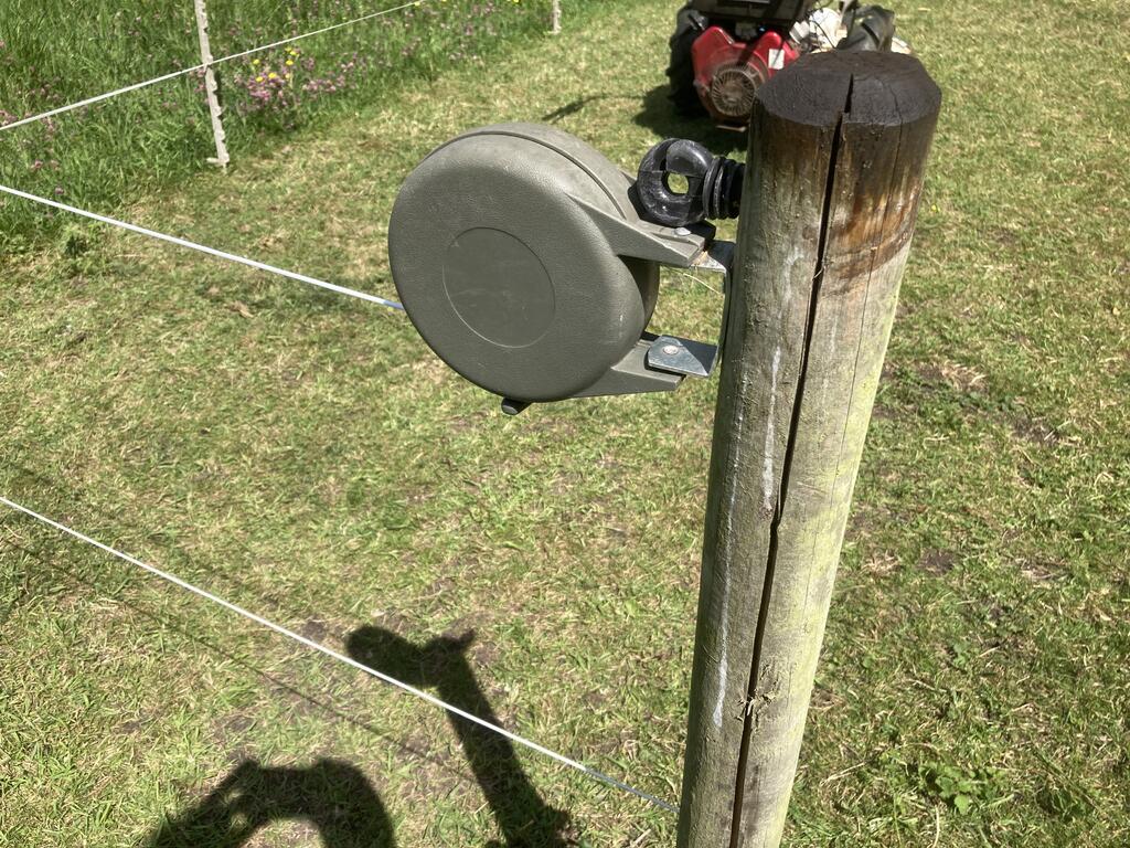

Dan.gerous 2,696 #123 Posted May 19, 2022 1 hour ago, ranger said: We don’t use that much electric fencing around the horse paddocks, but for retractable ’Gates’ we use the retractable clothes lines from ‘Wilco’s’. After pulling out the plastic covered cord, I cut electric fence wire the same length, cut the original and splice the wire in it’s place. Clothes line is about £3.00-£4.00, retractable electric fencing gates are around 10x this. That's a brilliant idea, gates are such an expensive item. We have about 250 of them, so it's quite an investment, although ours are the spring type. The clothes line reel would be good for adding removable sections of fencing larger than our 4m gates. Share this post Link to post Share on other sites

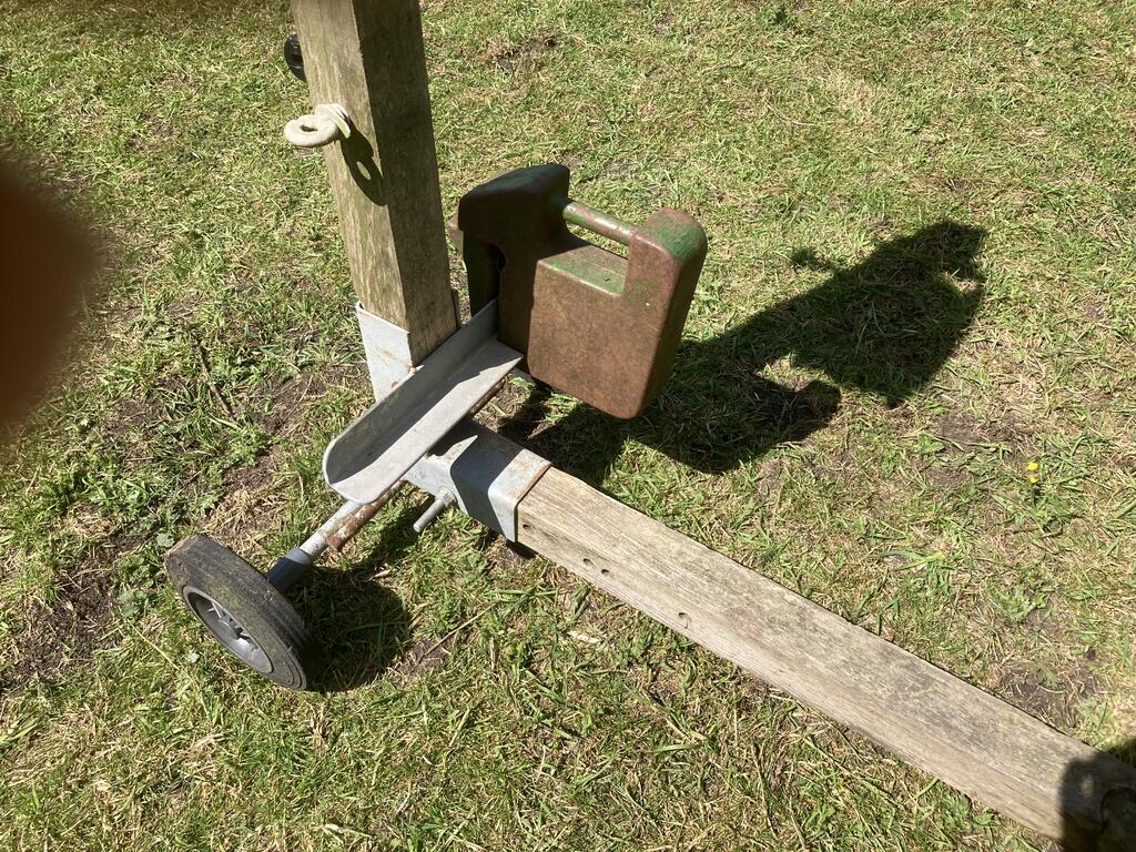

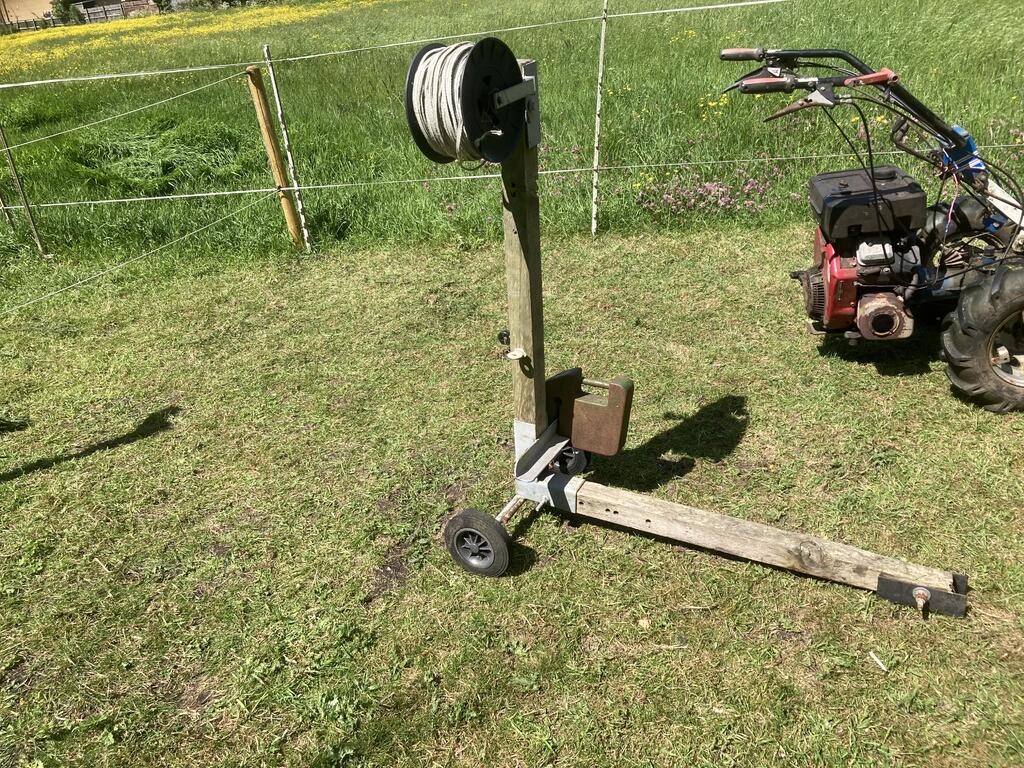

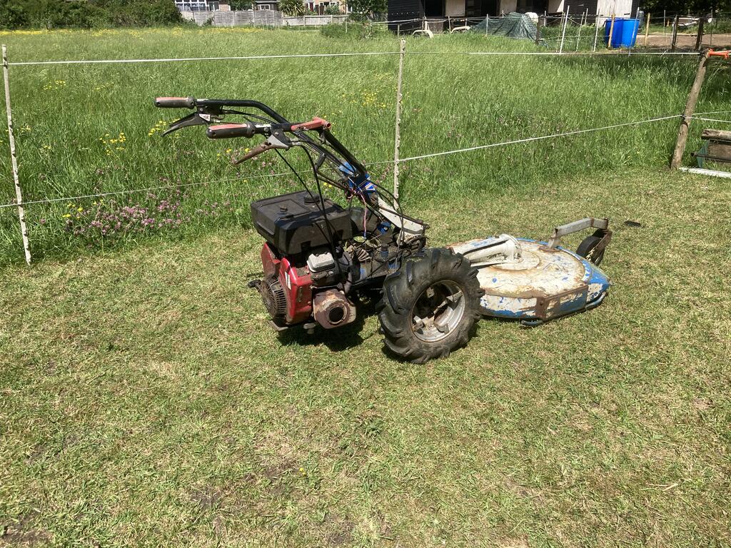

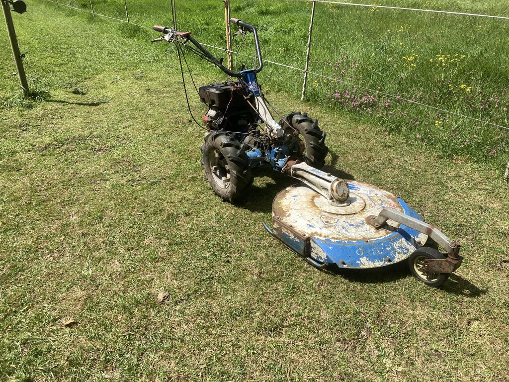

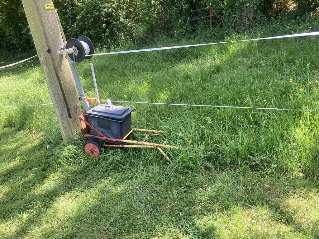

ranger 1,862 #124 Posted May 19, 2022 15 hours ago, Dan.gerous said: That's a brilliant idea, gates are such an expensive item. We have about 250 of them, so it's quite an investment, although ours are the spring type. The clothes line reel would be good for adding removable sections of fencing larger than our 4m gates. Just a few pics of the original and converted reels, also my temporary fencing trolley, which found a use for a ‘green’ tractor suitcase weight. Oh, and sneaking into the photos, one of my B.C.S. Machines, 16hp Briggs Vee twin, 30” mulching deck. This thing will cut down virtually anything, even small saplings. My other one has a 4” wood chipper attachment mounted to it. 4 Share this post Link to post Share on other sites
