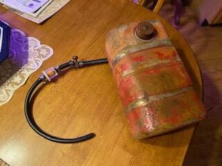

johnnymag3 2,646 #30 Posted June 22, 2020 Going down to the Corral to connect a gravity feed to the 310....if problem exists, then its electrical. I tried 3 Carbs, with same results....Tank is clean, lines are new, filter changed last night again, ran the same with no filter....what a fussy Horse. !! Will follow up after fuel experiment with external gas tank going into carb. Throttle bushings are tight, also the carb im using is from a perfect running 312. Thanks everyone !! 1 Share this post Link to post Share on other sites

johnnymag3 2,646 #33 Posted June 22, 2020 ok,,,,,,,so I did the external tank, with shut off, and new filter.................... Same thing happens... It acted up in less than 2 min. Time to rethink this crazy Horse... Share this post Link to post Share on other sites
