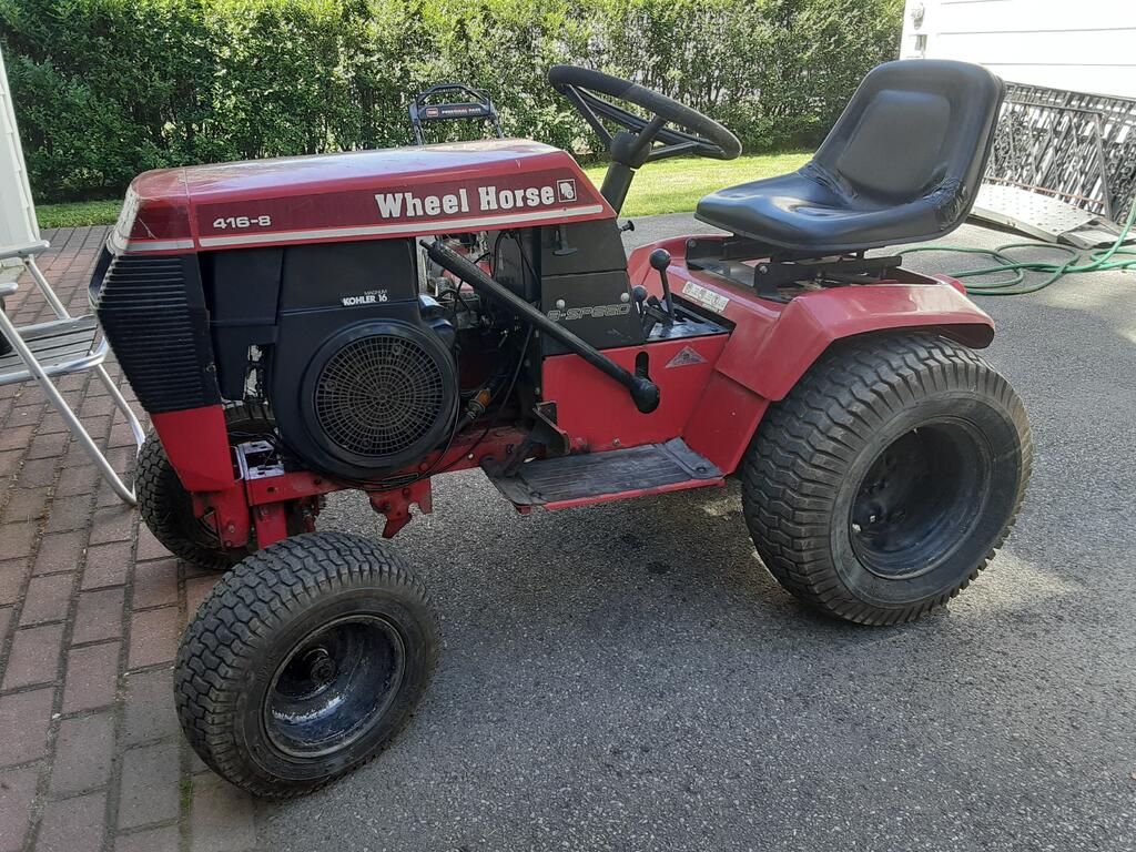

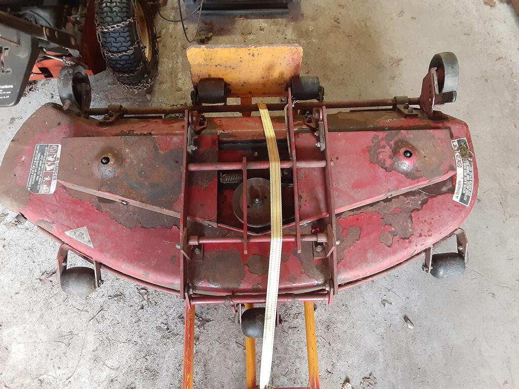

D_Mac 9,339 #6 Posted June 21, 2020 By the time you buy the engine and the deck I think you can get a complete tractor. I just recently purchased a 416-8 with a 48 inch deck for about what you would pay for an engine and a deck. 2 Horses are better then 1 is the standard answer you will find here. 3 1 Share this post Link to post Share on other sites
