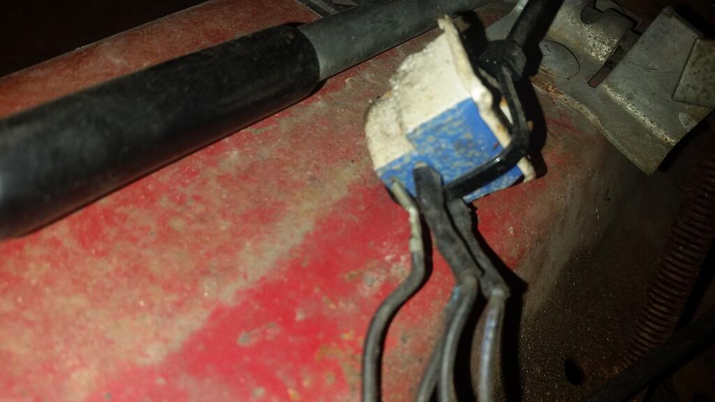

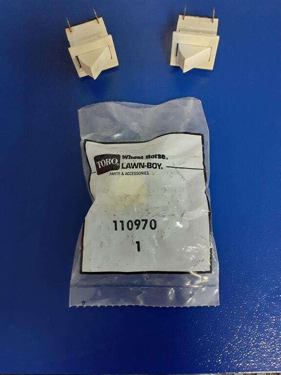

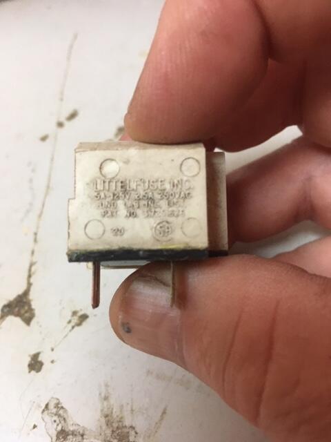

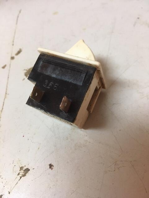

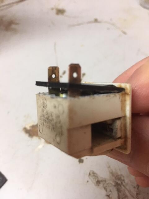

JCM 11,342 #1 Posted June 19, 2020 What do you guy's use to replace Part # 110970 for both 8 speed and hydro tractors that is NLA from Toro. Left hand side cover above footrest. Markings on original are Littlefuse Inc Thanks Share this post Link to post Share on other sites
WHX?? 57,644 #2 Posted June 19, 2020 Would I have one on the parts 520 Plunger? Put up a pic of it. Share this post Link to post Share on other sites

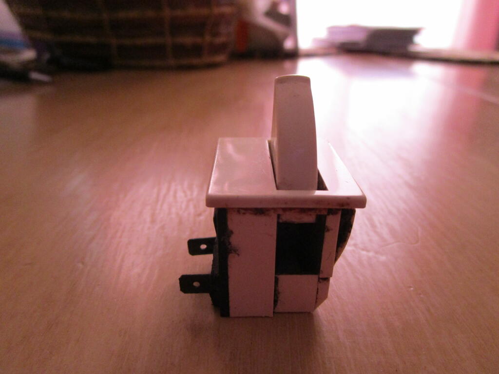

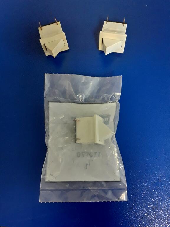

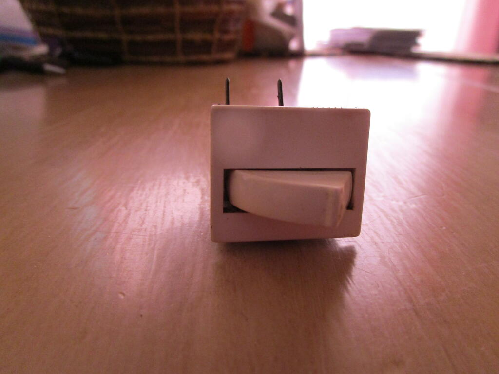

JCM 11,342 #3 Posted June 19, 2020 (edited) You do have a switch but it is a # 115230 . Pics of the one I need. 2nd pic is how it sits through the tunnel when mounted Thanks Jim Edited June 19, 2020 by JCM Share this post Link to post Share on other sites

gwest_ca-(File Mod) 12,416 #5 Posted June 19, 2020 How is the 110970 different than the 103480? Garry 1 Share this post Link to post Share on other sites
JCM 11,342 #6 Posted June 19, 2020 I do not have the answer for that, all of my 3&400 series use the # 110970. Thanks Gary Share this post Link to post Share on other sites
gwest_ca-(File Mod) 12,416 #7 Posted June 19, 2020 You saw the EMB link? Both should be normally open switches. I wonder if a change in suppliers caused the part number change? Garry 1 Share this post Link to post Share on other sites
JCM 11,342 #8 Posted June 20, 2020 Thanks again Garry, if those will work on the 3 & 400 series and could locate a supplier I would stock up on them, I prefer to keep all safety switches in place. Share this post Link to post Share on other sites

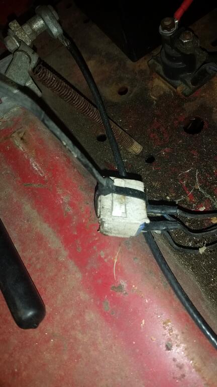

WHX?? 57,644 #9 Posted June 20, 2020 Hey I got one on the flying A Plunge... send it to ya if I can finger out how to permanently bypass it . Ain't doing any good ty-wrapped closed like this. Supposed to be the safety switch on the deck lever. @squonkmight know of a source? I called it the refrigerator door light switch! 3 Share this post Link to post Share on other sites
squonk 47,745 #10 Posted June 20, 2020 9 hours ago, WHX24 said: Hey I got one on the flying A Plunge... send it to ya if I can finger out how to permanently bypass it . Ain't doing any good ty-wrapped closed like this. Supposed to be the safety switch on the deck lever. @squonkmight know of a source? I called it the refrigerator door light switch! @WHX24 get yer meter out and figure out what does what. Or did you have to sell it to pay for that paint on Cindy's tractor? 1 Share this post Link to post Share on other sites

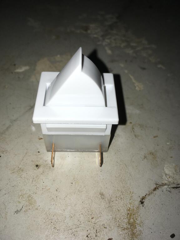

Bill D 3,063 #14 Posted June 24, 2020 A member here told me that is a switch for a fridge door. It should still be available. I have seen some on eBay. Share this post Link to post Share on other sites

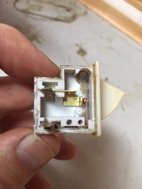

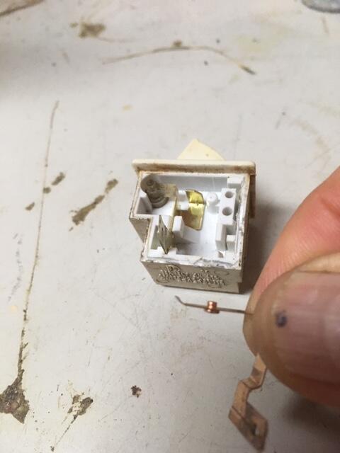

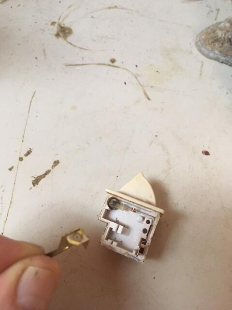

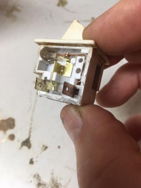

biged77 113 #15 Posted June 24, 2020 Trouble is most if not all refrigerator door switches are Normally Closed so they won't work. I checked Ebay and Amazon and couldn't find any Normally Open ones. But you can fix the old one by disassembling and cleaning the contact surfaces with an emery board or other. The cap is glued on, just use a carpet knife and work around the outside until it pops off. Glue back on when through. Note: I tried this as a last resort when I couldn't find a replacement switch. Was surprised when it actually worked. 2 1 Share this post Link to post Share on other sites
lynnmor 8,970 #16 Posted June 24, 2020 Could you folks use a refrigeration fan switch that is normally open? Fan Switch The light switch is normally closed. Light Switch 1 1 Share this post Link to post Share on other sites
squonk 47,745 #17 Posted June 24, 2020 33 minutes ago, lynnmor said: Could you folks use a refrigeration fan switch that is normally open? Fan Switch The light switch is normally closed. Light Switch Fan switch should work. 1 Share this post Link to post Share on other sites

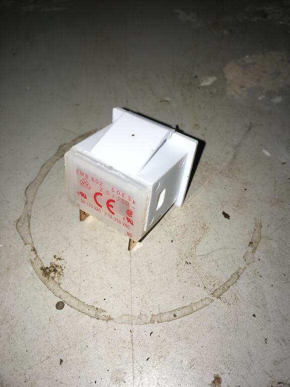

biged77 113 #20 Posted June 29, 2020 I bought a Subzero refrigerator fan switch 7014651 off of Amazon https://www.amazon.com/gp/product/B07RZ91GW3/ref=ppx_yo_dt_b_asin_title_o00_s00?ie=UTF8&psc=1 It's a normally open switch and should work just fine as a substitute for my 416-8 clutch neutral switch. Cost was $11.29. I'm keeping as a spare. The switch is marked as an EMB602. Share this post Link to post Share on other sites
