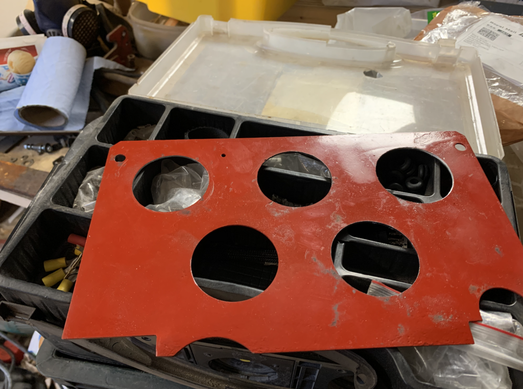

meadowfield 3,204 #1 Posted June 18, 2020 inspired by 1970's Peterbilts and the fact I like to know whats going on... I was wondering what gauges you guys had retrofitted? I've drilled the panel ready I don't think you can have too many gauges dry run - so ignore the panel being reversed - plus theres a bit of metal behind that needs some surgery... Duplicate temp gauge soon to be fuel gauge. Might add a few switches, lights and Fuses for maximum effect. 5 2 1 1 2 Share this post Link to post Share on other sites

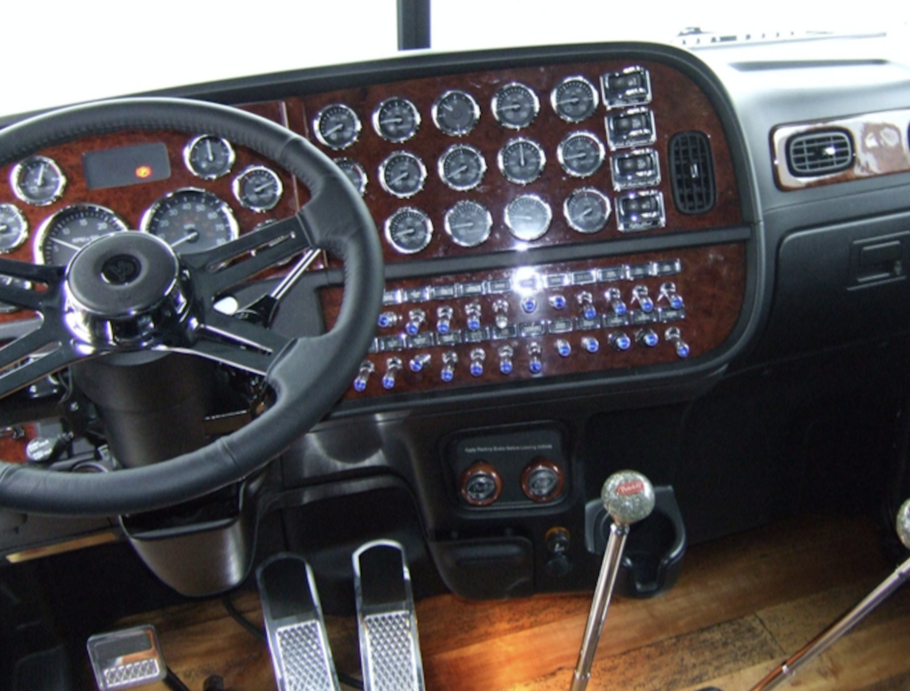

Tractorhead 9,218 #6 Posted June 18, 2020 I don‘t like too much infos nobody needs or even the mickeymouse tv dashboards they actual built in the new Cars. so called infotainment. If your car fails, you don‘t get any usable info‘s from them. I still hate it in Cars or Trucks also. seen these day‘s a gardentractor in a hardware store with such a mickeymouse home kino dash.😂 felt 2 min. before all info‘s available. That‘s my reason i just drive aged Cars 20 +years i like a speedometer, tacho and oilgauge instead a engine defect bulb but that‘s it. The mass of beepy‘s and blinky‘s in the new Cars only annoy‘s me. Felt thousands on infoscreens without senseful information nobody needs mostly distract the driver from the road - not my World Keep it stupid simple, that‘s my World I think 3 or maybe 4 are really helpful and important to know about the whole Status. hourmeter is allway‘s senseful. Voltmeter check the Voltage while charge Oiltemp makes also sense in my opinion to see if engine overheats on clogged airpath At least maybe a RPM meter if you have revolution depending Attachments like a Genny. A ignition / starter key an external lightswitch and if an electric PTO is on, another separate PTO Switch. a fuelgauge can be senseful if you have a metall tank and larger areas to drive but also 2 Drainers in upper and lower section drilled into Tank and a piece of transparent silicon hose between them do the same trick, but completely without electricity. You still have the Advantage you can see how clean your fuel is. a benefit with simplest technic. Too much gauges means too much Wires and that just complicates the error scenario, here i‘m with @pfrederi But if you like Gauges, you can add also a quick coupled RPM gauges for each Blade rotation A GPS to know where you are, Maybe a cellphone with some Blutooth Sensors and a digital dash. 4 Share this post Link to post Share on other sites

The Tuul Crib 7,354 #10 Posted June 18, 2020 Thats waaay too busy for me. l think l would want to watch the road! 1 1 Share this post Link to post Share on other sites

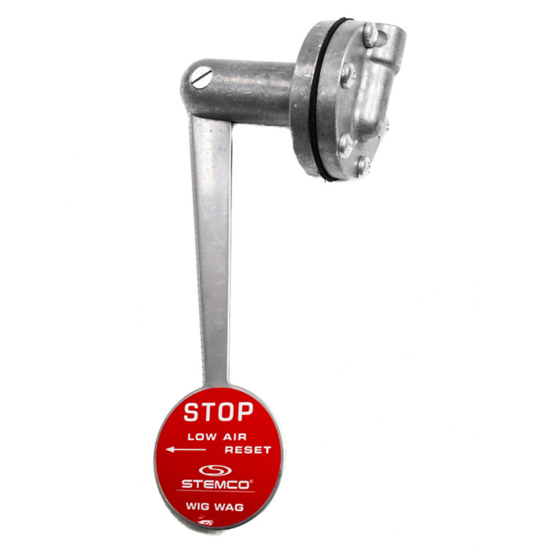

bc.gold 3,406 #12 Posted June 19, 2020 (edited) Here's one that will get your attention, once air pressure has been reached the ( wig wag ) flag is set into position manually, should air pressure fail the flag drops down right in front of yer face. Our Hayes logging truck was equipped with warning buzzer, air pressure gauges and a trailer brake application gauge in addition to the wig wag. Love the sound of the Jake when coming down a long steep mountain grade. Edited June 19, 2020 by bcgold 6 Share this post Link to post Share on other sites

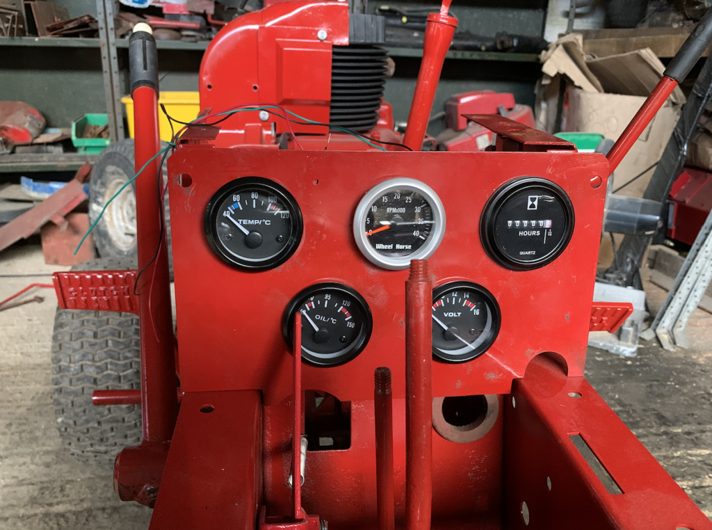

meadowfield 3,204 #14 Posted June 19, 2020 I'm adding oil temp via the drain plug - that was why I asked on the other thread was the thread dimensions were... I bought adapters for 3/8 and 1/2" so hopefully one will fit. Also adding fuel gauge so I don't need to buy the expensive filler caps that inevitably break and leak. Then replace Amps with Volts Add an hour counter Then finally my modified single cylinder tacho. 1 1 Share this post Link to post Share on other sites

meadowfield 3,204 #16 Posted June 19, 2020 13 hours ago, pfrederi said: The more gauges the more wiring and connections that can fail...520 series vs Commando 8 ??? agree, but volt, and hour counter are two wires. Then one each for oil temp, tacho and fuel gauge. I don't think that should be too much pain... 1 Share this post Link to post Share on other sites

Rob R 993 #18 Posted June 19, 2020 LUV the RPM dial indicator (WH) where can I get one, what is the cost and how is it installed. THANKS 1 Share this post Link to post Share on other sites

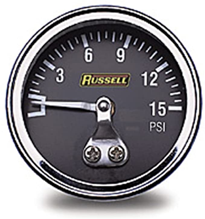

bc.gold 3,406 #21 Posted June 19, 2020 PTO engaged indicator light, fuel pressure gauge and an air filter minder. Share this post Link to post Share on other sites
