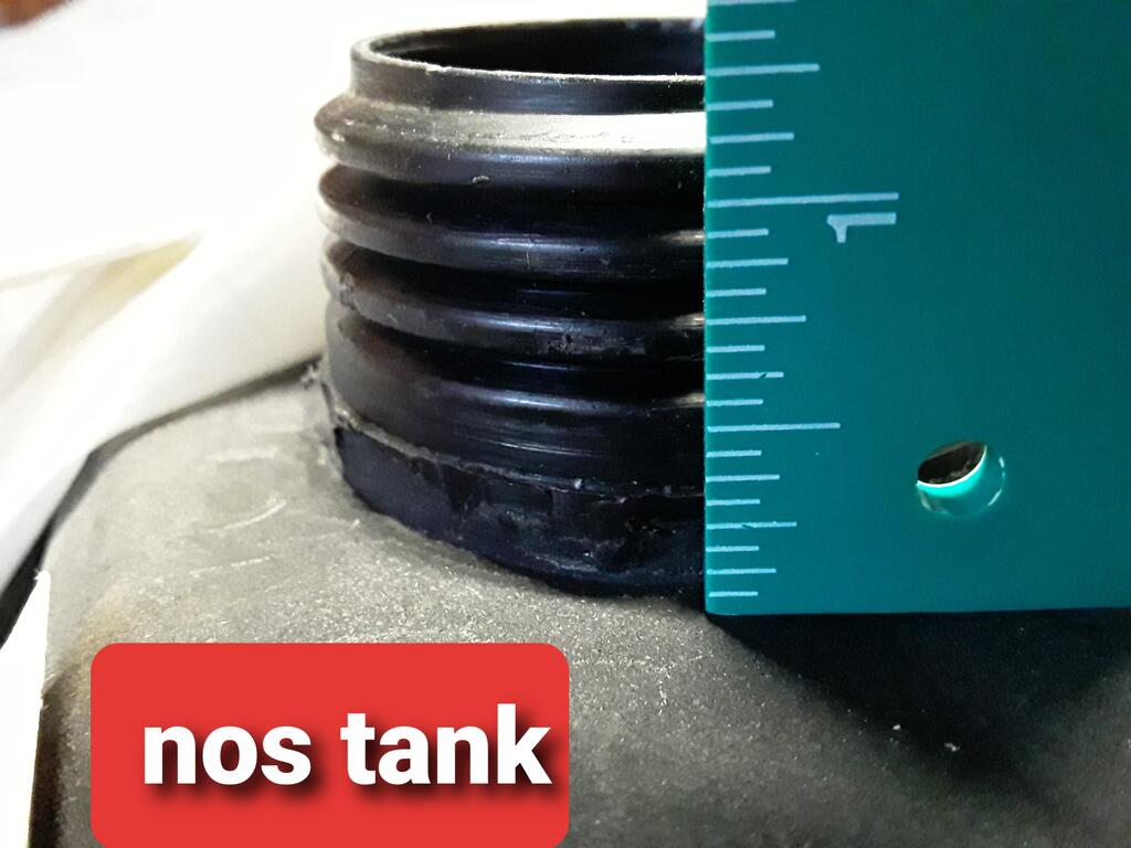

76c12091520h 3,296 #21 Posted January 1, 2023 Measure the height of the threaded portion of the tank in question and compare it to a known good or NOS tank; have seen underseat tanks with squashed ( compressed ) threads. I sold a brand new gas cap / gauge at the show last summer and the customer brought it back with this concern. The cap I sold him threaded on a new old stock tank perfectly. His spout on his tank was compressed about 1/8"..... 1 Share this post Link to post Share on other sites

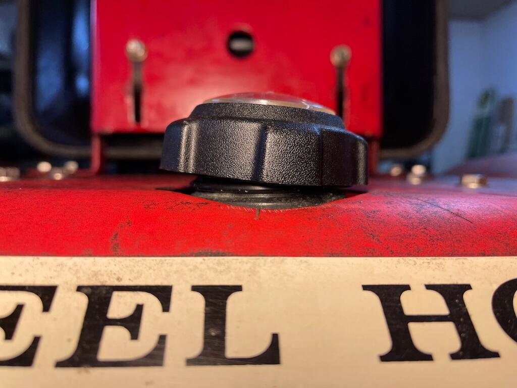

TractorEd 516 #24 Posted December 24, 2023 (edited) Upon further inspection, the cap(s) don’t screw on squarely. The cap ends up sitting crooked on the tank. Now that I have a tractor lift it’s easy for me to look right at it, lol. Easiest thing I can think to try is heating up the cap threads and screwing it on hot to make the threads conform to the tank. Edited December 24, 2023 by TractorEd Share this post Link to post Share on other sites
