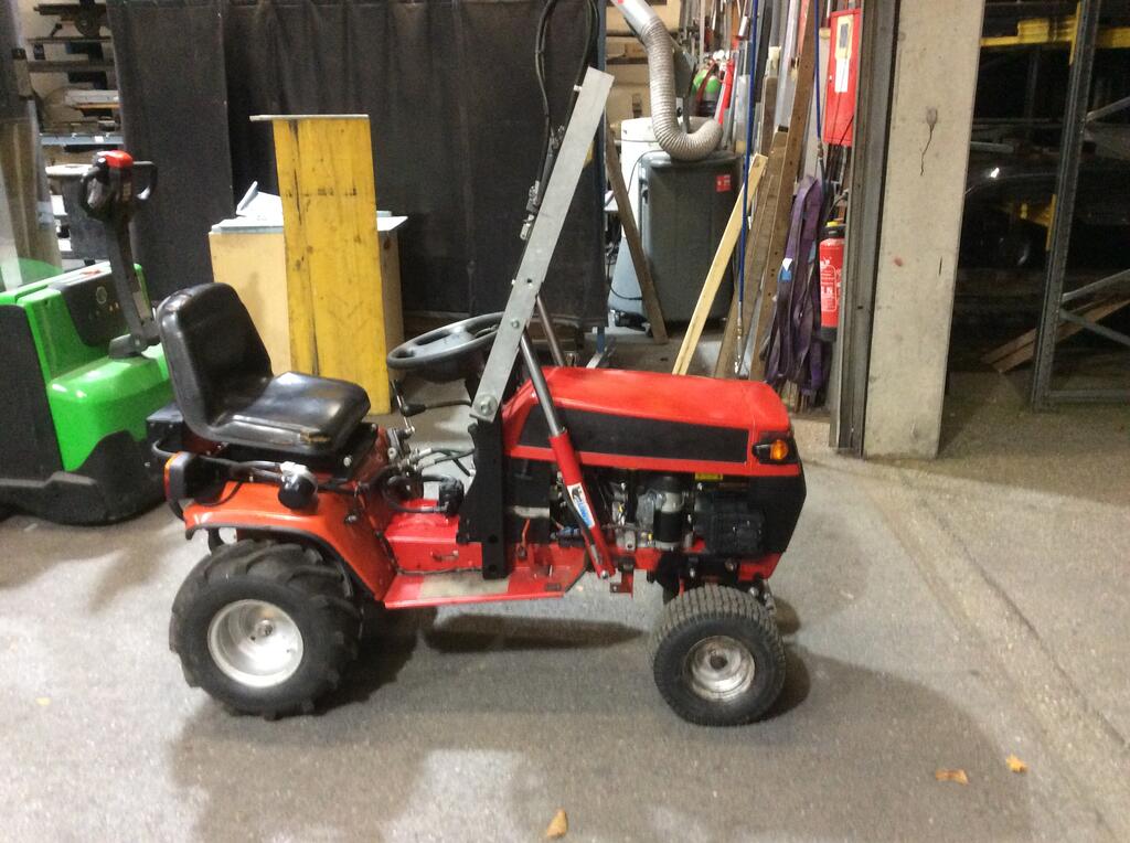

Tractorhead 9,217 #3 Posted June 4, 2020 My Horse after Onan Cylinder rip get an Loncin Swap. before a 12 HP Onan was in after the damage i Swaped to Loncin 16HP and it was a good idea. i bought that Engine as a 12 HP, but on Engine plate it was a 16HP. what exactly fit‘s i‘d know, but i‘m on the 16 HP Side. It has brutforce torque output even on Hydraulics.. the Hydropump is in gearratio 1:1,73 on the Engine and even on full load on the HydroPump, just a little drop is feeled at pumppressure on 175Bar under fully Load. runs now since a year without any trouble reliable and smoothly. Each start it fires right up. just pull the choke and - here we go. btw, also the Engine on my Tiller the 6,5 HP Pullstart is a Loncin. 58E985F9-FF68-4789-9B9C-34720386D551.MOV They here available for dump prices, but their quality seems massive improved since the last 10 years. needs on each start the choke but fires immediately up. No bad decision at all. At last Oilservice the oil looks like honey colored, no visible metalparts in. I would buy again after my review on mine both. 2 1 Share this post Link to post Share on other sites

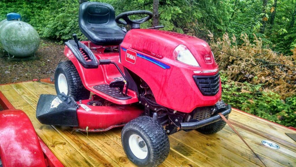

Achto 32,615 #5 Posted June 4, 2020 Thanks for the comments. I picked this Toro lawn tractor up along side the road "FREE BEE". It's in really nice shape, but when I got it home I noticed that the Kohler SV600 engine had an extra ventilation hole in the side of the block. A new Kohler short block would put me almost upside down on the value of the tractor so I've been looking at alternatives. My plan is to repair & sell the tractor but I don't want to stick the next owner with some POS engine that will give them trouble. So far the Loncin sounds like a good alternative. A pic of my Free Bee. 3 1 Share this post Link to post Share on other sites

WHX?? 58,043 #8 Posted June 4, 2020 It's a shame somebody trashed a nice mower like that just by not checking the oil. I would think you could get 700 for it with a good motor. Did you nix the idea of JB welding the extra hole up?? 2 Share this post Link to post Share on other sites
Achto 32,615 #9 Posted June 4, 2020 16 minutes ago, WHX24 said: Did you nix the idea of JB welding the extra hole up?? I was thinking of making a plate to bolt over the hole in the block and then replacing the damaged pieces in side the engine. If I was keeping it, I might have still done that just for an experiment. I can see through the hole in the block that the crank looks to be scored. A quick peak through the same hole with a bore scope shows a few other thing banged up in side the block as well. Short block or whole engine replacement are the best options here in my opinion. 1 Share this post Link to post Share on other sites

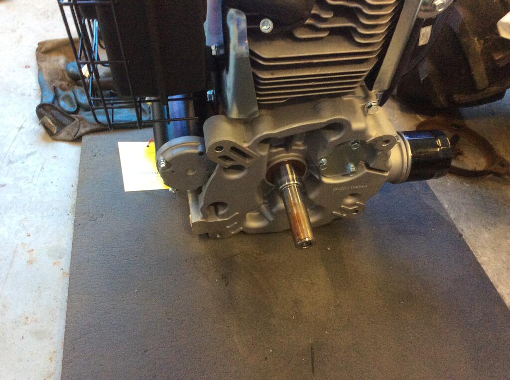

Tractorhead 9,217 #14 Posted June 4, 2020 (edited) On my Onan swap it was just Plug and Play. the 4 mounting bolts are predrilled but no threads inside. They do selfthreading while first mount. the PTO Screw was 7/16“ 20 NPT (fine threaded) in 6“ length if i remember right, so that thread also compares to my old Onan. On my Swap needs just a bit longer Screw because i changed also the PTO Electric Cutch to a other one, while i damaged mine by try to pull of the Shaft from the heavily rusted Onan Shaft and did an oops at this. The most rust on the Onan shaft and some where else was from firedistinguisher and the sat outside after for nearly a Year without cover. But at all it was just Plug and Play nearly. The Throttle was used with the old Linkage and bowden and i added a Choke separately with a sepatate Bowden. It is just needed to pull shortly on start procedure and can be quick released after the Engine Fired up. edit @jabelman i payed for mine 236$ Brandnew with 2 Years Warranty. I agree to you about the throw away was normally not my World, but a Kohler, Onan or even Briggs here cost more as the double for a replacement. Even just the parts for fixing the Onan here at my Location blasts my Budget for that Tractor, also more than this whole Engine, so my decision was that Way. edit end Edited June 4, 2020 by Tractorhead 2 Share this post Link to post Share on other sites
Tractorhead 9,217 #15 Posted June 4, 2020 @Achto ah, i forgot to tell it have a pressure lube system, that allows More sideslope while drive without engine damage. you can see the Filter in the last pict on the right side. 1 Share this post Link to post Share on other sites
