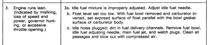

LandoCommando214 82 #6 Posted June 3, 2020 (edited) I'm not sure if the counterweight could cause this or not, i'm pretty unfamiliar with issues stemming from the counterweight. Here's something quick you could try; I found this in the fuel system troubleshooting section of that manual. Maybe you're running lean if you have excessive throttle opening? Again, maybe just something easy to try and rule out before you dive into all the linkages, shafts, levers and springs. Play with the fuel mixture to see if it goes away. Edited June 3, 2020 by LandoCommando214 I misread the troubleshooting table...I'm not exactly sure if your problem corresponds with "excessive throttle opening". Do they mean excessive motion of the lever to get the engine up to speed, or do they mean a little throttle goes a long way?? Share this post Link to post Share on other sites

RedPrideNation 23 #8 Posted June 3, 2020 @LandoCommando214, the segment you screen captured caught my eye as well so I may just be extremely lean. @pacer, your previous dealings are what I am fearing to be honest. I will update after I go back through it again and verify a few of these items. Thanks again for the suggestions. 1 Share this post Link to post Share on other sites
