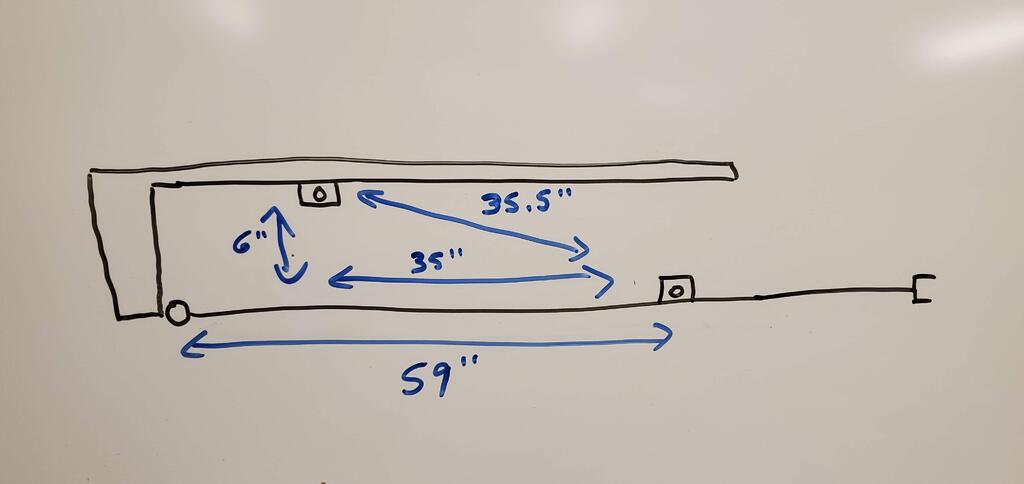

oilwell1415 563 #26 Posted June 8, 2020 Judging from the pic it looks like there's about 6" from the hinge line to the deck of the bed. That's also about the vertical distance between the cylinder mounts. If the cylinder is 30" long from mount to mount the vertical component of the force will be 20% of the total, so 440 lbs. There is also a horizontal component of the force that's equal to about 98% of the total, so 2156 lbs. It is acting about 6" above the hinge line and generates a tilting moment of 1077 ft-lbs. If the bed is 6' long the center is 3' from the hinge and the moment results in 360 lbs of force at that point. 360+440=800. Share this post Link to post Share on other sites
Goofey 89 #27 Posted June 8, 2020 What angle do you calculate on? Share this post Link to post Share on other sites
oilwell1415 563 #28 Posted June 8, 2020 No need for angles if you have the dimensions. Share this post Link to post Share on other sites
Skipper 1,792 #29 Posted June 8, 2020 (edited) Oilwell1415 is absolutely right, there is a rotational force, however the arm that the horisontal force is pushing on, is a function too, between the two lines between the 3 hinge points. To find the arm you go Tangent to the angle times the distance times the force horisontally, then divide by the distance to the center point. If we look at the pics, I guesstimate like Oilwell1415 (and we may very well be wrong) it to be a 6 foot trailer with the cylinder lift point at 2 feet from rear hinge point, and center mass at 3 feet. Now until we have measurements, we can only use OP's initial bet at an angle, and since that is 2.5 deg. the resulting upwards force from the rotational force will be very small. Again, when the angle gets bigger, so does this number, but until we have actual measurements, we can't really do much more. Just for the illustration, if we assume the 2.5 deg are right (which I doubt very much), this is the horisontal force's contribution.: Tan 2.5 deg = 0.04366094 x 2 feet x (sine 87.5 deg = .999 x 2200) divided by 3 feet. equals 63 lbs. This again illustrate that it is the angle that determines how it should be constructed. The way it is right now may be sufficient, if the angle is indeed bigger than OP's initial guesstimate, just as Oilwell1415 too suggests. Now back to contemplating how massive these forces are, and how they affect the frame work. We are talking 2200 lbs (1 ton) of push on hinges and crossbars etc, and that's only at 700 psi. Imagine going up to near full pressure on that little 2" cylinder. Say 2800 psi. That would give you 8800lbs or 4 metric tons of pressure. Please try to understand why I suggest that it might be prudent, strengthening that old frame up just a tad, if OP is right at the 2.5 deg, and he wants to lift, say just 1000lbs. That would take about 4.5 tons of cylinder pressure directly to the frame. Edited June 8, 2020 by Skipper 2 Share this post Link to post Share on other sites
Alex175 785 #30 Posted June 9, 2020 (edited) 14 hours ago, Skipper said: Now until we have measurements, we can only use OP's initial bet at an angle Yeah......I was wrong.....Like really wrong on my early guesses. Here are the actual dimensions drawn out. I did not include actual bed length in the photo, but it is 72". 16 hours ago, oilwell1415 said: Judging from the pic it looks like there's about 6" from the hinge line to the deck of the bed. You were perfect on that one. Edited June 9, 2020 by Alex175 1 Share this post Link to post Share on other sites

Alex175 785 #37 Posted June 10, 2020 So I'm figuring more out, and I feel like I am getting close, but I am also still lost on what I believe is the final step. I think at 500-600 pounds, that would be on the small end/under what I would like. What I would like to do before looking into other power systems, or altering the trailer, is to calculate the power I could get by increasing the bore of the cylinder instead. I've calculated vertical and horizontal force using @oilwell1415's formulas, and I've attempted to calculate the actual force using @Skipper's formula of On 6/8/2020 at 6:08 PM, Skipper said: Tan 2.5 deg = 0.04366094 x 2 feet x (sine 87.5 deg = .999 x 2200) divided by 3 feet. equals 63 lbs. So using the information of a 10 degree angle for starting, and using the 24 inches (2ft) and 29 inches (2.42ft) instead of 2 and 3 feet respectively I am coming up with the formula 0.176 x 2 x (.999 x 2200) / 2.42 which comes out to ~315 lbs. which skipper describes as the horizontal force contribution. When you guys did the math do you take the Horizontal force contribution and add that to the vertical force to get the lifting power, or is there another step that I am missing(like a vertical force contribution)? If that is the case my calculations are coming out to around 686 lbs, with you guys both coming in at over 700. Below is a breakdown of the numbers that I have compiled, to maybe see if I messed up somewhere along the way. Now I know how Alice felt when she jumped down the rabbit hole. Component Formula Sign Value Bore Force V Force H Force HF Contribution Lift Ability? Side A A 6 2 2198.00 371.49 2167.04 314.91 686.41 Side B B 35.5 2.5 3434.38 580.46 3386.00 492.05 1072.51 Side C C 35 3 4945.50 835.86 4875.85 708.56 1544.41 PSI PSI 700 Formula Used Tan T 0.176 (3.14*((BORE/2)^2)*PSI) F x A / B F x C / B T x HP x (.999 x F) / CM VF + HFC? Sin S 0.174 Cosine C 0.985 Lenth(Hinge Point) HP 2 Length(Cental Mass) CM 2.42 Force F Column F (ironically) Bore BORE Column E Share this post Link to post Share on other sites

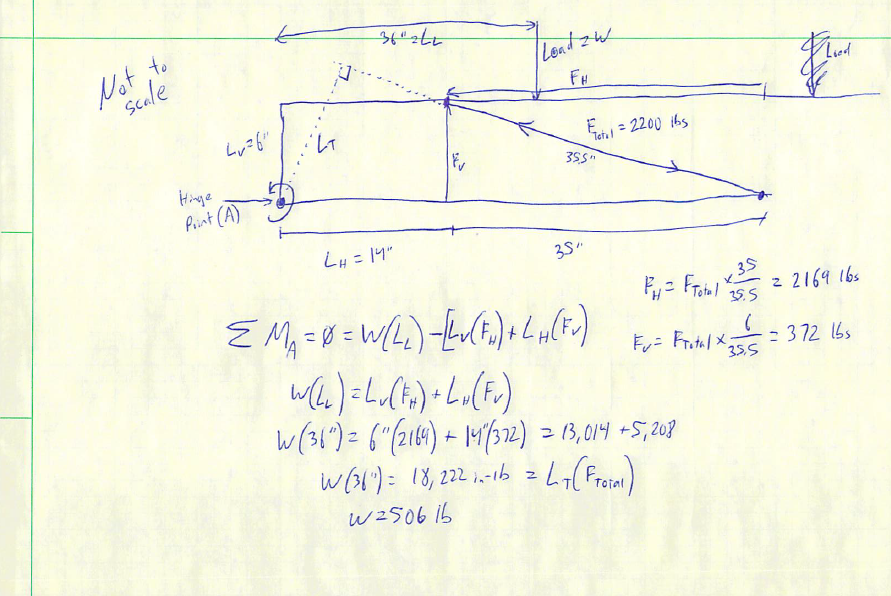

oilwell1415 563 #38 Posted June 10, 2020 I'll give this another go now that we've got actual measurements. The dotted lines show what you would have to do if you wanted to just use a single force and lever instead of two. In this case I think it's easier to just do two moment calculations. The two triangles are proportional, so it really just comes down to preference. I have neglected any overhand at the rear of the trailer. If you make the overhang 6" and still measure from a point 36" from the very back of the trailer the force (W) goes up to 607 lbs. What we've got going on here is a summation of the moments about the hinge, which I've designated as point A. The players in the game are the force of the cylinder, Ftotal, the vertical force, Fv, the horizontal force, Fh, the vertical lever length, Lv, the horizontal lever length, Lh, the load of the bed, W, and the load lever, Ll. The system is assumed to be at rest and steady state, so the sum of all the forces is zero. Fv and Fh are calculated using the formulas to the right and are proportional to the lengths of the triangle formed by the cylinder and the and its mountings. Fv=372 and Fh=2169. We multiply the horizontal force and vertical lever together and get 13,014 in-lbs and multiply the vertical force and horizontal lever together and get 5,208 in-lbs. The total moment generate by the cylinder is the sum of those two numbers, 18,022 in-lbs. Since we assume that the system is stationary, the sum of all moments must be zero. This means the distance from the back of the bed to the center of the load, shown as Ll and equal to 36", multiplied by the actual load, W, must also equal 18,022 in-lbs. So we have Wx36=18,022. Divide both sides by 36" and you are left with 506 lbs. Assuming I did the math right. Share this post Link to post Share on other sites
Alex175 785 #39 Posted June 10, 2020 (edited) 1 hour ago, oilwell1415 said: Assuming I did the math right. The math is now making more sense to me(I really am starting to wish I had paid more attention in school), I do have two clarifying questions however as I think two of the pieces of information you used in the calculation may be incorrect. Some of the info I included in the text posts and not in the picture so it could have easily been missed. Starting with LH, the overall length from the rear hinge to the front pin of the cylinder is 59", pin to pin is 35", so therefor wouldn't LH be 24" instead of 14"? Secondly, the trailer bed itself is 84 inches long, for LL which is the load level, is this looking at the center mass of the trailer bed? If so I believe that number should then be at 42 instead of 36. I know the drawing isn't to scale, so maybe I misinterpreted something so I just wanted to check. And I really am grateful for all of the help, you guys have gone way out of your way to not only help me find the info, but teach me how to get there and I cannot express how appreciative I am. Edited June 10, 2020 by Alex175 Share this post Link to post Share on other sites
oilwell1415 563 #40 Posted June 10, 2020 You are correct that Lh should be 24" That explains why the numbers didn't make sense. I put the numbers in a spreadsheet initially and probably fat fingered that one. The 1 and 2 are too close together. The bed length was just a guess. I don't remember seeing where it was ever stated, just that we guessed it was about 6 feet. I used half of that. But LL is really just an arbitrary number pulled from the sky to define the point where the center of mass of the load would be. Since you can put the load anywhere on the bed you want to put it, this really doesn't matter. If you have a heavier load, put it towards the back and it can still be lifted. Share this post Link to post Share on other sites

Skipper 1,792 #42 Posted June 10, 2020 6 hours ago, Alex175 said: Now I know how Alice felt when she jumped down the rabbit hole. Don't sweat it. Happy to help, and you are getting the hang of it I see. The devil is in the details, and there are quite a few to keep straight, but you are doing fine. I also had a few "aw heck" moments when i did the crunching. Had to put it on a little sketch too, to straighten it out. I would like to suggest a few other alternatives for you to think about. 1. Relocating the bracket that holds the cylinder in the front end of the trailer, to give it more angle. Would require a bit of welding. More upwards force, but less rotational. You would have to try your way to find a good placement. Remember the cylinder should then swing downwards in its closed position, to its new location, so your 35" measure will be altered. 2. Using two 2" cylinders, equally offset from the middle. That would give the same force as a single 3", but you would have no problem fitting it due to the placement of the square tubing in the middle. 3. Combine the 2 cylinders option with lowered front brackets, to go even higher if needed. Also take into consideration that using a 3" (or 2x2") will double your cycle times. 1 Share this post Link to post Share on other sites
oilwell1415 563 #43 Posted June 11, 2020 I was turning numbers over in my head last night because something just didn't make sense and decided to confirm them on paper this morning. You just need to put a 3" cylinder on it and be done with it. That increases the available lifting force by 125%. The down side of a larger cylinder is that it takes longer to extend. A 3" cylinder has a volume of 169 cubic inches, which is just under 3/4 gallon. If the pump on the tractor pumps 4 gpm the extension time on a 3" cylinder is only about 10 seconds. If you did a 2" cylinder it would be under 5 seconds, which in my opinion is way too fast to maintain good control of the dumping process, especially early in the movement when the geometry is going to cause things to happen in a hurry. If you really wanted to speed things up you could do some creative valving to include a regeneration circuit that's is manually chosen by you or you can include a pressure limiting valve on the retraction side that automatically kills the regeneration at a fixed line pressure to give you full capacity. Either way, a 3" cylinder is the answer. How complex you want to make the system after that is up to you. Share this post Link to post Share on other sites
