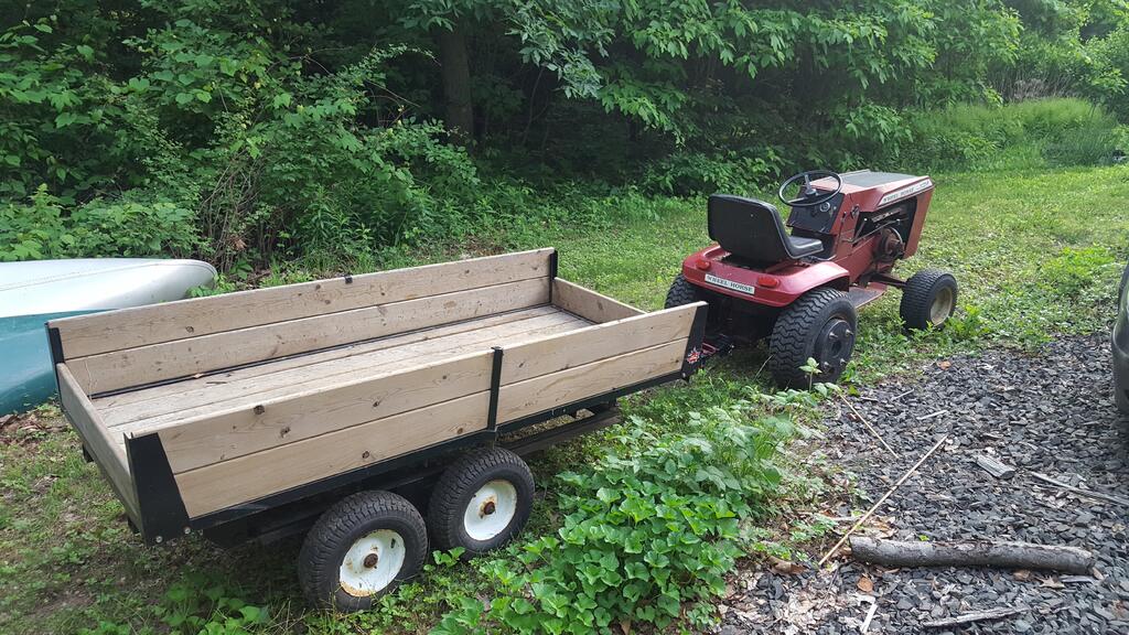

Alex175 784 #1 Posted June 2, 2020 A couple of years ago I picked up a tandem axle atv/yard trailer that has the ability to dump and has the ears welded on to add a hydraulic piston. I have been working on a number of ways to use my C-195 to activate the hydraulics, but keep running into more questions than answers, so I figured I would spew out a few ideas and let you guys help me decide if I am crazy, or just insane. The trailer is set up to accept a hydraulic cylinder with a 2" bore, and a 24" stroke. By my calculations, to fully extend the cylinder, I would need .63 gallons of fluid. The issue here is that if I wanted to hook it up and use the tractors hydraulics the C-195 has a capacity at only .75 gallons, so I am thinking that nearly running the transmission dry if I had the trailer fully extended is probably a bad idea... That was idea 1, but unless I am wrong, I think there are better options. My second thought was to get an electric over hydraulic pump and mount it to the trailers tongue. This way it would have an independent oil reservoir, but now we come to the problem of powering it. It is a 2hp motor with a max run speed of 3,000 rpm. It runs off a 12v system, and according to the manufacturer under no load it draws 80 amps, and under full load it draws 250 amps. The pump pushes 1.5 gallons per minute, so using some really rough math, that tells me that the pump would need to run for slightly longer than 20 seconds to extend the cylinder to the max. Is it plausible that this could run off of the tractors electrical system? If I could what gauge wire would I need to run from the battery back to the pump? Or would I need to have a separate deep cell battery (for example a marine battery) to run the pump? Any other ideas on how to do this better would be greatly appreciated. This trailer is a pain to tip manually, it's steel construction and wooden bed is awesome, but heavy. I'd love to have a way to back up to where I want to dump it, and just hit a button! 5 Share this post Link to post Share on other sites

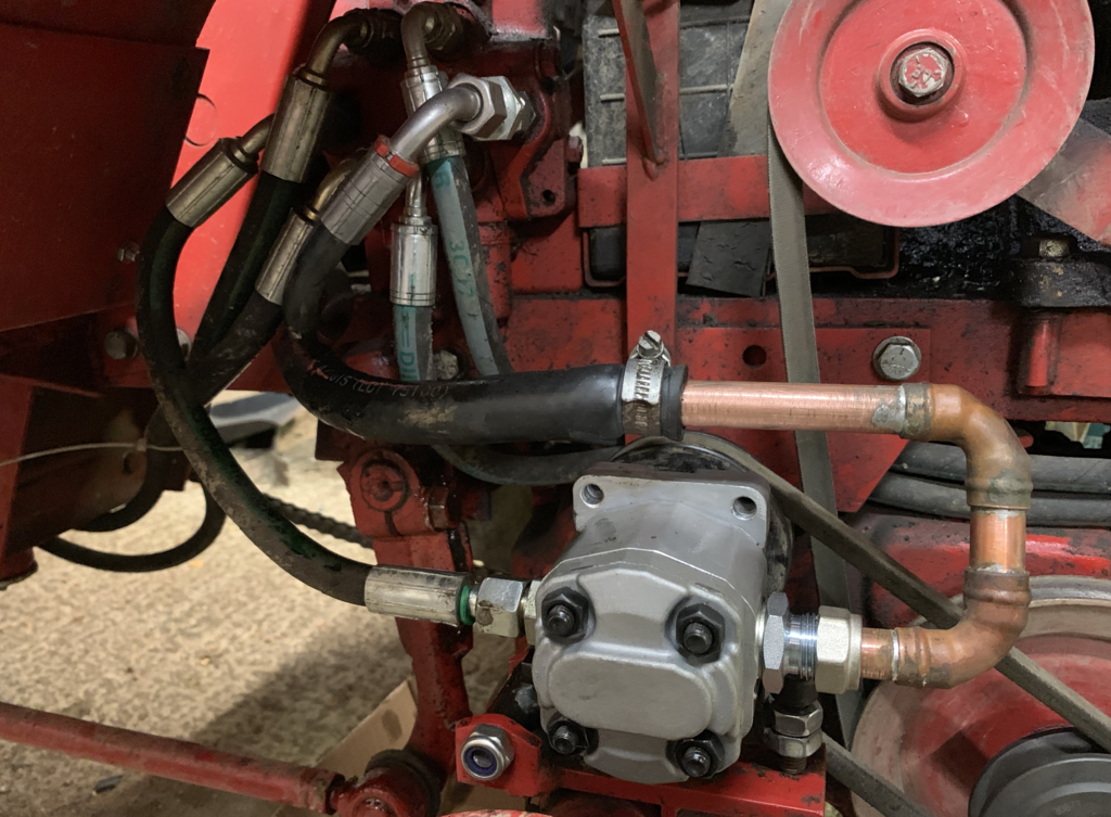

meadowfield 2,945 #15 Posted June 3, 2020 I've been through this quandary when I built mine. The only single acting cylinder I could fit is 40mm with a 25mm rod @450mm stroke. My old system was a power steering pump with around 700psi, which was more than enough for my three point cylinders at 80mm, however just not enough with the angle when the body is lowered. So the power steering pump had to go, and was replaced by a 1.5cc 3000psi pump. which was a great idea, until at the end of the ram stroke the D-200 spool valve blew its guts out... there no relief valve on the new pump!!! So I had to fit a new spool block with relief valve. All good now, wouldn't be without it I think theres a build thread somewhere... 1 Share this post Link to post Share on other sites

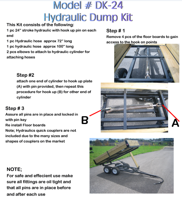

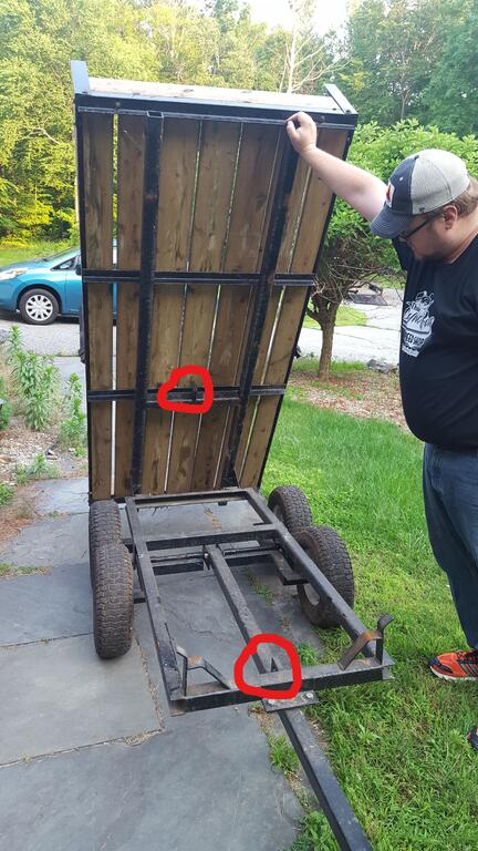

Alex175 784 #17 Posted June 3, 2020 7 hours ago, Skipper said: That would be the pistons push/pull force, but you also need to take into the equation how the cylinder is mounted. So the trailer comes manufactured with the mounting for the cylinder. I was able to get some basic information on it from the manufacturer with a kit they sell. That kit consists of the cylinder and two hoses for $450.00 which I know I can do way better on the price. Again doing basic math, I think I have determined that closed the angle is ~2.5 degrees, maybe slightly larger, and at full extension it is ~30 degrees. Looking at the image from their install instructions, the cylinder they are using does not appear to be that large, but I understand that it is also dependent on the power of the pump. So the main thing I am left needing to figure out is what size bore I need for the cylinder. Share this post Link to post Share on other sites
Goofey 89 #18 Posted June 3, 2020 (edited) Thats not much of an angle at all. On the pic it looks bigger than that. What load would you put on it and what does the bed weigh? How big a load does the factory kit say it can tip? If I remember math right you can calculate your needed power with vektors and cosine. Probably find a formula or calculator online for it. Just checked a bit. If I do the math right you only get 4% lift power at 2.5 deg. and at 6 deg. you get 10% and at 10 deg. you get 17%. I know Skipper is an engineer and so are others here. Perhaps better listen to them. Edited June 3, 2020 by Goofey 1 Share this post Link to post Share on other sites
Alex175 784 #19 Posted June 3, 2020 1 hour ago, Goofey said: On the pic it looks bigger than that. What load would you put on it and what does the bed weigh? How big a load does the factory kit say it can tip? It could very well be bigger than that, I guesstimated a couple of numbers in my equation as I don't have the trailer with me at the moment. The factory provides almost no information on this thing other than capacity which is 2,000 lbs for the trailer (not the hydraulic kit, there is no info on that), which I don't think I would ever get close to maxing out for what I'll be doing. I was lucky I was able to even find them, the only info I had when I started was the look and design of the trailer, and the fact that it had a maple leaf sticker on it. Which I somehow through google magic I was able to find the manufacturer. Share this post Link to post Share on other sites

Alex175 784 #21 Posted June 8, 2020 (edited) On 6/3/2020 at 6:02 PM, Skipper said: I can give you a hand with the basic calculations and so on if you like. Just need a few more data to be able to. I appreciate the help greatly, and I apologize for the silence here for the last few days, I have been fighting a few other things on the trailer (tires need new tubes, but the wheels are rusted and stuck on the axles) and so my attention on the hydraulics got diverted for a couple days. I cannot weld, and don't have the equipment to, but I know a few people who do so I can ask around. I plan on taking precise measurements of the trailer today when I get home so that I have all of that information available. to start building a better plan. Edited June 8, 2020 by Alex175 Share this post Link to post Share on other sites
oilwell1415 563 #22 Posted June 8, 2020 The angle is shallow, but since the hinge line is below the point that the cylinder connects to the bed the vertical force isn't all that matters. With the hinge line that low you'll have a lot more dumping power than just the vertical force the cylinder puts out. Like was said earlier, with accurate measurements it could be calculated. But if it's designed for a 2" cylinder it will probably work fine with a 2" cylinder. Share this post Link to post Share on other sites
Goofey 89 #23 Posted June 8, 2020 Doubt it was designed to work with only 700 psi though. If I understand all this right, it was probably designed to run at full normal pressure. app 4 times the hydros pressure. Not worth much if it can only lift the deck and a shovel and a bucket full of nothing Share this post Link to post Share on other sites
oilwell1415 563 #24 Posted June 8, 2020 Even at 700 psi it's enough to put around 750-800 lbs of vertical force in the middle of the trailer based on some guesstimates on the dimensions. Plenty to do work. Share this post Link to post Share on other sites
Goofey 89 #25 Posted June 8, 2020 How do you get to that number? I can't get the math to go that far unless the angle is way bigger than he says. I just looked up a sine table and it says about 24 deg for it to reach 800 lbs. Share this post Link to post Share on other sites
