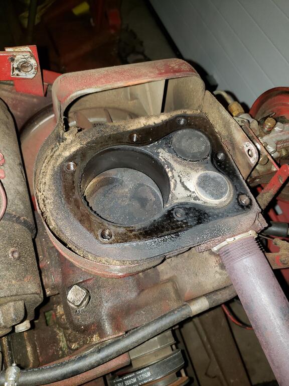

71_Bronco 1,073 #1 Posted June 2, 2020 So I took my Commando 8 out when I got home to mow the lawn. Didnt get a chance this weekend, so I figured I'd do it after work. Drove around the yard a little trying to remember where I left my gas can, and everything was going good. Found the can, refueled, and went to mow. Did one pass (using a 36" rear-drive deck) and everything was going as normal since I got the tractor about a year ago. At the end of the yard, went to do a 3-point "K" turn. As I finished the turn, things went south. First I noticed a loud "klacking" sound from the motor. I thought to myself "that's odd, I've never heard that before". Just as I finished that thought, the engine gave a loud metalic-y POP, then sputtered to a halt. I turned the key, it turned over, but didnt fire. I also noticed what looked like white smoke coming from the front of the motor. I pushed it to the garage and did some investigating. Discovered the smoke was coming from the points cover (never did that before). No idea what would cause this. I pulled the plug and looked in. Turned over the motor slowly by blipping the key. The piston didnt move, but the valves were moving. Pulled the head off, and gave a little tap on the top of the piston, and it slipped down the bore with almost no resistance. I took a picture of the engine with the head off (attached). Not sure if I can tell anything from it. Luckily I still had my old push mower, so I got the lawn done at least. Have to figure out what I wanna do with this one now. I always run it at full throttle (due to the splash oil system). I tuned the carb when I got it using one of those wire rpm gauges and set it to 3600. 8 Share this post Link to post Share on other sites
71_Bronco 1,073 #2 Posted June 2, 2020 I think I may have found the issue. I checked the oil lever for hahas, and the oil stick didnt even hit the oil when put in. I looked in the hole, and there is oil in the block. I didnt realize I was burning oil (doesnt smoke when starting or running). I know this isnt an excuse, I should be checking it regularly. Going to be a costly lesson. 8 Share this post Link to post Share on other sites
WHX?? 58,347 #3 Posted June 2, 2020 Yup ... let me know when yer in the right frame of mind to see a video and pics of this happening. Now you are looking at a new rod, crank reground... the whole shebang. BTW nothing wrong with putting a check the oil reminder on the dash. Just cause she don't smoke don't mean she ain't using oil. Keep us posted if we can help. 3 Share this post Link to post Share on other sites

WHX?? 58,347 #6 Posted June 2, 2020 Next step here Bronc is to pull the motor apart and assess the damage. If you ventilated the block yer done...if she went the other way and just busted the cam we can rebuild her make her better... stronger...six million dollar commando... just kidding and trying to cheer you up! 2 2 Share this post Link to post Share on other sites

bottjernat1 2,197 #16 Posted June 2, 2020 Drop the pan and let us see what happened 1 Share this post Link to post Share on other sites
