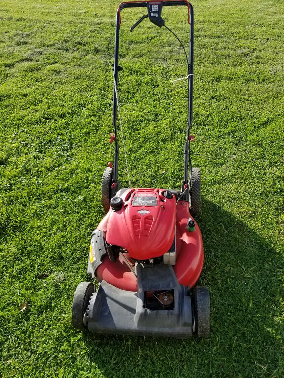

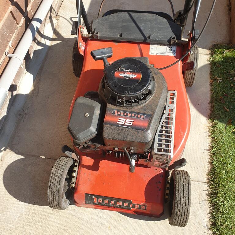

Mickwhitt 5,259 #1 Posted May 31, 2020 Hi all. While I was tinkering with Fred in the front drive yesterday a chap wandered up and asked if I'd like an old mower he was taking to the dump. Absolutely I said... At first glance it's pretty intact but needs a good service. First pull of the cord shot a bit of oil out the plug hole but I guess it's been stored standing up so the cylinder was flooded. Feels a it tight as I pull the starter too but I will have a basic strip down look at it to see if there is anything bad happening. Guy said it worked fine till he put some dirty fuel in so I guess a good carb and tank clean are first up. This might be just the thing for our community project. Mick 11 Share this post Link to post Share on other sites
ebinmaine 81,003 #2 Posted May 31, 2020 Nicely done sir. Looks similar to one I had here awhile ago. There will likely be a gasket between the carb and tank that goes bad. The tank is actually the lower part of the carb. Good cleaning and a few bucks in parts and you'll be good. 1 Share this post Link to post Share on other sites

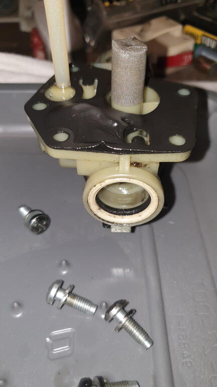

Mickwhitt 5,259 #6 Posted May 31, 2020 I suspect this is part of the problem. Ernie you were spot on! The gasket looks to form a diaphragm but the wrinkle in it is allowing air in so it cant function. Hence the lumpy running and hunting. I will get hold of a gasket in the week and see what difference it makes. It's a neat machine, deck is solid, just needs painting. Bit of carbon buildup but I will put some Redex in the fuel and that will be fine. Mick Share this post Link to post Share on other sites
ebinmaine 81,003 #7 Posted May 31, 2020 You see how there are two rubber flappers built into that gasket? That's part of the regulating system on those. Clean that sucker out and throw some new gaskets at it and she'll be super happy. Share this post Link to post Share on other sites

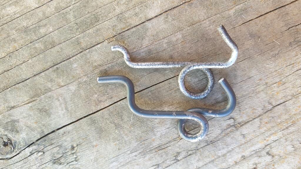

Mickwhitt 5,259 #11 Posted June 2, 2020 Well I fitted a new gasket kit. Success, it runs fine, butvthere is still an issue or two. Firstly I lost the piano wire governor link. I know I should have took it out but I didnt and its now on the shop floor somewhere amongst the spiders and swarf. I made a new one but obviously it's not an exact copy so might be the problem. It ran for about five mins, then slowed very slightly before cutting out. Would not then start again. Let it go cold and it ran again. It was a bit smoky so could it be the governor was letting it run too slow? I will make another link wire and try that. Mick Share this post Link to post Share on other sites
Mickwhitt 5,259 #12 Posted June 2, 2020 If at first you dont succeed, have another look where you stripped the gas tank off the machine and you will find the original link wire. The lighter coloured one is the original. I made the new one by scaling from a photo I took before stripping the carb. Its a tad wrong. But I found the main problem was not enough tension on the main governor spring. I bent the metal governor bracket a little to give that extra pull and it runs like a dream, no smoke, no hunting. Many thanks guys, I can confidently refurbish it over winter now to get a cracking little mower for nothing. Mick 1 1 Share this post Link to post Share on other sites
