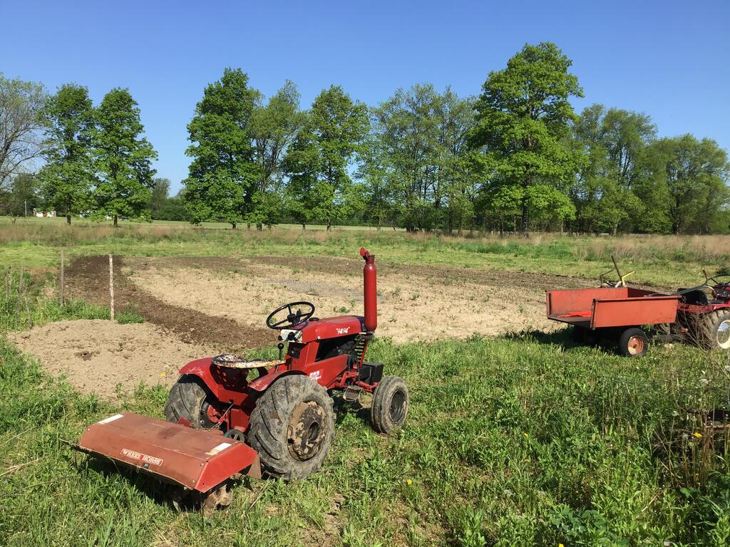

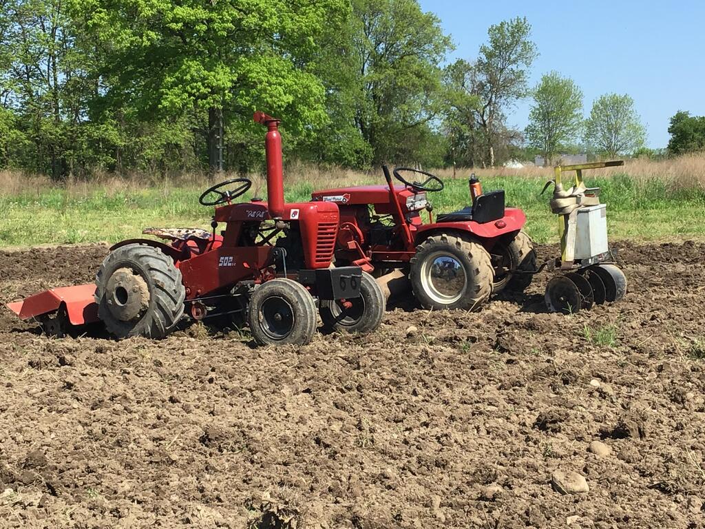

Pullstart 70,725 #7 Posted May 31, 2020 @RBB! I have a tiller on my 8 hp 502, but it really should be on a 10-14 hp machine. There is no “kit” to get what I have, the tractor is a 1962 502 with a bigger engine and newer 8 speed transmission, the tiller is driven via a ‘60’s era mower deck pulley and a not so typical length belt. In my clay based soil, 1st/low is still too fast in spots of the garden, after I’ve plowed and disced already! I should put a larger pulley on my transmission input to slow it down further. At my old house, in sandy loam I barely needed low range. 2 2 Share this post Link to post Share on other sites

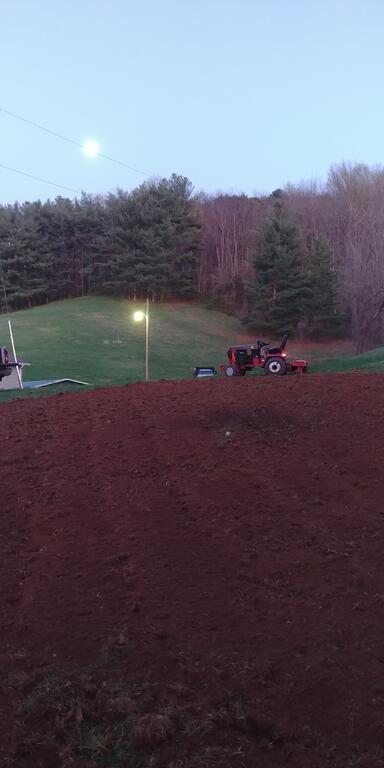

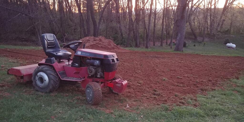

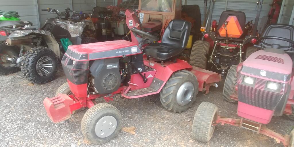

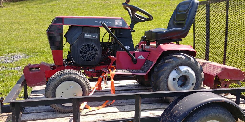

WVHillbilly520H 10,378 #10 Posted May 31, 2020 I'll let the pics speak for themselves... 1 2 1 Share this post Link to post Share on other sites
tom2p 2,394 #11 Posted May 31, 2020 3 minutes ago, WVHillbilly520H said: I'll let the pics speak for themselves... top pic is awesome ! ( and extra points for the big block truck in the background ) 1 1 Share this post Link to post Share on other sites

tom2p 2,394 #13 Posted May 31, 2020 45 minutes ago, pullstart said: @RBB! I have a tiller on my 8 hp 502, but it really should be on a 10-14 hp machine. There is no “kit” to get what I have, the tractor is a 1962 502 with a bigger engine and newer 8 speed transmission, the tiller is driven via a ‘60’s era mower deck pulley and a not so typical length belt. In my clay based soil, 1st/low is still too fast in spots of the garden, after I’ve plowed and disced already! I should put a larger pulley on my transmission input to slow it down further. At my old house, in sandy loam I barely needed low range. bottom pic - another great pic get Putt Putt an agent ! 1 1 Share this post Link to post Share on other sites

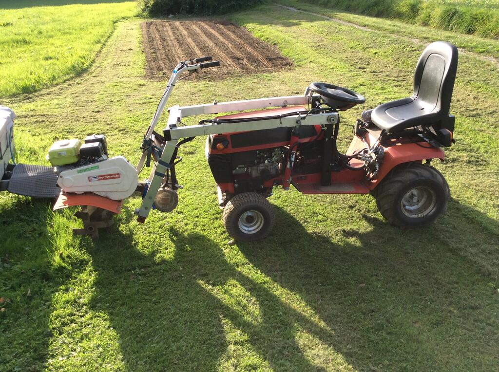

Tractorhead 9,217 #16 Posted May 31, 2020 I also fight with clay soil. I thought to mix some wood chips under the soil to loosen it up, but i learned they turn the soil to sour. A Farmer give me the advice it’s better to mix some rotten compost or humus under with the Tiller to loosen up the Soil and get it so more fluffy. If my harvest of potatoes this year is done, i will get several trailers of humus and mix it under. i tried this a bit on a edge of the field and the result is pretty good. I‘m working with a plow and later with a Walk ahead tiller, i simply mounted to the FEL. After 3 passes, the soil seems fluffy like i will have and in first times it seems it loosened the soil up good enough, but few rainy day‘s later and the clay stick back again. that is my Tiller setup self propellered and the Horse is just responsible for the movement. but i Agree with Pullstart, on clay soil, a very low speed is recommended. 2 Share this post Link to post Share on other sites

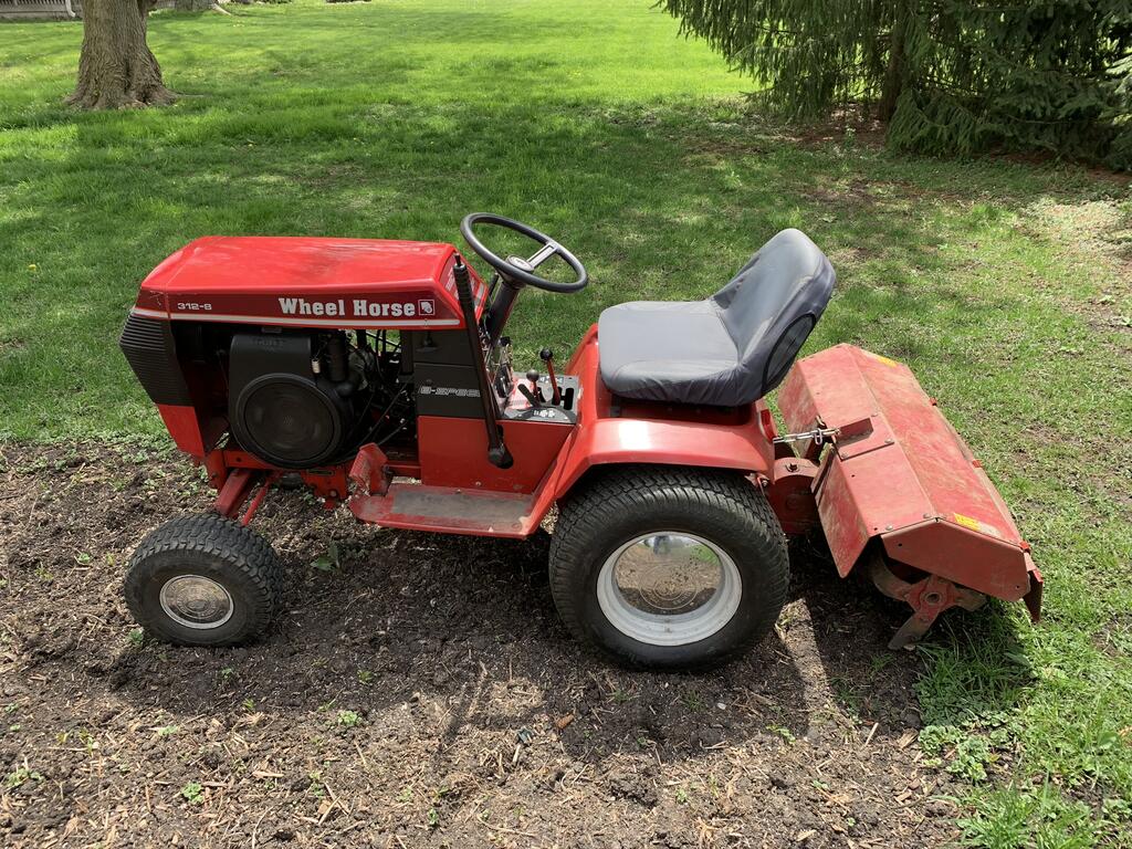

Andy N. 2,803 #17 Posted May 31, 2020 I like to use my 312-8 for tilling. IMG_0349.mp4 IMG_0350.mp4 1 Share this post Link to post Share on other sites

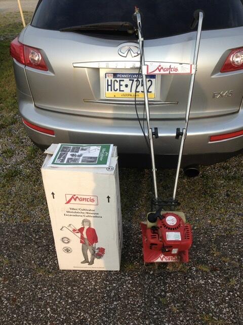

tom2p 2,394 #18 Posted May 31, 2020 (edited) 2 hours ago, pfrederi said: Considering the early TroyBilt walk behind tillers got it done with 2 or 3hp engines.... Tractor HP isn't a big limiting factor . Weight and a low range gear drive more important and a 2 or 3 hp powered tiller would be a big step up from our 'tiller' : Edited May 31, 2020 by tom2p 2 Share this post Link to post Share on other sites
