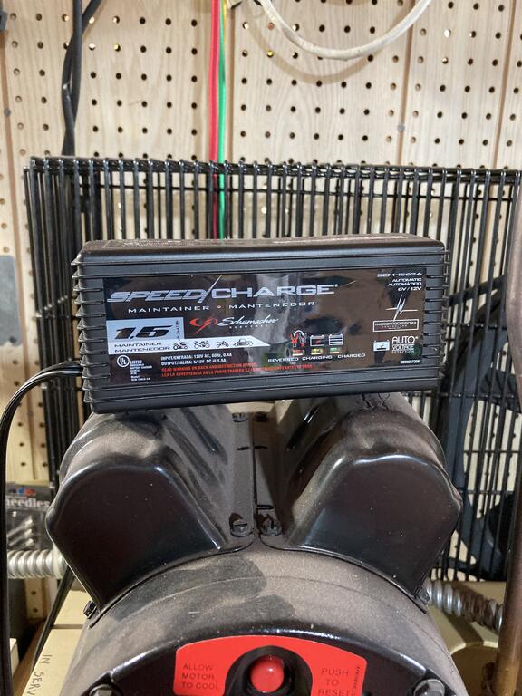

ebinmaine 81,150 #5 Posted May 28, 2020 General consensus here on this site and everywhere I've ever read seems to be that a maintainer or trickle charger is your friend. We don't use them here because we run our tractors enough all year round to keep them charged on their own. We have two tractors that we use predominantly. Cinnamon horse has a group 51r that I got out of the salvage yard for $25. I don't remember the CCA but it's 500 maybe? IF you have the older larger style battery box I would HIGHLY recommend doing that. It starts easier in all temperatures. The other one is Trina's 867. That has a group u1 from our local Small engine repair place. Low amperage. Nothing special. We buy them from him specifically because I would rather give the business to a little company than a box store. He is honest enough to tell you that it's going to last either two or three seasons if you don't put a maintainer on it. 4 or 5 if you do. 4 Share this post Link to post Share on other sites

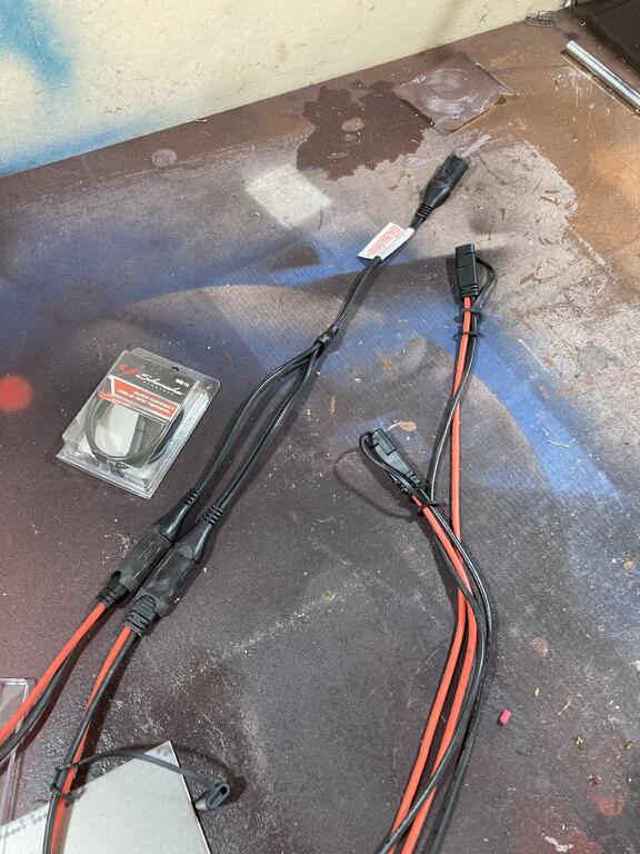

Achto 32,927 #9 Posted May 28, 2020 34 minutes ago, kasey54 said: Can a battery tender be used on more than one battery to a time? Not really the best idea. Most tenders have protections built into them to monitor 1 battery. 2 batteries fed to one tender can cause false info. They do make multi bank chargers. I have one installed in my boat, it is designed to charge and maintain 2 separate batteries. 1 Share this post Link to post Share on other sites
lynnmor 9,073 #10 Posted May 28, 2020 41 minutes ago, kasey54 said: Can a battery tender be used on more than one battery to a time? Sure, just buy the $749.95 charger and do up to 10 at a time. As above, do one at a time with a Battery Tender designed for one. I rotate my Battery Tender (I don't trust the cheap ones) and charge each battery for three days. Just because the fully charged green lamp comes on does not mean it won't take additional charge. You will get the best life keeping the batteries fully charged, discharging below 50% will reduce life considerably. I get by just fine with a monthly three day charge rotating between seven batteries. I use batteries manufactured by East Penn. 2 Share this post Link to post Share on other sites
cschannuth 3,821 #11 Posted May 28, 2020 (edited) 1 hour ago, kasey54 said: Can a battery tender be used on more than one battery to a time? it’s probably not a great idea but I have been doing it successfully for years. I maintain my batteries year round so they are never too low on charge. I suppose if you had the same tender on a battery with a full charge and on another battery with very little charge the battery that was fully charged could become overcharged until the other battery is charged which would shut off the charger. However, theoretically, if you’re using a 1.5 amp charger on two batteries you’re only feeding each battery with 3/4 of an amp and that probably won’t hurt a fully charged battery. I use a splitter that plugs directly in to my charger. Edited May 28, 2020 by cschannuth Spelling 1 Share this post Link to post Share on other sites
