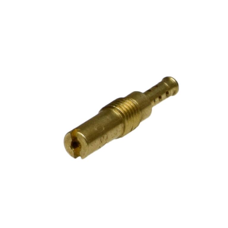

rmaynard 16,911 #26 Posted June 23, 2020 (edited) The carburetor is different than the old Kohler's I'm used to, but easy to clean. Just like the Kohler, there are places to look for trouble. One in particular is the pilot jet. It's the smaller removable jet accessed after removing the bowl. Mine was totally blocked. Cleaning it with a tiny piece of wire finally opened it up and the engine ran great afterwards. Edited June 23, 2020 by rmaynard 1 Share this post Link to post Share on other sites

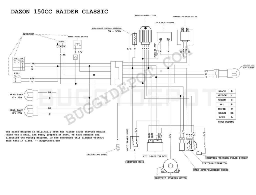

rmaynard 16,911 #37 Posted August 20, 2020 On my grandson's kart, we also had a problem with one of the engine kill switches. It was the one on the dash. The kill switches work by grounding the trigger circuit. The small connector on the back of the switch came loose and contacted ground killing the spark. Just for info purposes, here is a good wiring diagram for the DC CDI system. 2 1 Share this post Link to post Share on other sites

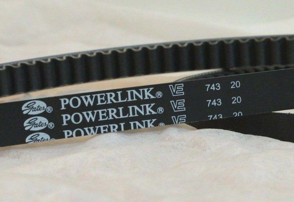

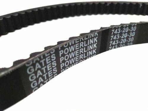

rmaynard 16,911 #39 Posted August 21, 2020 Just wanted to add something else. If you start to chew up CVT belts, DO NOT buy the cheap ones on eBay or Amazon. We have gone through at least 6 cheap belts in less than 200 miles. We replaced the last one with a genuine GATES Powerlink belt. No problem after at least 100 miles. Make sure that your belt has the Gates logo. GOOD GATES SUSPECTED FAKE GATES BELT 2 1 Share this post Link to post Share on other sites
Tractorhead 9,216 #40 Posted August 22, 2020 This AC Ignition CDI is based on just a few Wires they be required. one is the AC wire for selfpowering the CDI directly out of the Engine ( protected by a Fuse sometimes what sits in the fusebox) one is the Stop ground wire - goes to Ignition key and mostly to one or two killswitches one is the Pickup line directly from Pickup to CDI ground sometimes different handled. one is for the ignition coil and one is a fixed ground wire. At https://www.buggydepot.com you can find that Schematic, that shows nicely how simple the electrical Engine wiring is. 1 Share this post Link to post Share on other sites
