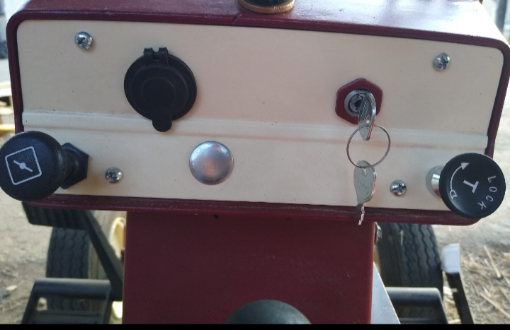

Vurge 158 #56 Posted November 5, 2020 3 hours ago, ebinmaine said: Not the norm but I could see it happening if you wire the sharp edges off the brushes from production. Research is absolutely a favorite part of my projects. How bout that choke cable? Thanks @ebinmaine here's a shot of the dash with both knobs. I think the throttle is correct design. As for the choke, I am thinking of cutting down the cable to reduce friction and then make it spring loaded. That way it'll automatically flip to "run" when you let go. What do you think? Share this post Link to post Share on other sites
ebinmaine 81,156 #57 Posted November 5, 2020 I'm fairly sure I don't have any of those black plastic head cables with the large C on them but I'd be happy to take a look. Get me a length when you can please. I've heard of others using a spring-loaded choke and from what I understand it works just fine. I've never tried it or run a machine that has it so I can't really comment one way or the other. If I don't have one of those cables and you do want to get a hold of one, pzep.biz has them for something in the $12 to $14 range shipped to your door. Share this post Link to post Share on other sites
Vurge 158 #58 Posted November 5, 2020 (edited) Thanks for the tip. I'm fairly confident I can get it to work with a spring by cutting off most of the cable housing. If it doesn't work, I'll look to get a new cable that matches the throttle. Win win? 🤣 Edit: Doh! I measured the S/G output directly and its putting out 0.7V at full throttle. Edited November 5, 2020 by Vurge 1 Share this post Link to post Share on other sites
