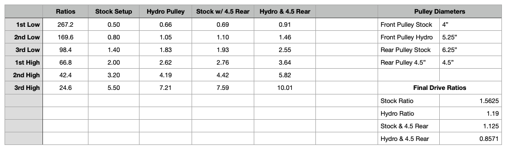

balconio 606 #14 Posted June 5, 2020 i went ahead and ordered 7" deck wheels, they had 8" ones too but i figure lets see how the 7's work first. in a way it's an upgrade to stock since these ride on ball bearings instead of a greaseable bushing. https://www.amazon.com/gp/product/B00PXM1NMY also found there's a number of online belt calculators- i like this one the most so far https://www.blocklayer.com/pulley-belteng.aspx I had myself pretty talked into the notion that i need a hydro to get the right ground speed for mowing- now i'm thinking i just need to play with the pulleys a bit. i wouldn't mind a higher final drive anyhow, to make those low range gears more useful and have a faster 3H transport gear. thanks @svt721 for getting the "gears turning" in my head on this stuff. Share this post Link to post Share on other sites

tunahead72 2,662 #19 Posted July 5, 2020 Thanks for the update! You must have read my mind, I was just looking at this thread again this morning. Make sure your engine isn't running TOO fast. Have you measured your top speed with a tach and compared it to the maximum recommended in the manual? -------- And now for reference, for anybody who's thinking about larger wheels on these decks... I've been scratching my head about larger wheels for quite a while, and finally narrowed my search down to 7" steel wheels with offset hubs and ball bearings. I definitely over-analyzed this thing, @RandyLittrell will appreciate this. I tried to order the last two Shepherd 3339 wheels from Amazon last night. Their estimated delivery date was this coming Thursday, but when I added them to my cart, that mysteriously changed to some time in August or September. If I tried to order just one, the original delivery date was still okay, but one wheel won't do me any good. This wheel is a 7"x1-1/2" steel wheel with ball bearings, ribbed tread and offset hub, and it's even red, so from a distance it looks a lot like the original Wheel Horse wheels. I haven't seen any other sources for this wheel, so... Today I ordered my second choice, the Martin 715-OF-R, from Global Industrial. It's very similar to the Shepherd 3339, except that it's white. Both these wheels are a little pricey. I really wanted the ribbed tread for some reason, but there's lots of slightly less expensive similar wheels out there with diamond tread. Here's my short list: Stens 185-017 McMaster 2331T13 Martin 715-OF Oregon 72-430 Just a final note... All of these offset wheels have hubs that are 1-3/8" long, so you'll either have to replace your shoulder bolts or add washers to your existing bolts. I need to replace mine anyway. 2 Share this post Link to post Share on other sites
