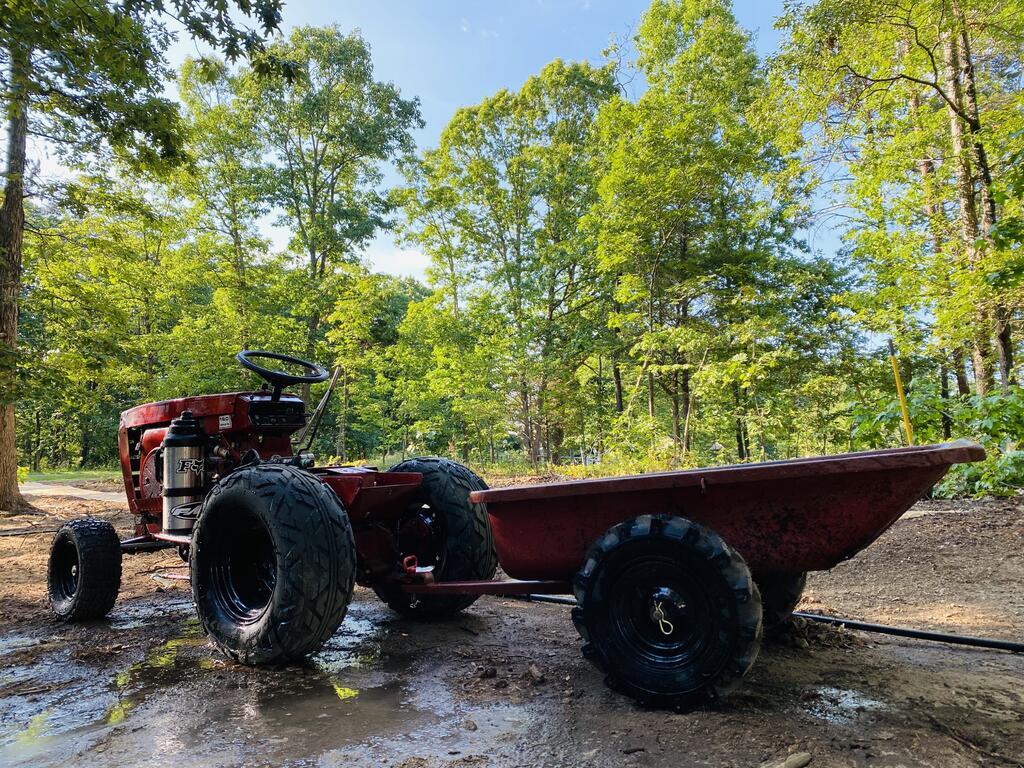

55reasons 171 #129 Posted June 13, 2020 Fabbed up some shorty clevis pins and drilled the quick hitch and levers. This made ALL the difference. Tilled a half acre of raw forest floor 6” under and only threw a belt, once, when I hit a stump on accident. I guess just that little amount of security at the hitch removed the small amount of movement at the pulleys. 3 Share this post Link to post Share on other sites

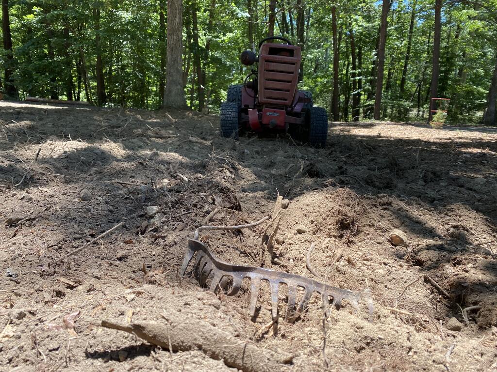

55reasons 171 #130 Posted June 13, 2020 Even chewed up a rake that was below grade and spit it out like bubble gum and kept going. Didn’t even notice it until the next pass. lol. 1 2 1 Share this post Link to post Share on other sites

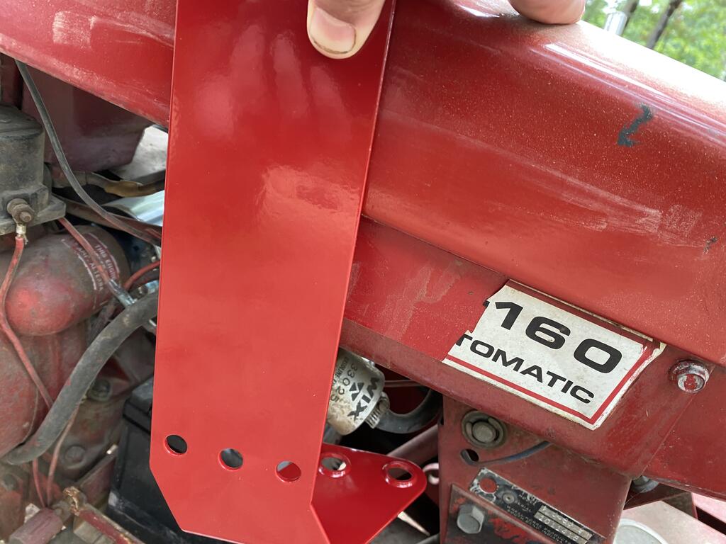

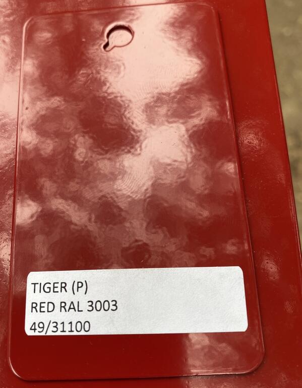

55reasons 171 #140 Posted June 15, 2020 I don’t know if this will help, but I picked up the seat parts this AM, and the RAL 3003 color matches pretty well for a coded powder. I’m pretty sure this will be the basis for the restoration when I do it. The RAL code is an easy reference number to perfectly match paint to as well. Here is a shot of the powder coated piece in an area that shows: 1. The hood is Rustoleum Royal Red 2. The cowl has both shades of red. You see the original shade under where the C-160 sticker was, as well as the pink-purple hue is has taken on over 40yrs outside. I think this color looks perfect to be honest. 1 2 Share this post Link to post Share on other sites

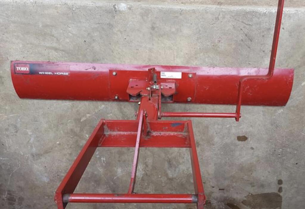

55reasons 171 #145 Posted June 15, 2020 Will this fit on my C-160 Auto? Share this post Link to post Share on other sites
ebinmaine 81,048 #146 Posted June 15, 2020 3 minutes ago, 55reasons said: Will this fit on my C-160 Auto? You have to check the model number to be positive but it looks like one that would. I don't know if there are larger model tractors that have similar appearing greater blades that don't fit a C Series. That would mount to the rear axle and push the dirt from there. The other style of mid-mount grader blade mounts in the front and drags or pulls the dirt. 1 Share this post Link to post Share on other sites
55reasons 171 #147 Posted June 15, 2020 43 minutes ago, ebinmaine said: You have to check the model number to be positive but it looks like one that would. I don't know if there are larger model tractors that have similar appearing greater blades that don't fit a C Series. That would mount to the rear axle and push the dirt from there. The other style of mid-mount grader blade mounts in the front and drags or pulls the dirt. It’s a 79356, and I’m having a hard time finding the attachment interchange chart on this site. Lol. Share this post Link to post Share on other sites
55reasons 171 #148 Posted June 15, 2020 (edited) ...and $400. ? seems steep, but it’s local, so at least I won’t have to drive 16 hours again for an attachment. (Again) Edited June 15, 2020 by 55reasons 1 Share this post Link to post Share on other sites
55reasons 171 #149 Posted June 15, 2020 according to the attachment list NO 50” grader blade attaches to this C-160. 🤦♂️ Share this post Link to post Share on other sites
gwest_ca-(File Mod) 12,522 #150 Posted June 15, 2020 It will fit if you move the rear bar ahead 5". I cut it out and left the the longer frame there. Drilled new holes and use a loose crossbar. Garry 1 1 1 Share this post Link to post Share on other sites
