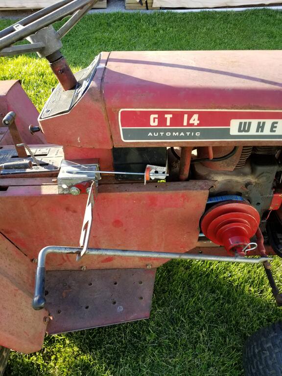

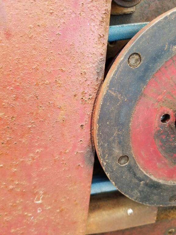

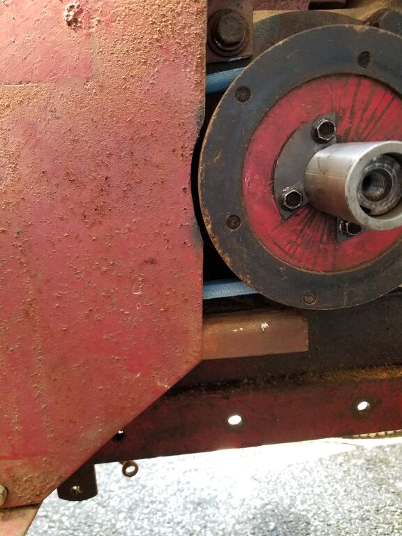

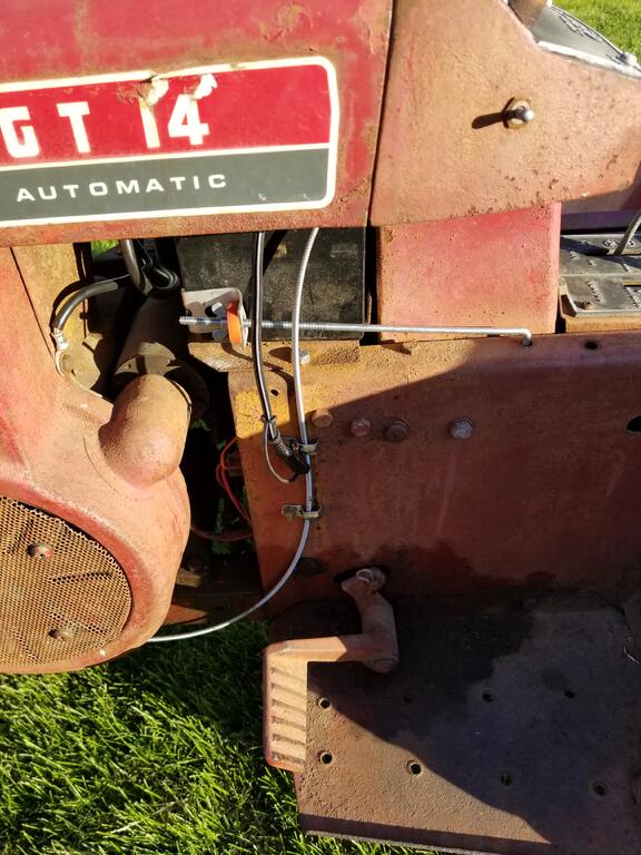

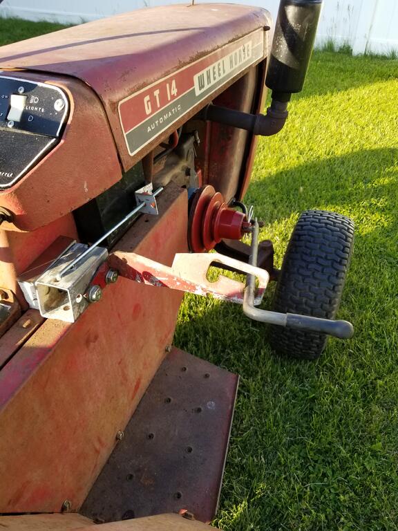

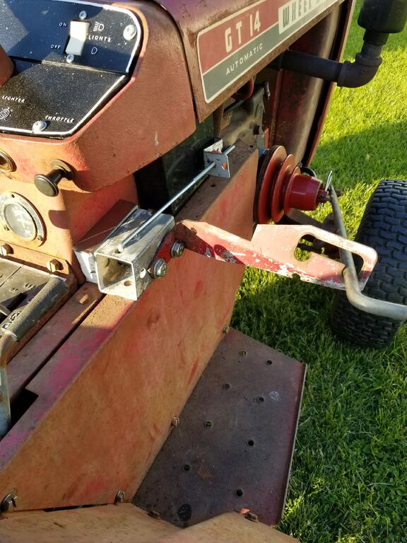

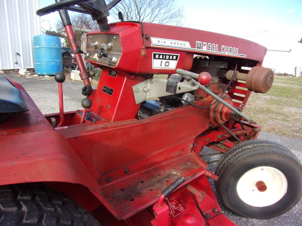

cafoose 3,883 #1 Posted May 14, 2020 Here is the finished project @WildmanC120 I'm finally finished with converting my GT-14 from electric PTO to manual PTO. It looks like a rig job but it's functional. At some point in the future I may redo the mounting of the bracket. I had to space it out three inches from the hood stand. I had to trim the belt guard a little bit with my angle grinder and get a drive belt that's two inches shorter. It calls for an 85 x 5/8 belt but the pulley I had to use with the PTO is smaller so I went with an 83 x 5/8 belt. I don't notice much if any difference in ground speed. I also fabricated a battery hold down bracket. Here is my previous thread on this project: 3 1 Share this post Link to post Share on other sites
Ed Kennell 47,824 #2 Posted May 14, 2020 I see your bracket does not have the clutch calibration notch between the on/off notches. I thought they all had this. What tractor Is your bracket from? Share this post Link to post Share on other sites
cafoose 3,883 #3 Posted May 14, 2020 1 hour ago, Ed Kennell said: What tractor Is your bracket from? Not sure Ed I got the parts at the Big Show a year or so ago. I may look for a calibration bracket in the future. Do you have any laying around? Share this post Link to post Share on other sites
Ed Kennell 47,824 #4 Posted May 14, 2020 8 hours ago, cafoose said: Not sure Ed I got the parts at the Big Show a year or so ago. I may look for a calibration bracket in the future. Do you have any laying around? None in stock Chuck, but I am always looking. BTW, nice conversion. IMO, this was WH's best PTO design. No wires, no switches, and no moving parts. 2 1 Share this post Link to post Share on other sites
cafoose 3,883 #5 Posted May 14, 2020 1 hour ago, Ed Kennell said: BTW, nice conversion. IMO, this was WH's best PTO design. No wires, no switches, and no moving parts. Thanks Ed that makes me glad I chose that PTO design. I believe it's period correct for my GT-14 too I would still like a calibration bracket though. Share this post Link to post Share on other sites
edgro 680 #6 Posted May 14, 2020 My raider 14 also has the same bracket as shown on the gt14, no center notch 1 Share this post Link to post Share on other sites

cafoose 3,883 #12 Posted May 15, 2020 You're welcome Randy. I just ran across this post I put in and it lists the parts I used from the Raider which I believe is a manual shift and what I'm seeing is 8hp may have a smaller crankshaft but 10-12-14 are the same referring to different part numbers shown for the 14-54 bearing race. It looks like pretty much everything else is the same and I believe Raiders came with both Techy and Kohler: 1 Share this post Link to post Share on other sites
Ed Kennell 47,824 #13 Posted May 15, 2020 Yeah, my Raider 10 has a HH110 and an 8 speed. 1 Share this post Link to post Share on other sites
